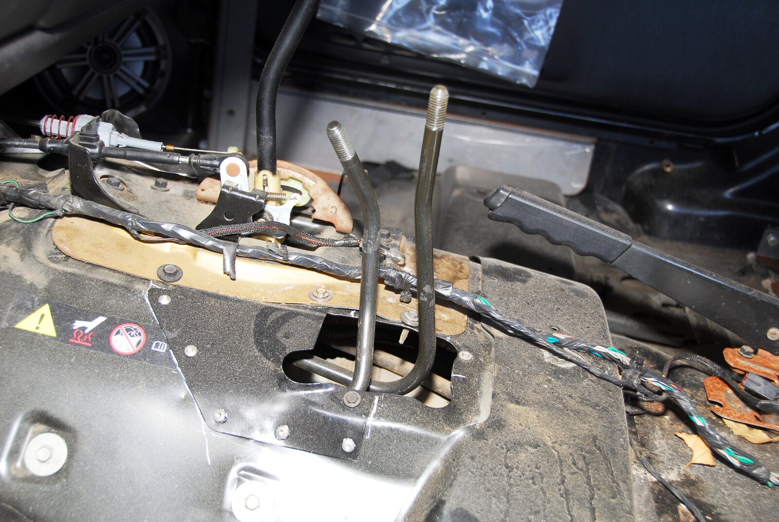

What shifters did you go with? I'm wanting levers, not cable style, and I think I may have to make my own. I want it down and behind, so I can just reach down, not forward at all.
I went with the universal TJ kit, I'll take a pic of the ZJ shifters when they get here maybe they could work for you
I want levers too but need to figure out how to seal the tub up from water.

I asked Advanced about the shifters when I placed my order. Orren told me the "97-02 Auto" kit works well on all TJ configurations (trans, TT, etc.) for the 2-speed. I didn't have any trouble. In fact, I thought shifter layout and link adjustment was the easiest part of the install, aside from having to climb up and down to get into the cab with the Jeep on a 2-post.
I had to cut my tub a little to accommodate the shift tower. I put in some new sheet metal that I put rtv under so it acts like a gasket. The provided boots went over that and I covered it all up with a bunch of duct tape over the top for good measure. It's been working we for me so far.
