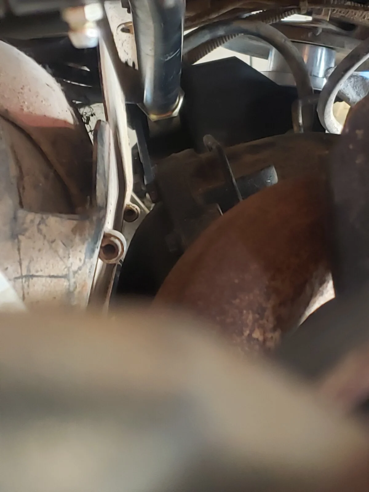

This is mine (currie) post Savvy tt at full stuff. Yours may differ. I ended up using the existing tb mount bracket installed by the po because it worked but did not have as much forward angle to it as the currie bracket has. I'll probably install the currie bracket at some point as its resting on the shelf, but for now this works. I have seen several instances where those with the jks have had interferences.
... I have seen several instances where those with the jks have had interferences...
are you saying just the JKS trackbar has problems ,just the bracket, or both because I have the jks bracket and trackbar
I can't say that it (jks) has problems but in my research and several installs I can say that the bends in the Currie bar/ bar relocation bracket combo have seemed to give more room there.
