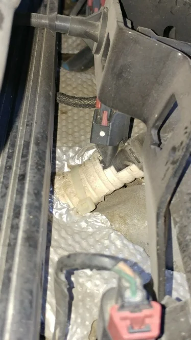

Cut quick to the point, I’ve got a misfire on cylinder 3. What I’ve done.
Checked for vacuum leaks: none
Heat shielded injectors: all of them
Checked compression: within spec on all 6
Checked fuel pressure :within spec
New fuel pump
O2 sensors: all 4 new
New plugs
New coil
New cam synchronizer and OPDA
New crank sensor
New thermostat and water pump
New fuel injector connectors
New maf sensor
New IAC valve
New throttle position sensor
New intake air temp sensor
New entire evap system
New vacuum lines
Checked all wires running behind valve cover for cuts and grounding problems
I’m at my wits end.
This was my life not too long ago. May the force be with you.
If it helps, I replaced my injectors and fixed the issue. Word to wise, don’t get cheap ones. Everyone on here will tell you to get Bosch 4 hole. Easier said than done to get your hands on them. TONS of fake ones online so tread carefully.
