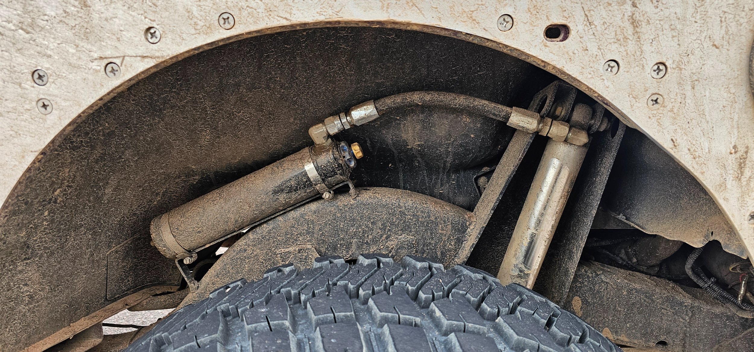

@NashvilleTJ had a question earlier about tire rubbing on the larger DSC reservoirs. Yes there is rubbing, but not enough for me to care about.
It's tough to tell from the pic but the passenger side does look like the tire contacted the fittings. If the hose can flex enough, a small turn to the inside may resolve that. The body of the reservoir isn't too concerning but if the tire contacts those fittings at the right torque & angle...
Again, could be the pick. Just look like some shine on the very edge of those fittings.
If the tire touches the fittings, it is just enough to knock the grime off.
Reactions: FarFire70
Well, it depends. In my experience things move a good bit past their hard stops during hard hits. If you’re touching during mild flexing - as it looked like in your pics - it will contact much deeper on a hard hit.
Just something to keep in mind. The rig looks great.
