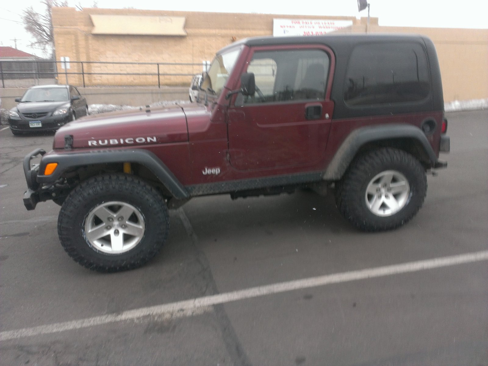

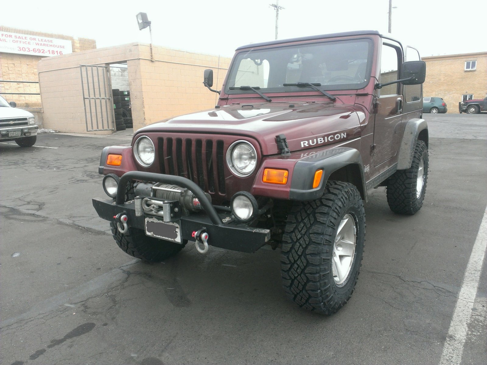

There technically isn't enough room, but here came a set of five 285/75/r16 Goodyear Duratracs.
View attachment 34120 View attachment 34119
Here they are in the Discount Tire parking lot at a teeth rattling 35psi.
