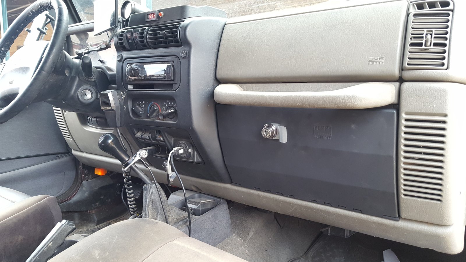

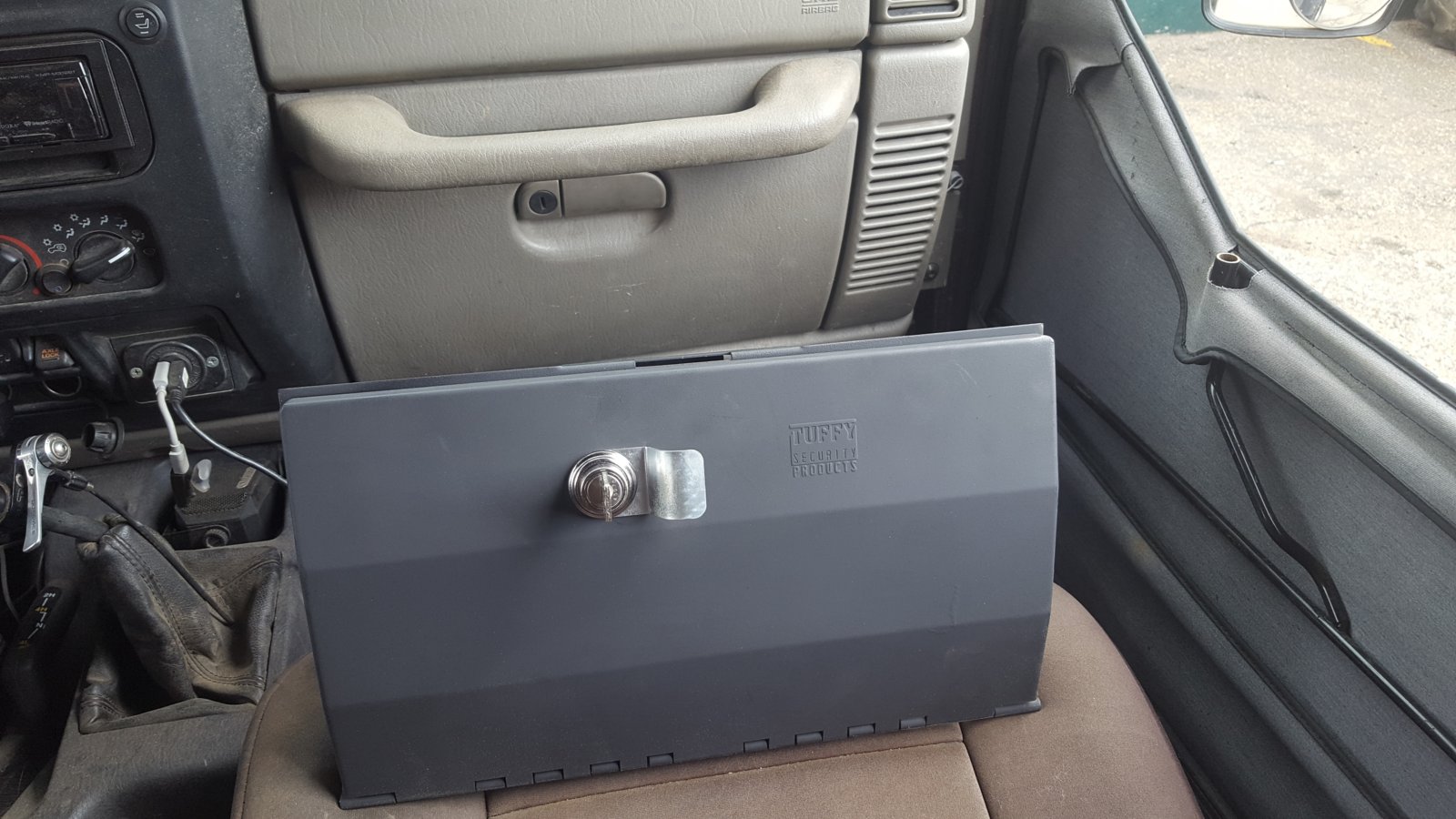

Bought a Tuffy glove box from CL.

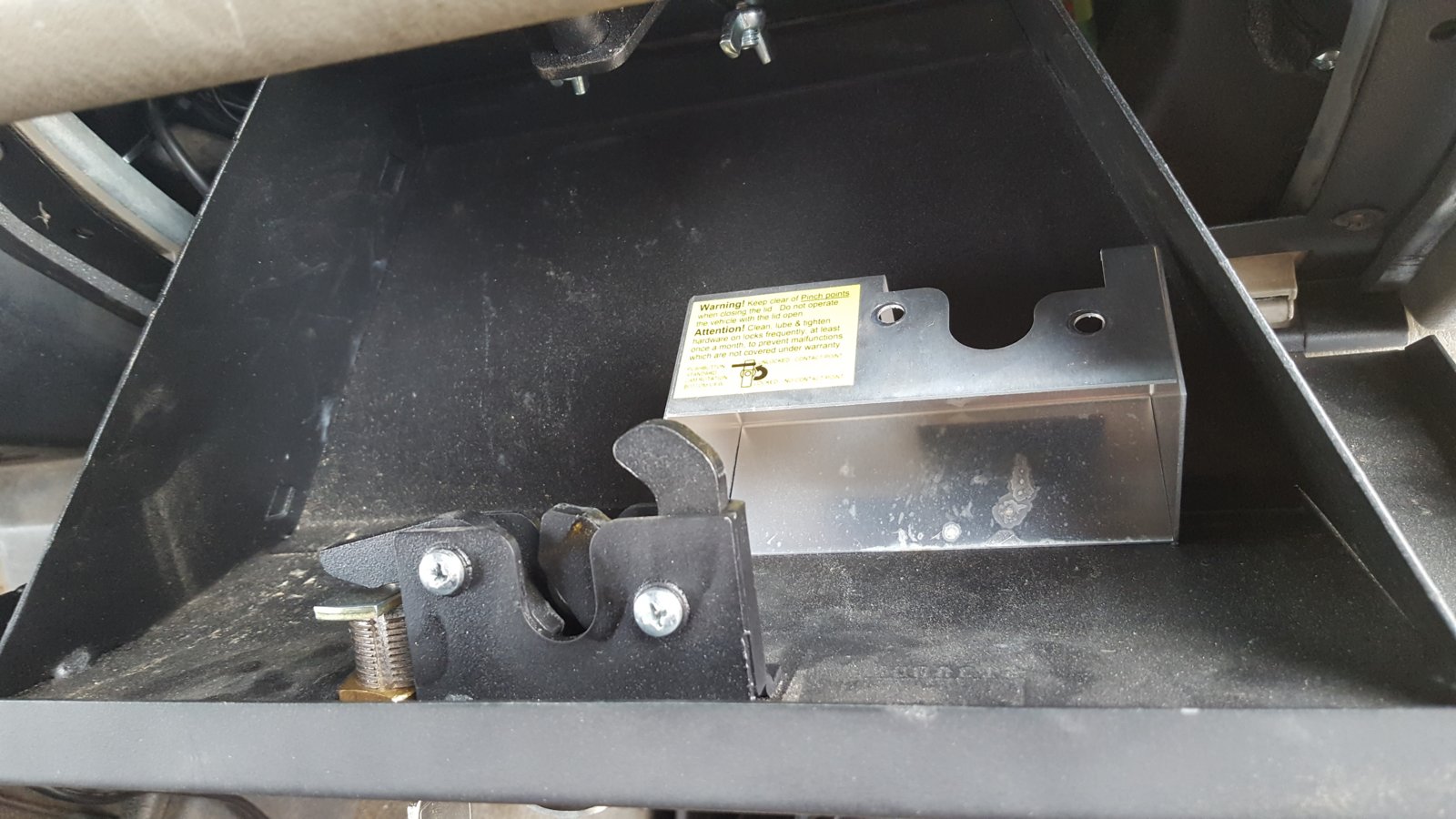

For some reason, despite being larger than the factory glove box, Tuffy managed to make its version useless.
All of that fit fine before.
The problem is this silly aluminum guard. I don't know why it is here.
So I removed it.
Now everything fits inside again.
Then I used this pic of the fuse diagram to make a laminated copy and keep in the Tuffy box.

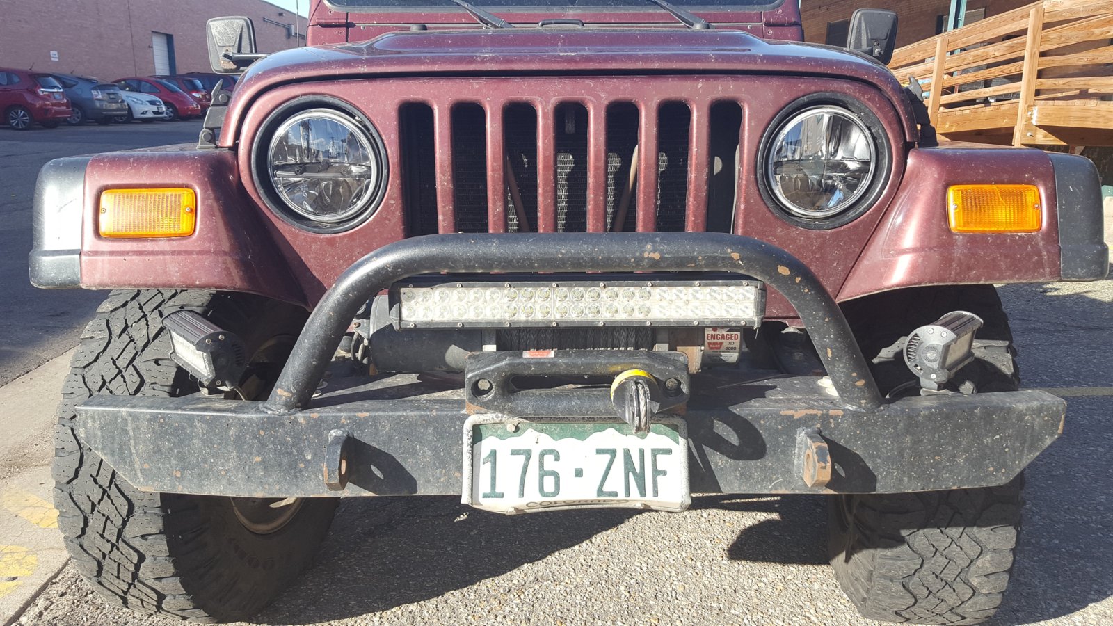

Used Truck-Lite LED headlights from CL.
I also added black headlight bezels for the goth/Hot Topic look.
Here is how much thicker the TLs are compared to the Hella Vision+ lights I had before.
Overall, these are significantly better than halogens. Much brighter and further reach. Though I do miss the warmer color of the old lights.

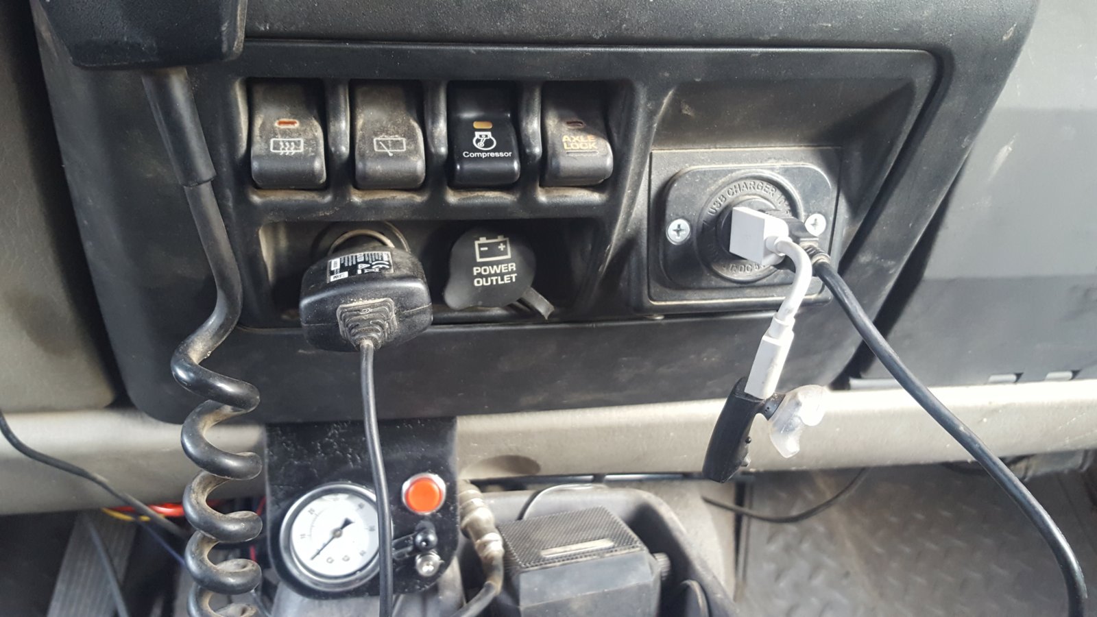

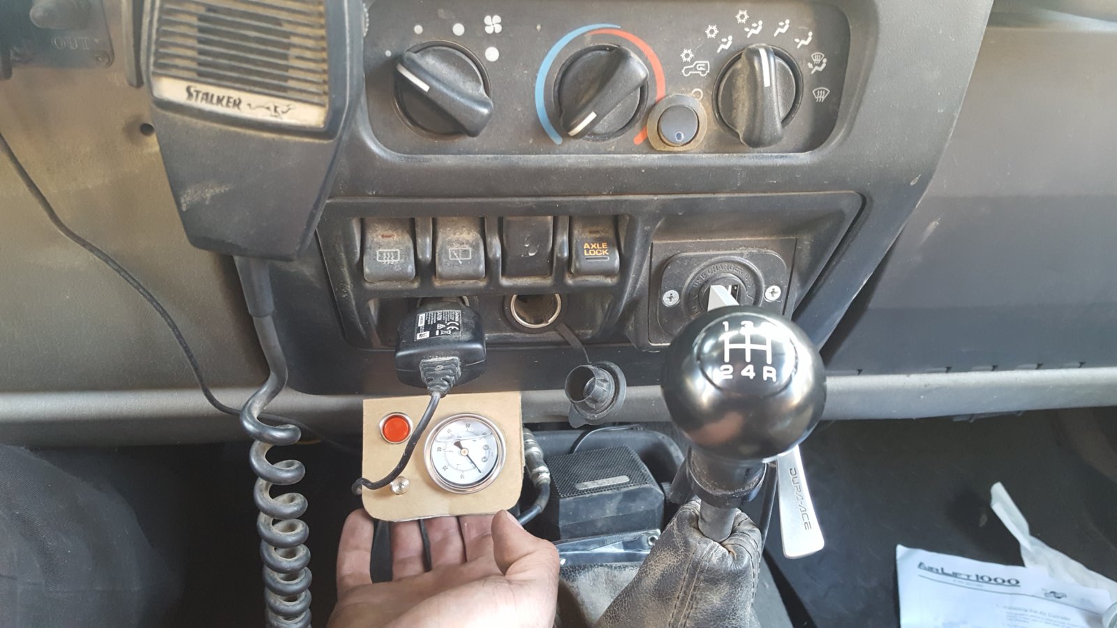

This will be the switch panel for my rear air bags. Just a simple solenoid fill valve and a bleed valve.
The back side.
0-60psi gauge. Red button is the fill switch that will be connected to a solenoid valve. Shiny button below is the bleed valve. The piece in the middle is to hold the bleed valve open. The idea is so that the bags don't restrict or slow up travel when not in use. Running these bags empty is against the manufacturer's recommendation. The concern is over chafing. I don't see that happening on my installation. We will see what happens.
Also, notice the dash switch for the York. No more blank spots!
Reactions: derekmac

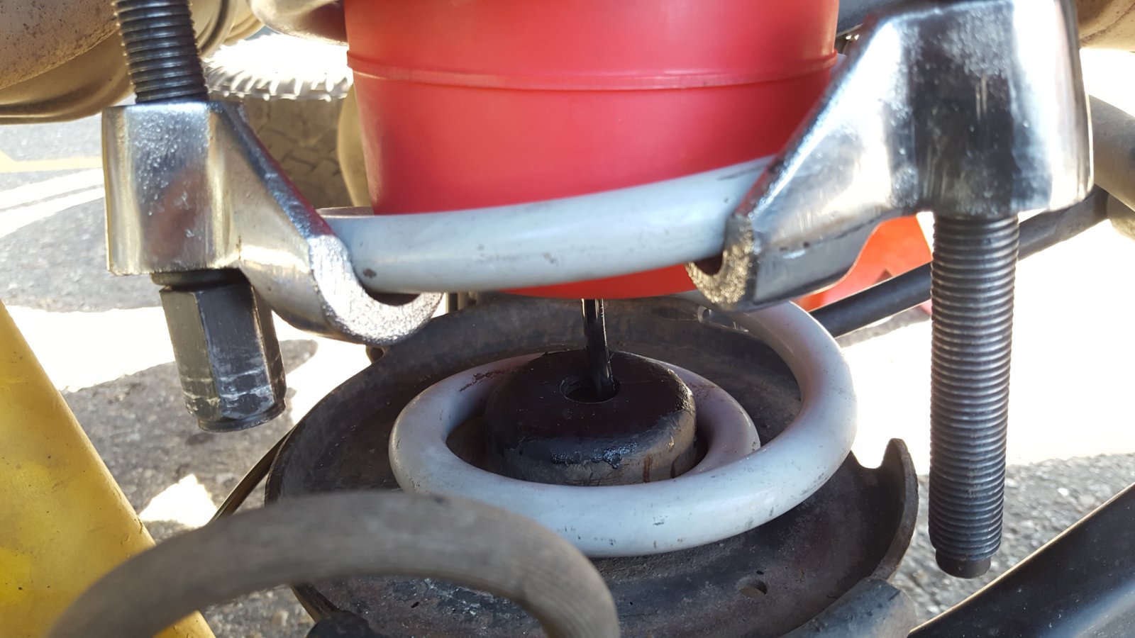

Here are the rear AirLift load support bags. Part of my exploration with springs is to find the longest and lightest springs that will provide the ride height I am after. Currie springs are soft and will sag with passengers or camping gear. Rather than use a higher spring rate, I decided I would rather add the bags.
Drill a hole in the lower spring seat for the supply line.
Stuff the bag into the coil and connect the supply line.
The bags are teed together near the diff. The main supply line runs up to solenoid valve on the York manifold.
With the axle hanging...
When you call AirLift, they will try to sell you bags based on stock suspension travels. They also want you to remove the jounce bumper. I disagree with this. The first bags were way too small for my setup. During the process of returning them, I was able to find bags the fit the inner diameter of the Currie springs and were tall enough when empty to fill the space between the lower spring seat and the bottom of the jounce. Now when I begin to fill the bags they are providing support immediately, but whith no more pressure than is needed. And as mentioned above, I run the bags empty when not in use with the bleed valve open. I did this because i did not want the bags to influence the suspension travel when not in use. Because i selected bags that fit inside the spring when empty, they don't flop around or chafe.

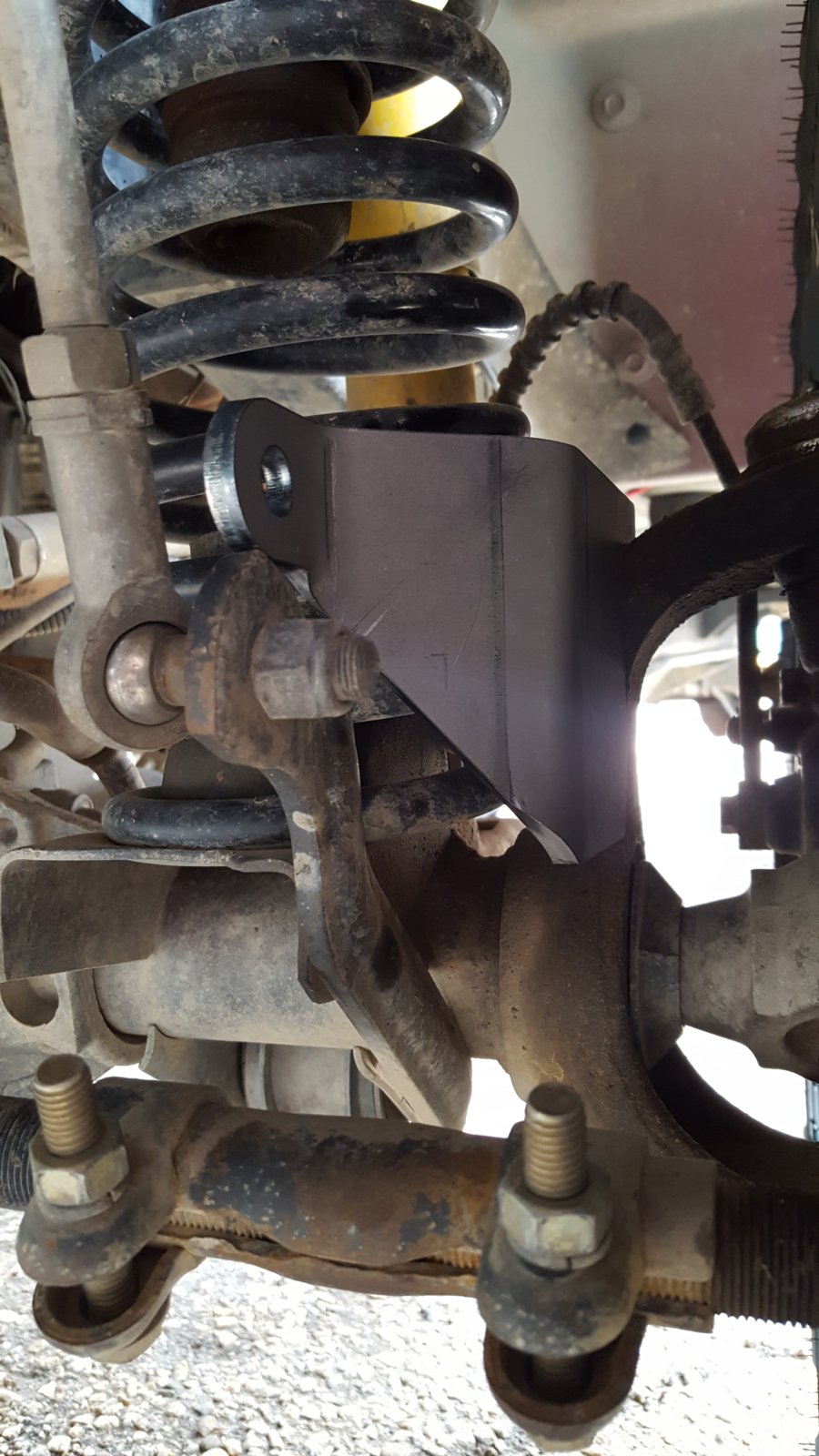

Raised my sway bar axle mounts using a pair of Black Magic Brakes' relocation brackets.
http://www.shop.blackmagicbrakes.co...rackets-and-Gussets-SWAYBAR-LINK-BRACKETS.htm
The new brackets sit right above the old.
Clamp a piece of flat steel across the bolt holes to maintain the correct alignment.
Weld it on. Paint it.
Cut off the factory mount.
My main motivation is that the tie rod end on the drag link will hit the factory sway bar mount at full droop and full passenger steering lock. This bothered me.
Now it won't on those very rare occasions when the front end is hanging.
Perhaps more importantly, this also paves the way to flip the driver's side tie rod end.
Reactions: JMT and derekmac
