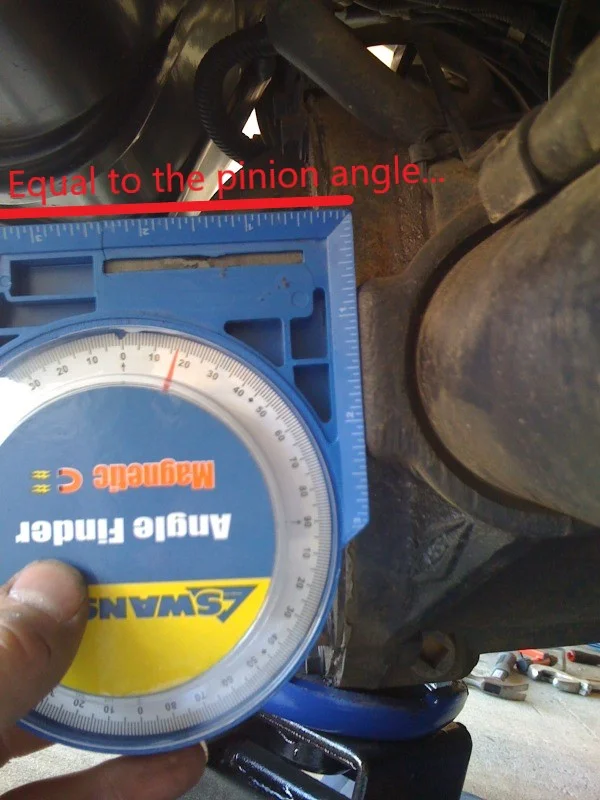

I read a little on Tom woods page and from what I gathered the angle between the pinion and drive shaft does not need to match exactly In order for the pins inside the U joints to spin properly. So I’m guessing a 1 to 1.5 deg od difference is good. Did I read that right ?
