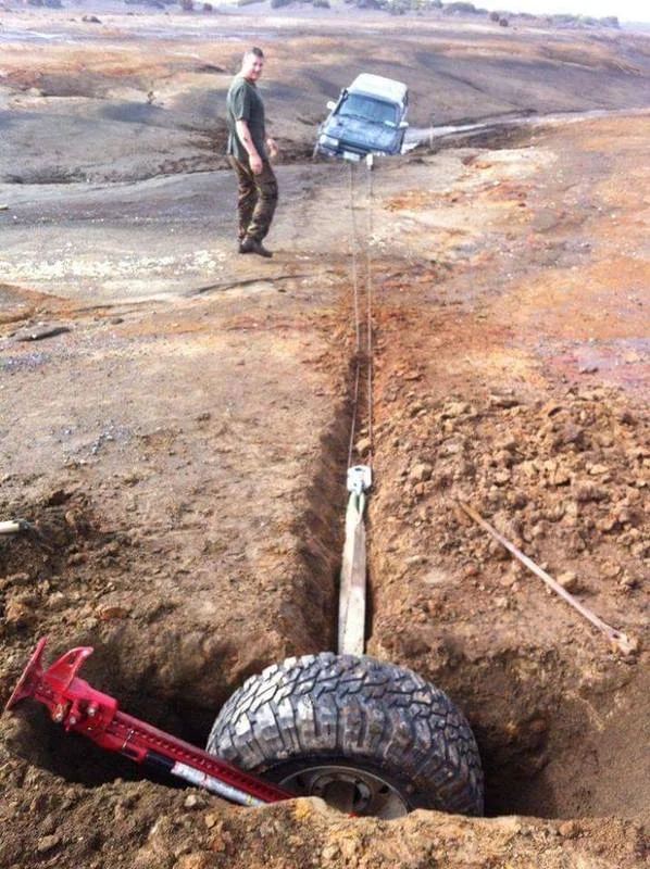

I have recovered a lot of equipment back when I was in the recovery section of a old unit. Since I have become a SFC in the military I no longer recover vehicles/tracks. What I have learned through trial and error is that in the most direst of times when you are gifted enough to go wheeling ALONE, is that your spare tire is a GOD send when you get stuck. I have since then seen several people post pictures of recovery that way. all you have to do is dig a trench wide enough to place your spare in the ground and then wrap your recovery strap through the center and back to itself. place the strap on the bottom of the tire and place in the ground and slowly recover your self.
If you happen to need it in the rocks you could simply use the rocks and wedge the spare between the rocks, imagination is limitless.....

Thanks for this. I'm getting ready to go to the beach next week for a couple of days, and will be on some 4x4 beach alone. There could be other 4WD's, but I thought a deadman would be something to have along. Nice to know that as long as I can get my spare together this week, I'll be good to go. I had been thinking of cutting down a T-Post to about 4ft, attaching my strap to the base, and burying it at a 15* angle away from the Jeep's position, but this looks like it would work better. Little more digging, perhaps

Since space is so limited in my TJ, even with the big Tuffy storage drawer I installed, that I evaluate risk/reward on the space I invest to carry gadgets. If space was unlimited I might consider one of these but as stated above I've always planned to burry my spare if I did get in a situation like this. As cool as it looks I would not spend the space for it plus the price seems really high to me.
