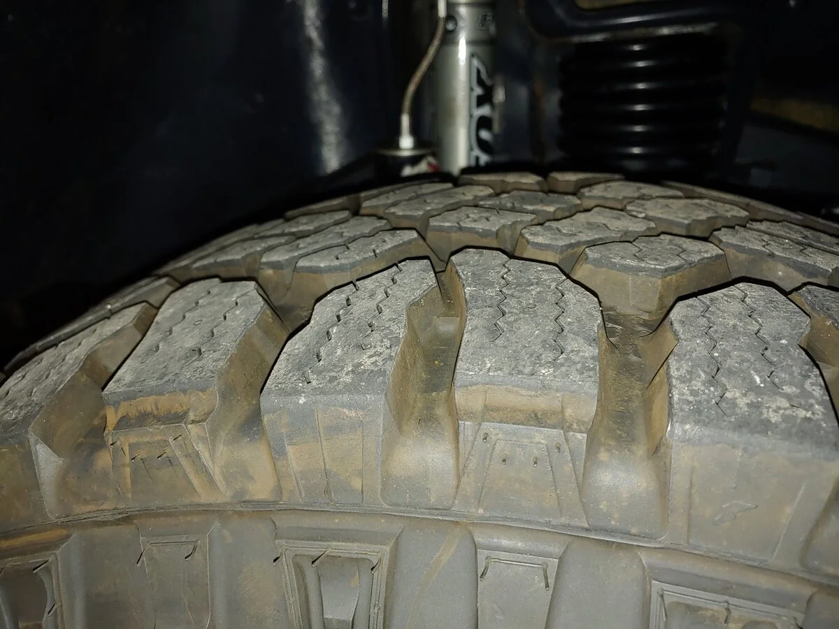

What kind of shape are your front tires in and when is the last time you had them balanced?
They have less than 5,000 miles on them. And when I first experienced the DW, I switched the front with the rear. I just had them rebalance yesterday.
