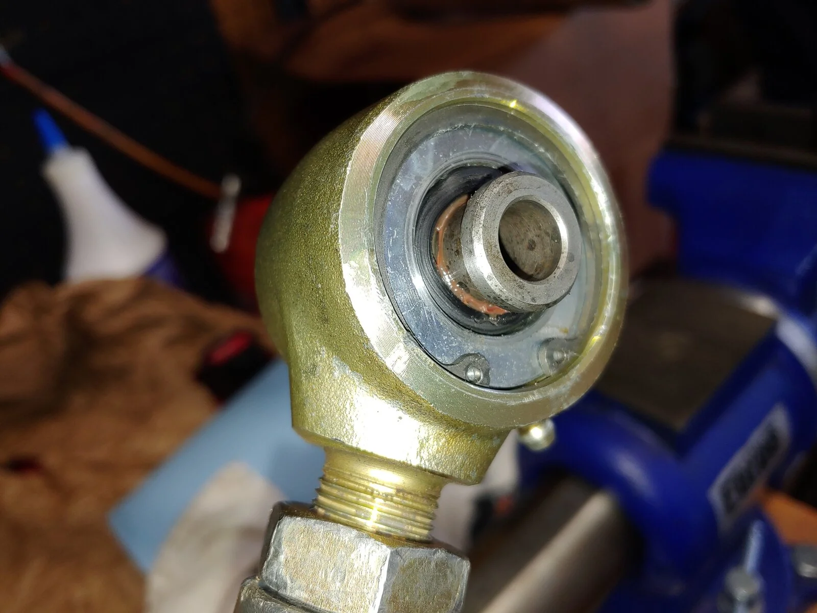

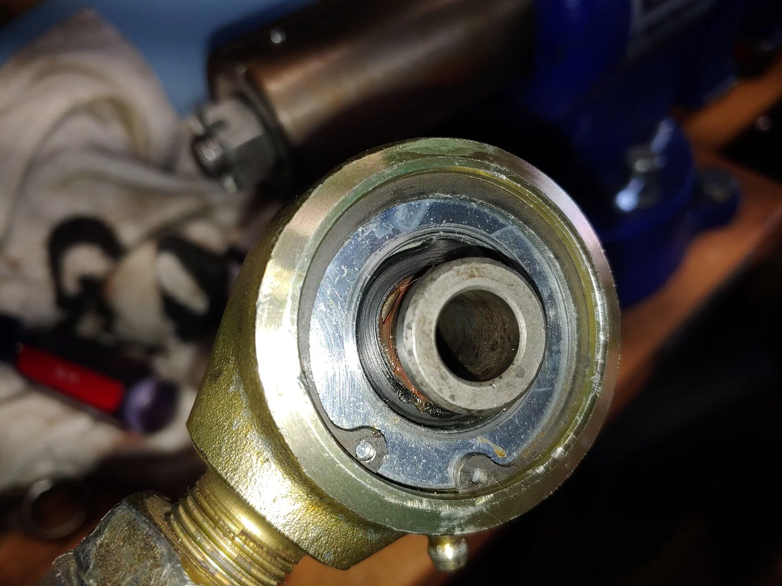

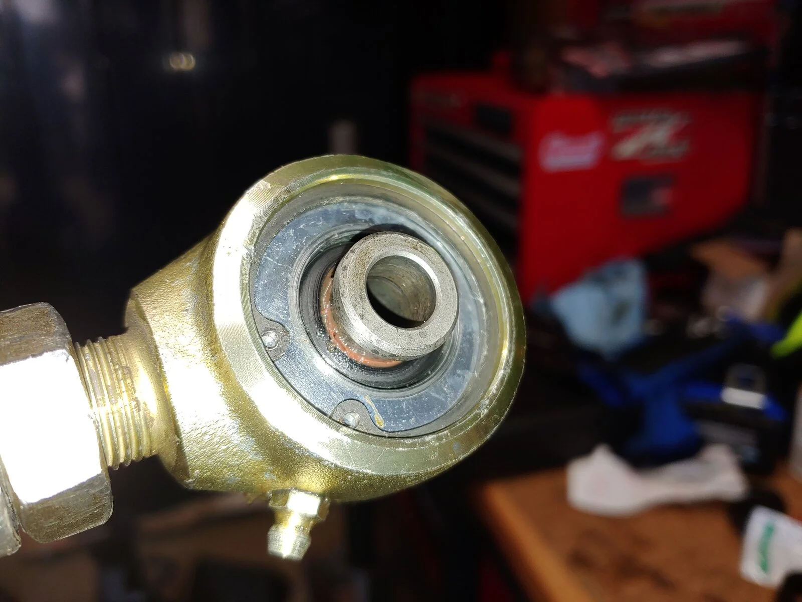

Well, that was a half a step backwards. It also looks like the shim is distorting the race. Taking the arms back out and removing the shims from the frame side joints.
on a freshly greased JJ, it should move relatively freely. After a week or two you might need a wrench to turn the arms.
All my JJs do move freely when I regrease and rebuild them. However, the upper fronts I have .04" shims on either side to increase the preload in a test on the DW I'm trying to diagnose. With the shims they have so much preload that they are difficult to move. I am removing the shims from the frame side upper joints as it took me a step back from the success I had shimming the axle side JJs. With only the axle side JJs shimmed, there was no DW, only a brief shimmy when hitting a specific bump that always triggered the DW.
