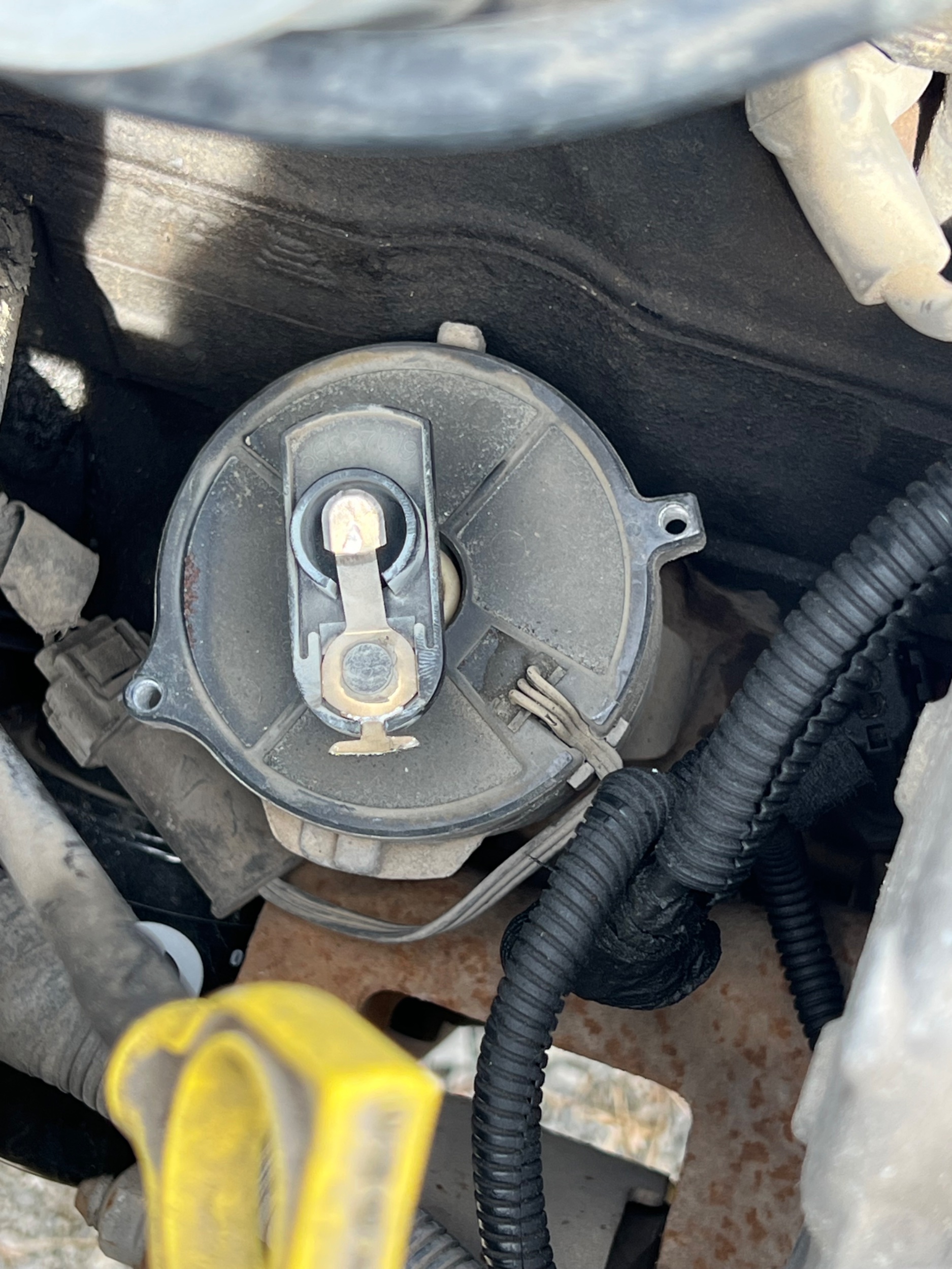

So I’m still tracking things down and now I’m checking the distributor. Can anyone tell me if the rotor should be easy to remove? It turns upon cranking but it will not come off. In videos I’ve watched it appears that it should easily pull right off.
You can pull up the FSM for it under Resources.
On a 4.0, no spark is usually the crank sensor. Also, the cam sensor is used to time the injectors. On the newer models, the PCM will just switch to batch firing them. But on the old ones, a bad cam sensor results in no pulsing. I think the 4 cyl works the same on the older ones.

For anyone still following, she’s up and running now and it appears the fuel pump was the problem. Here’s the theory: the first time it stalled out, that was an intermittent failure of the pump.
Since the fuel pressure was good, pump was priming and she started right up the next day, I assuming the pump was not the culprit.
The next failure was the final failure. Crank but no start from then on after the second stall out. I recruited some help and we checked for spark, checked relays, and decided to check fuel pressure again and it was now zero.
I went with a Delphi pump, and followed a good write up from Vasq on how to drop the tank and she now runs.
Here’s to hoping that was the only problem. I now have a back up crankshaft position sensor and distributed rotor.
