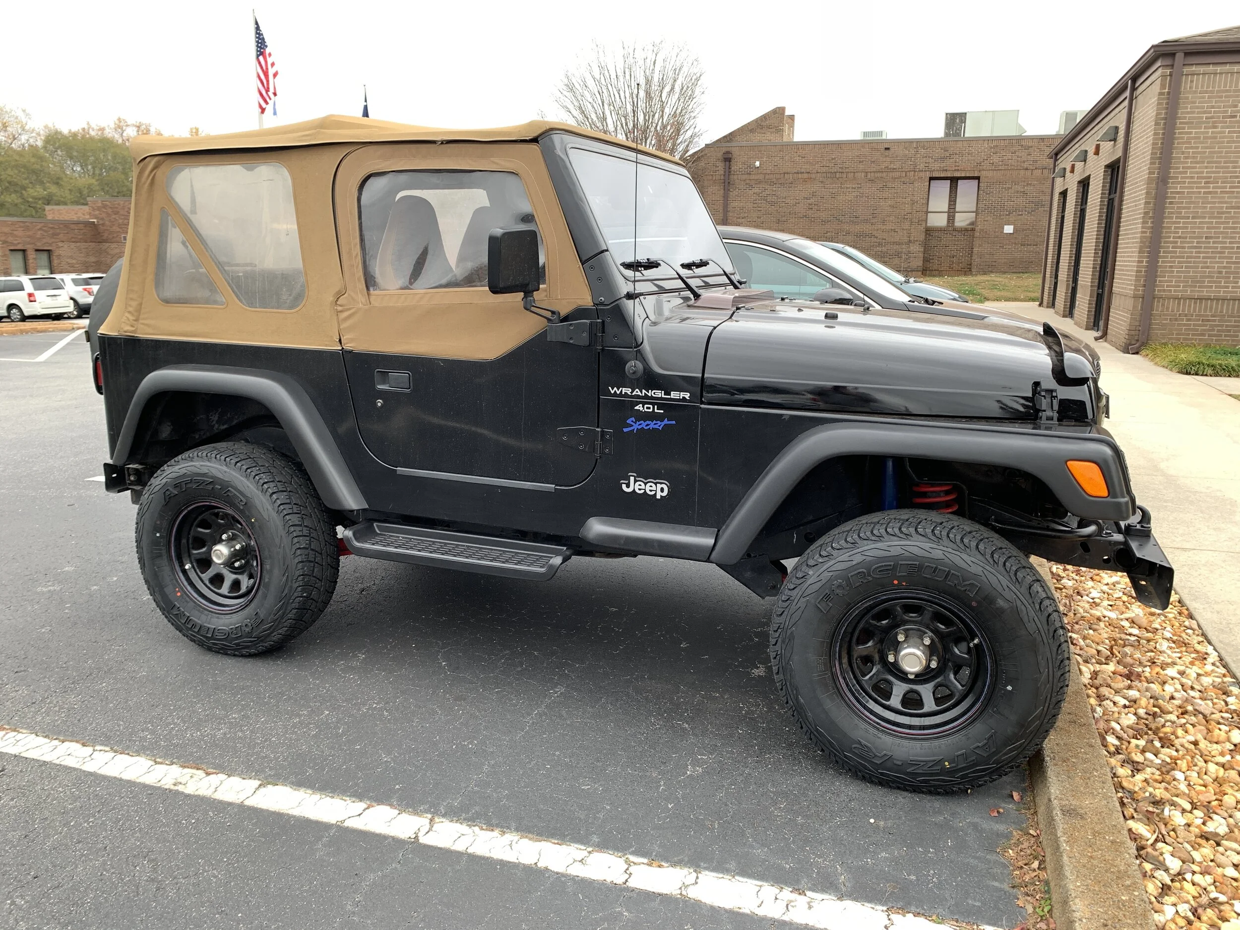

I am wanting to drop my 97 TJ back down to roughly stock height. When I bought it it had a 2" body lift and a 2" coil lift. I would like to put some stock spring on it. I found someone nearby that has stock coils off a 2003 Rubicon. Would they work for my 97 Sport and what can I expect? I am a new Jeep owner and I am learning. When I first got it had 33's on it and I went to 31's so I have a considerable amount of open wheel well. I will leave the body lift because it isn't a job I am ready to tackle. Springs do not seem quite as difficult to change. Advice? Words of wisdom?

I am not sure what shocks they put on it. The last owner had shocks put on it but I don’t have any details. I am going to take some measurements and see what the actual lift is over stock. The lower arms are aftermarket but seem fixed length. The uppers look to be stock.
