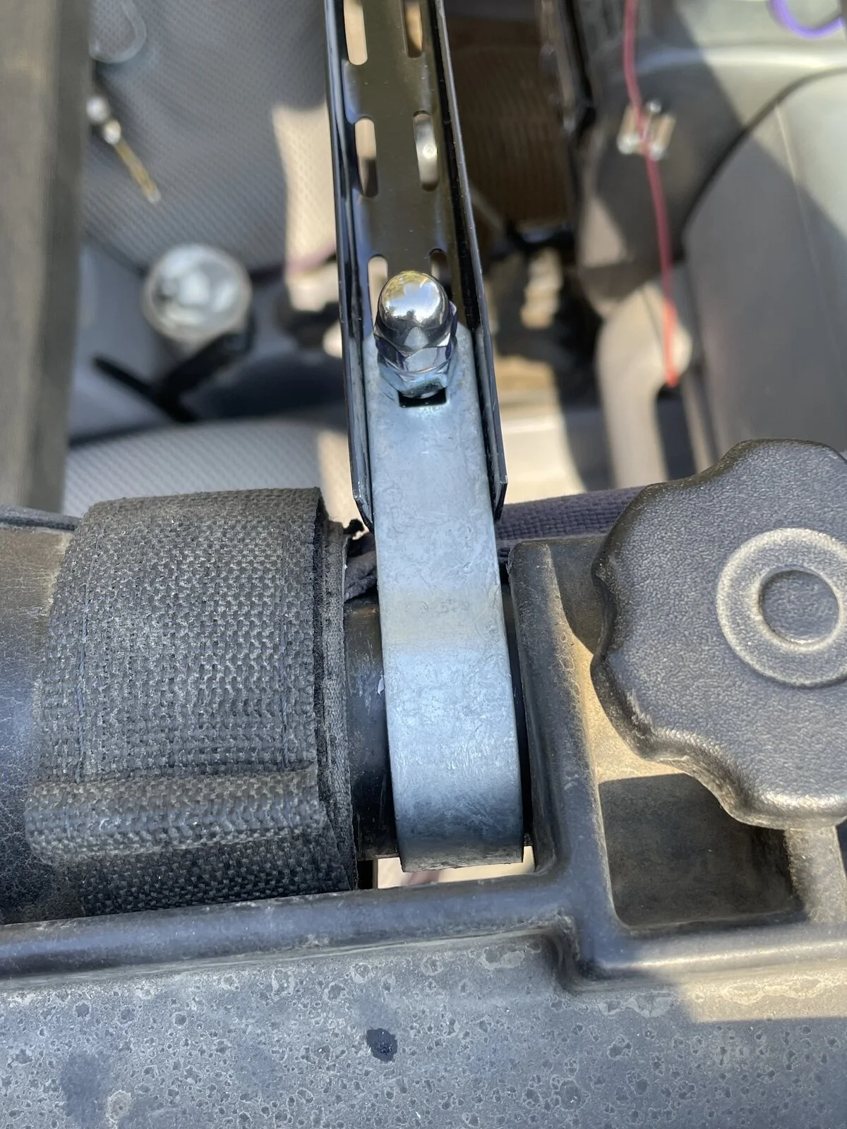

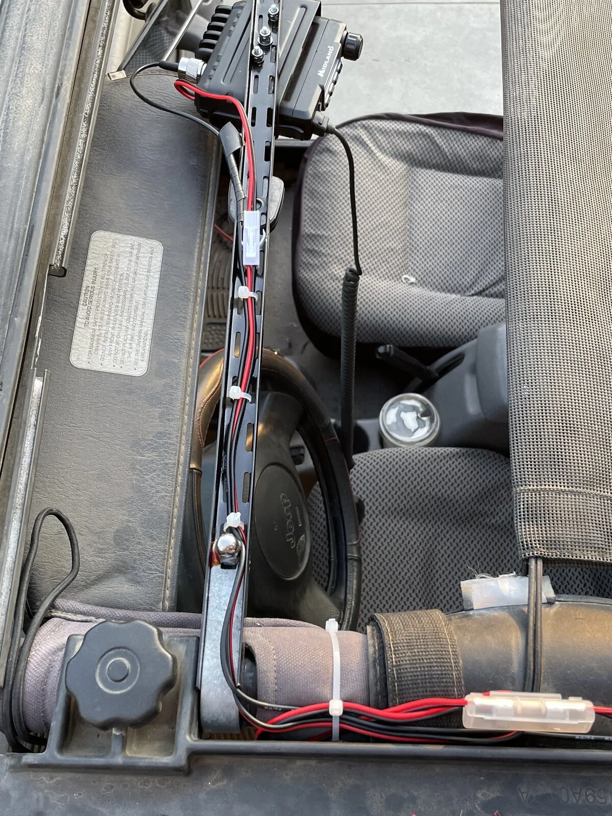

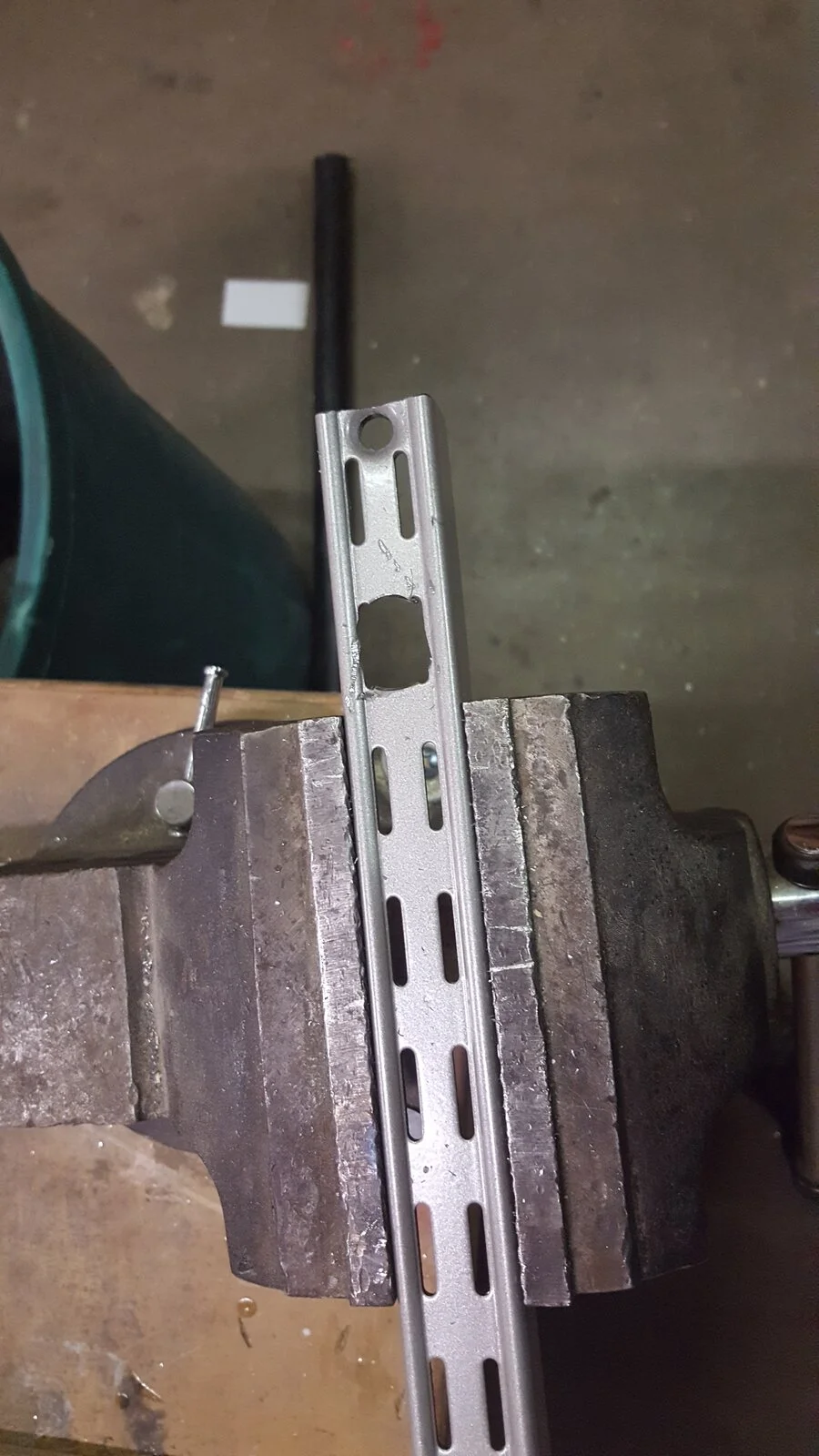

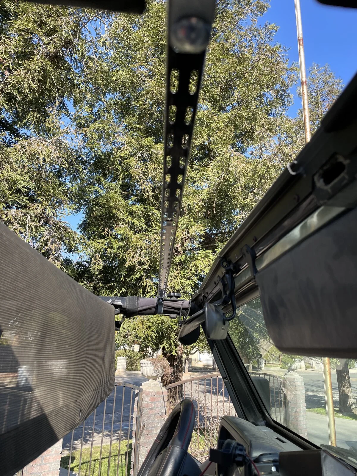

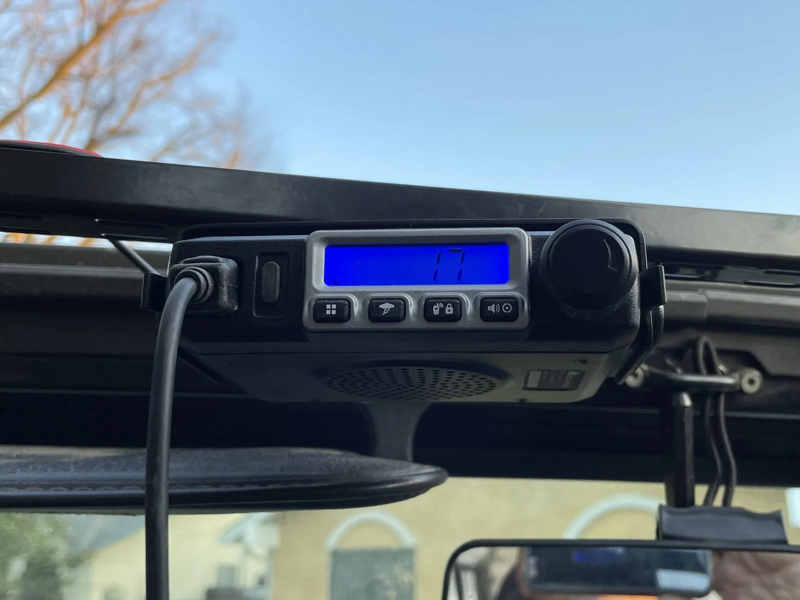

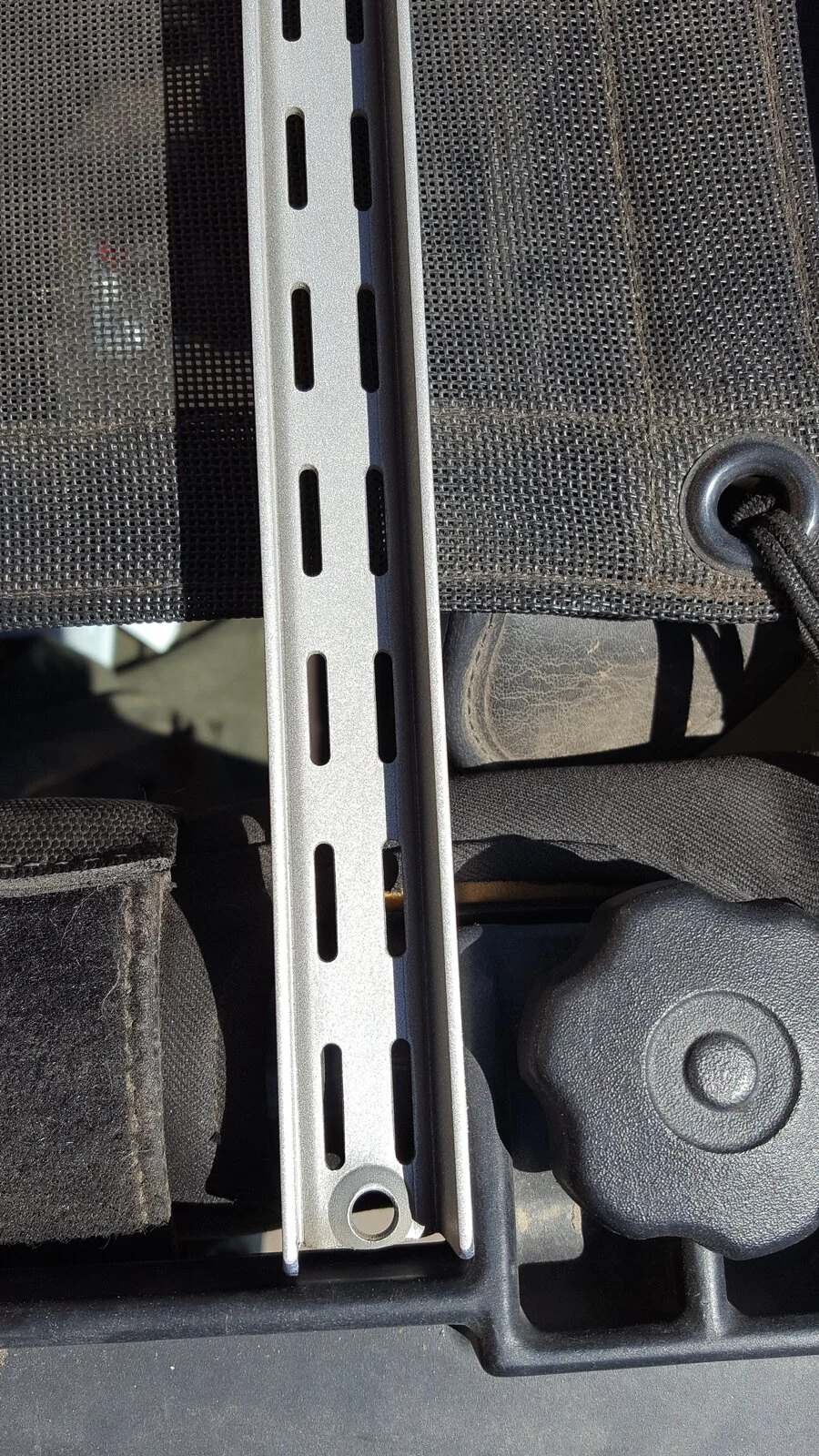

I got this idea from another member who I'd really like to give credit to, but I can't find the thread. Simple mount made of 48" black shelf track, 1 5/8" chainlink fence bracket and 5/16 fasteners.

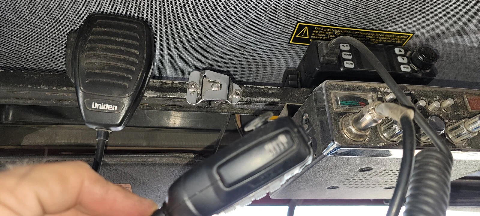

How do you store your hand mic when driving?

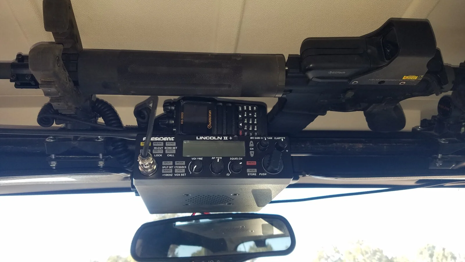

I was planning on making one out of uni-strut, when I found the ARR mount. The ARR mount was about the same amount of money as a piece of uni-strut was at Rip-Off Homeless Despot prices - and took zero work.
With that said, I now wish I had gone ahead with the uni-strut idea. As nice as the ARR mount is, the uni-strut would have enabled a "cable tray" idea much like shown in the above pix. I have entirely too many wires tye-wrapped to the backside of my ARR as I now have 3 radios and 1 amp on the thing.

.... ummm.... that's the part I haven't figured out yet. I may wrap the cord around the bracket to shorten it up and put the mic clip on the underside, that way it's close to my head and I don't need a longer cord... but, I have to figure out the specifics.
I also have VERY crazy and over engineered idea based on a part I saw on the forums. It's a CAT5 plug that mounts to the dash. I'd attach the extension where the mic plugs in and then plug the mic in somewhere on the dash and put the mic hanger somewhere convenient.

One is hung on the rail, the other in a clip.
just below the mirror

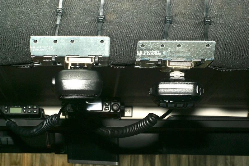

Here's what I did:
Magnetic mount. This WILL NOT WORK on rough trails - but I move them to the ARR mount proper when the going gets rough. But they're nice and out of the way otherwise. I'm not convinced I'll be keeping this permanently, its an experiment in progress.
