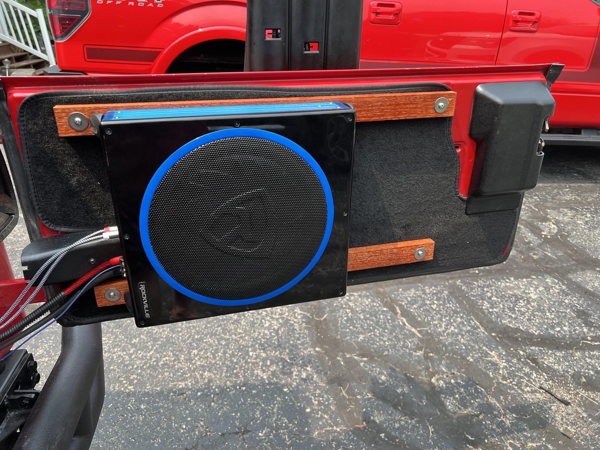

I opted for the 10” instead on my rear tailgate

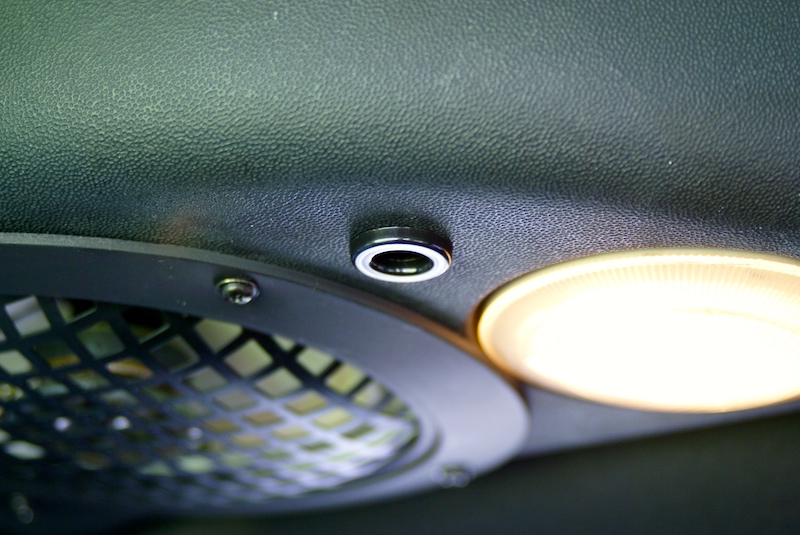

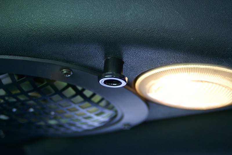

I did a similar test with the ports I installed in the soundbar speaker enclosures. Definitely sounded better with the ports uncovered.
Curious about how you ported the soundbar enclosures. I have the pods and wonder if porting would help.
