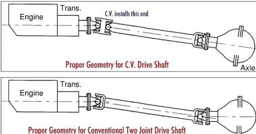

Adjustable rear UCAs are primarily to adjust driveshaft angles and front UCAs are primarily for adjusting caster and to alleviate driveshaft vibrations.
IF you are installing a SYE with 4" of lift; you most certainly will need adjustable rear UCAs to adjust driveshaft to pinion angles to 0* difference.

The simple answer, at least for the rear, is to look at your driveshaft angle. Assuming you have an SYE, you'll want the rear diff yoke to be exactly in line with the driveshaft, like Charles said. If you don't have an SYE, you'll want the yoke on the diff to be parallel to the yoke on the transfer case. With a 4" lift and no SYE your driveshaft angle will be super steep and the u-joints will not like it...and they'll tell you about it while you're driving.
That said, with a 4" lift, you'll almost certainly need (likely already have) an SYE, which virtually guarantees you'll need adjustable upper arms. Whether or not you need adjustable lower arms...well...the truth is that changing the rear pinion angle necessarily pushes the rear axle forward or backward. The adjustable lower arms can counteract that to correctly position the axle. Whether or not you find this to be necessary/beneficial is a different topic. I think you'll find a lot of people with similar setups to you only using adjustable uppers.
