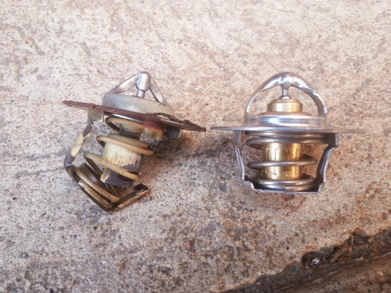

Unless the factory thermostat failed before 57k miles, here is the original next to the replacement I put in somewhere around 80k miles. I don't recall a jiggle valve on the 2003 original.

I never said he knows more than Chrysler but apparently you must.
This was already asked. Do TJ's come from the factory with a jiggle valve on the thermostat? If not, then no one is recommending anything that is a significant change from the factory.
The thread is about jiggle valves now!
