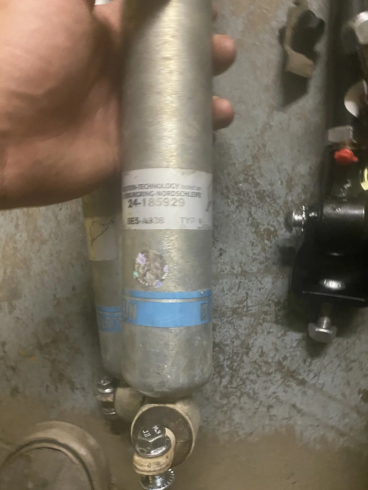

I’ve got bilsteins.It sounds like you may have the wrong shocks, what are you running right now?

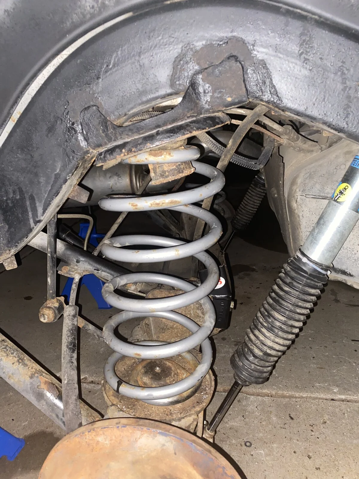

Okay, I got a picture of my rear for yaNow extend the bumps so that the jounces slow the speed of the shock as it reaches full compression. The number is what it is. The best way to figure this out is to remove the springs and fully cycle the axle. Raise the axle all the way up until the shocks are fully compressed. Add as much extension as is needed to make the steel cup touch the axle pad.
That is stock. Extend the cup and add something to the axle pad to get where it needs to be.Okay, I got a picture of my rear for yaView attachment 272282shouldn’t my jounce bumper cup be extended? Or is this stock?
