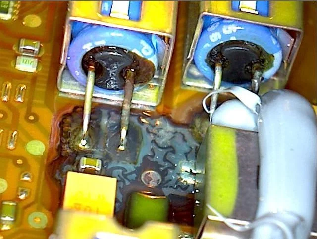

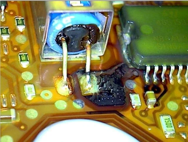

They do not have many issues. There are three caps that I would recommend changing as they tend to leak on the board over the years.

He's referring to capacitors leaking electrolytes. The images shown are taken from this thread showing what happens to the capacitors in the TJ's ECU over time (this also happens to pretty much any capacitor over time, not just ones in our Jeeps). Note the black and discolored spots at the base of the capacitors legs and body.
