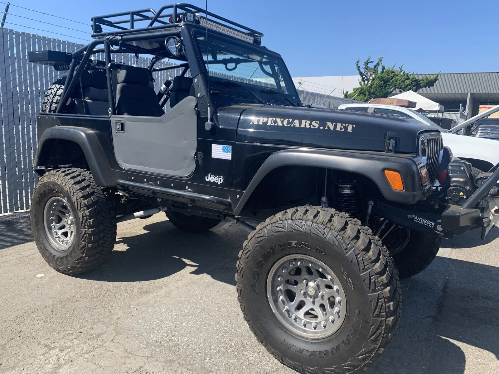

jjvw...I'm pulling it apart and re-measuring today and your line of thinking is exactly where I went. This jeep is a decade long build, can't remember the original RE lift height but I want to say 4.5. The springs I ordered from MC are also for 4.5 lift. I sort of glossed over the comments here about "way too heavy" because the springs actually sit correct with the top five rings fully compressed as they are supposed to. The look of the springs is correct. The problem as I stated in my original post (I think everybody just reacted to the pictures) is the adjustment required to achieve a level ride height. That coupled with the way the larger diameter springs look up against the Acos with no bucket or frame member directly above the spring...especially when adjusted down this far. What's weird is that the front spring looks correct and did not require an adjustment, it slipped into place without a problem and bump stops/ pucks didn't need to be adjusted. I didn't measure the overall height of the original Rubicon Express REAR springs when I removed them or compare them to the new MC springs which I probably should have done.
I moved up to 37" tires this year. I also pull an Adventure trailer with this thing on occasion which is why I decided to try the MC dual rate springs. Pulling a trailer sometimes overwhelmed the linear rate springs in the past and the extra weight requires and adjustment for ride height so there's the reasoning behind the Acos adjustable in the rear. Any of you who have ever added tongue weight to a TJ with a lift know exactly what I'm saying. I also have no clue if the MC springs will be any better in this scenario.
As you can see by the picture, the jeep isn't any heavier than a lot of your rigs and the lift height may be a little tall but not excessive for 37" tires on a TJ. It's also not over adjusted...about an inch higher in the back in this photo without any gear loaded. I'll report back after I pull it part and do some measuring. At this point and to me...it seems that I'm gonna need a higher lift spring in the back. I'm gonna reach out to Metal Cloak about the bucket issue at the top and using this spring with an Acos setup. Metal Cloak also claims that their springs are set up to account for the extra weight of accessories commonly found on a Jeep which is another reason I chose them. I figured on some settling once they are installed but a lot of what I have read from other users is that they really don't settle much.

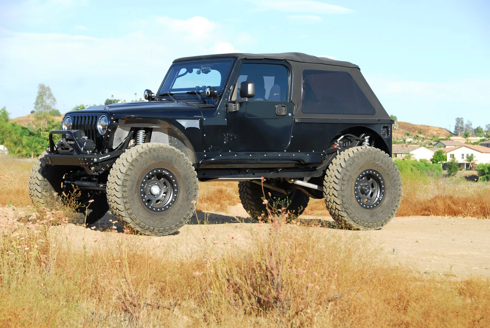

Considering that you have a bit more lift than this one with 7" of up travel on 40's, I'd say you were a bit overly tall.
