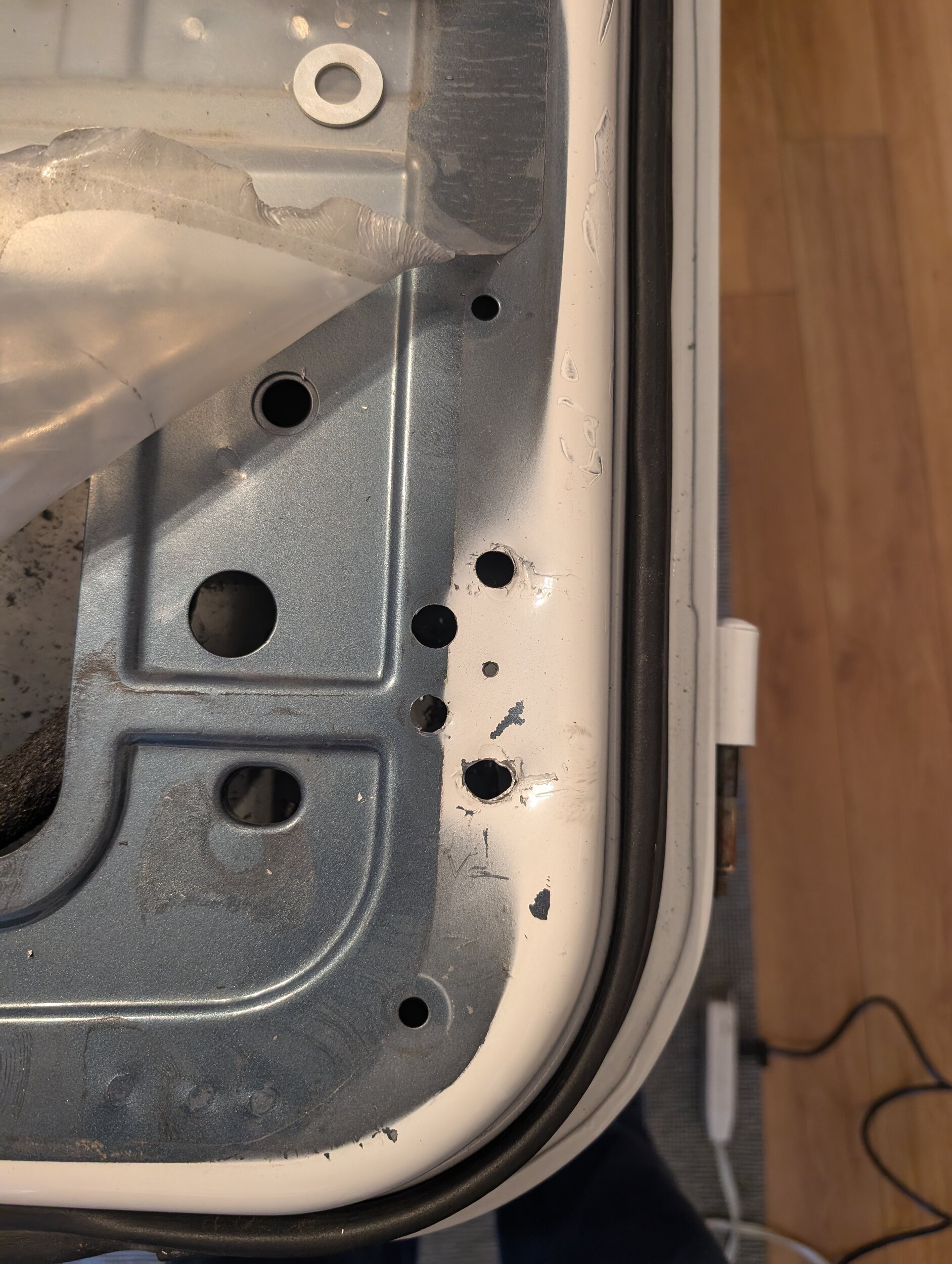

Here's the aftermath:
Right (Passenger):
Left (Driver):
Next step, figure out what size rivnuts and which tool to buy/use for the task.

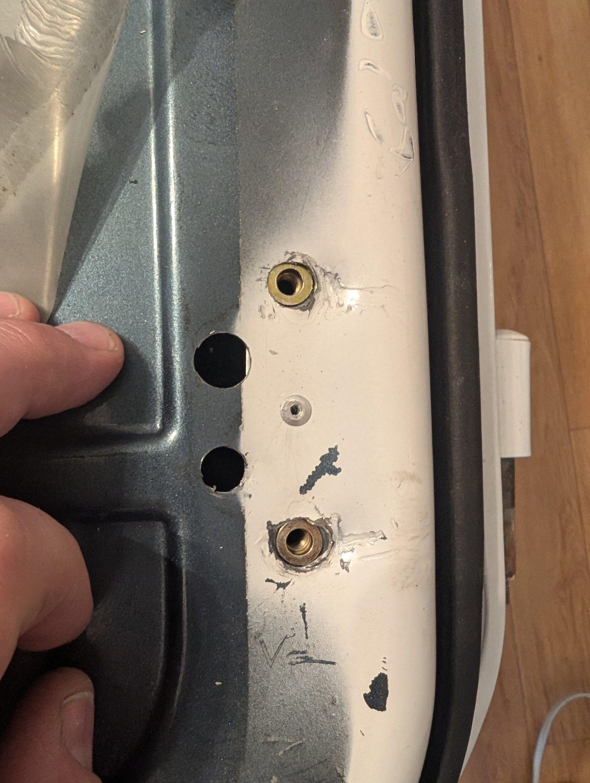

Today was finally the day where I tackled this project. Ultimately, I went @mrblaine's solution - make a new nutsert plate. The original plan was to drill out the existing holes and the nuts and go with an M6 nutsert in the existing plate, but due to the previous owner's hacks and a well meaning but misguided mechanic's attempt to "fix" it for me, the holes were just mangled and I was worried that the nutsert wouldn't get a good enough grip b/c the hole was just too big for the bottom hole (see pic below)

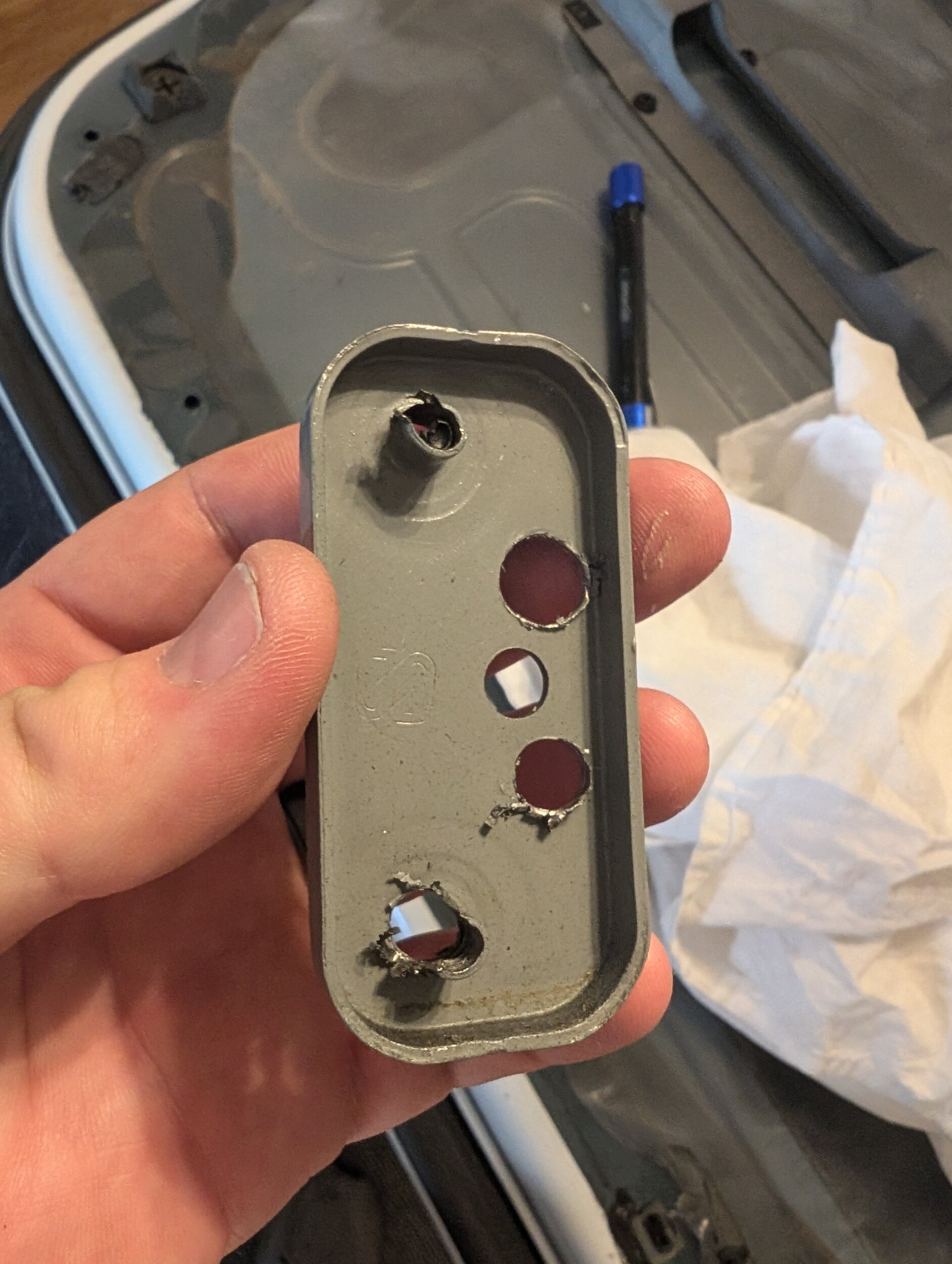

So first thing I did was drill out the spot welds holding the factory plate in place (those are the two holes to the left, right on the line of the repaint in the above pic). They're probably overly large, but I was somewhat panicing and was moving fast to ensure I had time to get to the hardware store and come up with a plan b.
Here's a pic of the factory plate. @Fulton_Hogan you mentioned how you were able to use files and other tools to clean this up while it was installed in the door. You're smarter than me; I looked at this with my dremel and had no idea how to get in there to remove the old "nuts" without making the holes too big, and I just couldn't get my dremel inside the door to do it.

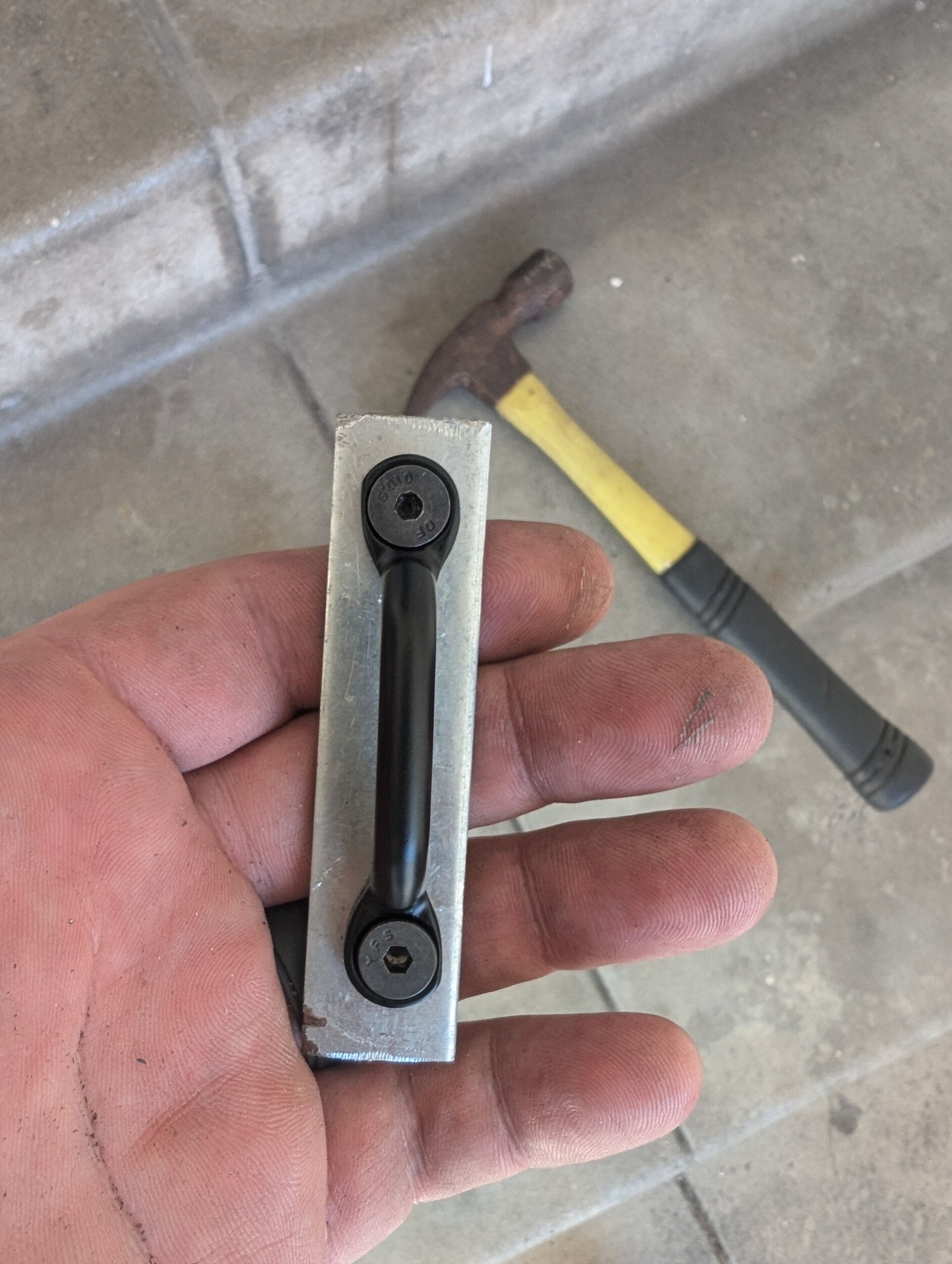

Anyways, with the old plate out, I went to the hardware store, and was fortunate to find just the right bit of flat metal - 12 gauge, 3/4" wide, 3ft long:
Took me 3 tries, but I was able to make a new nutsert plate Since I was making a complete new one, I used the M5 sized nutserts, rather than M6. Because M5 screws would fit in the holes in the new footman loop without opening up the holes in the loop. I also had the best success using a center punch followed by the smallest drill bit I had that would fully fit in the indent made by the punch, so the bit couldn't walk. Then using a step bit to step the hole up to the right size for the nutsert. I also did all of this on a sacrificial piece of wood so I could have a flat surface to put the plate on but holes in the wood that the installed nutserts could fit into during drilling of the later holes. My recommendation is to build it in this order:
  1. Drill first hole
  2. Install first nutsert
  3. Install footman loop temporarily
  4. Use punch to mark where the second hole should go
  5. Drill second hole
  6. Install second nutsert
Here's the successful plate with a good test fitting. Not perfectly centered, but eh, it's good enough for a Chrysler.
At this point, it was time to mount it in the door. I ended up just drilling a 1/8" hole centered between the two holes in the door (see first picture ) for a 1/8" rivet, because that's all I had and the hardware store didn't carry 3/16" rivets as recommended by @mrblaine. Then I lined the plate up in the door, marked where the hole for the rivet should go in the plate, and drilled the plate (again using the punch and the smallest bit pilot hole technique). Thankfully I didn't mess the hole up, and got it riveted in (I did have my neighbor put the rivet in while I held the plate in place. Second set of hands FTW).
And here it is with the loop installed
All in all, my main regret was just not starting earlier in the day. I should have known that there would have been bumps in the road.
Today was finally the day where I tackled this project. Ultimately, I went @mrblaine's solution - make a new nutsert plate. The original plan was to drill out the existing holes and the nuts and go with an M6 nutsert in the existing plate, but due to the previous owner's hacks and a well meaning but misguided mechanic's attempt to "fix" it for me, the holes were just mangled and I was worried that the nutsert wouldn't get a good enough grip b/c the hole was just too big for the bottom hole (see pic below)View attachment 599623
  1. Drill first hole
