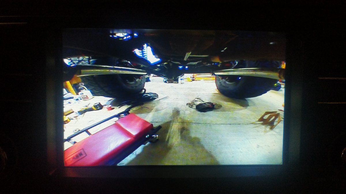

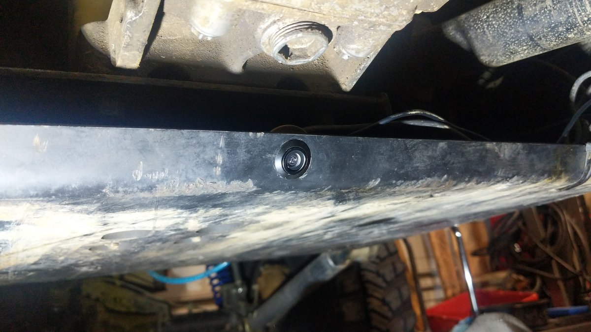

Can you post a pic of the front tire view?
Sure. Haven't gotten the chance to take it offroad, but with a Dana 60 with a full truss, I don't think there is a place to mount it that would give a better view. But for $20 https://www.amazon.com/gp/product/B074P45P7G/?tag=wranglerorg-20 I had to try. :cool:

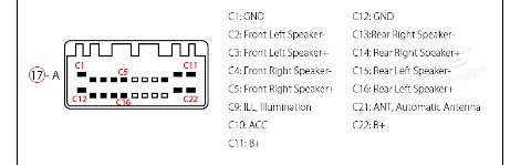

Anybody reading about this in the future the harness provided on the radio people were having trouble with is actually not wired correctly for a 2004 that's why the sub isn't working. The polarity of the front left and rear right are reversed. To make the factory sub work you need to switch pins C2/C3 and also C13/C14. After this swap it'll work fine. The speaker polarity from the ground side needs to go + - - + and not - + - +.
For those that are using an external sub with the factory speakers powered by the deck you still might consider the swap. The speakers would be out of phase.
Very interesting. Thanks for this. By any chance, have you or anyone else found the time alignment to be useless? From what you mentioned here, with the internal wiring, this has me wondering if that could be the reason why the adjustments don't behave as they should.
I'd assumed it was because of the way our factory sub is wired, but mixed up wiring sure does sound like it could be the culprit.
Between the extremely poor preout voltage and the wonky time alignment, I ended up taking mine out.
The wiring pigtail provided for Chrysler installations is the only thing wrong. Once the wires in the adapter are swapped the problem is fixed. The deck itself has the outputs labeled correctly and they weren't going to the correct wires on the Jeep. That's all that's going on as far as I know. If you could talk to your 75 year old self, that guy would tell you to stop spending money on car stereos.
