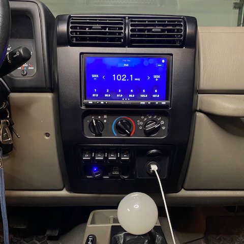

I got an Alpine with Carplay, along with the Alpine "micro amp" and it's been a great setup so far. My only gripe is that the "next" song button is all digital. Not a problem normally but if I'm using one of the map app's for GPS, I have to go into my Spotify app to forward to the next song. It's easier to just tap my phone or flick the "next" button on my watch, but it would be nice if it had a dedicated button on the bottom bezel for it. I rarely use the phone/microphone buttons.

Did you need to do any mods with that, or is that only required with the full sized/mechanical head units?
Well the headunit itself requires trimming of the dash a little. The micro-amp was wired off of the old subwoofer factory wiring that I pulled back to under the dash. Straight forward stuff mainly but a tad time consuming to make it all look smooth and factory back there.
