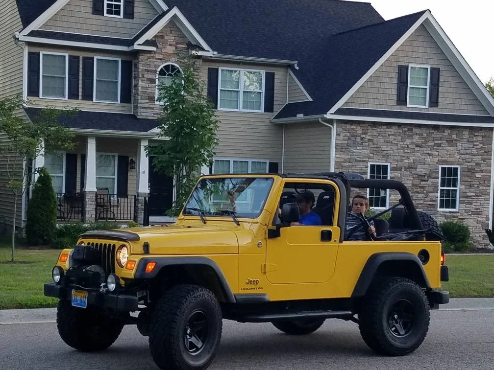

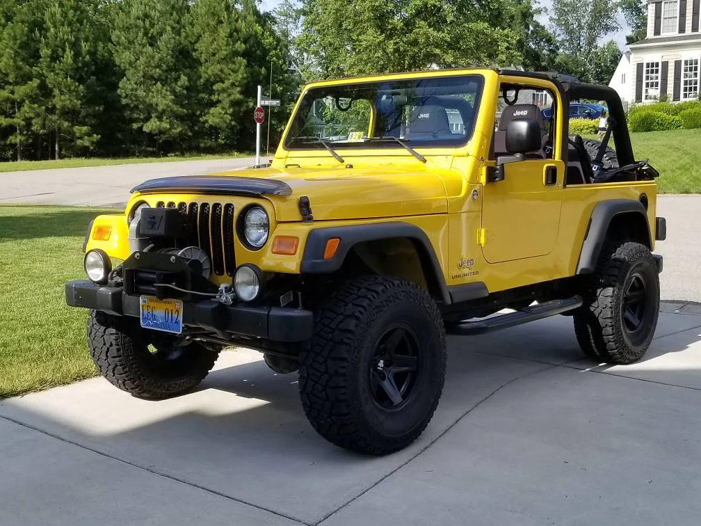

I am running 33's on15 inch wheels with the DPG Ultimate kit. With the Ultimate kit (among others) you have to contact Dirk directly and he will ask you all sorts of questions about your jeep and your plans for it so he can set you up with the correct coils, (stiffness and rebound).

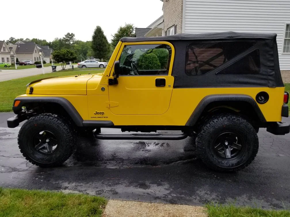

I have the DPG kit also. I think it’s a great kit for the money and gives you everything you need to successfully lift with minimal issues.
I’d do a dry steer test too before and note any issues you might have which might be exasperated when you install the lift. With mine I got death wobble due to some warn out steering parts.
One thing to note, you might be able to save some money by mix matching parts, some Rancho shocks (a lot of people regard to be the best and aren’t expensive), ~ 2” springs which are fairly cheap, a BL and a MML. Trackbars probably aren’t really needed on a short lift, at least not right away.
For my coil raiting on the DPG kit I went on the lighter side, I know I’ll probably replace the springs at some point but really they’re not too expensive and my Jeep will drive/sit better until I get around to some of those other mods. Depends on your timeline really.
I sent Dirk at DPG photos of the setup I had before I installed the OME kit. He was able to identify the reason for my bump steer which was due to a drop pitman arm. Replaced that too, problem solved.
