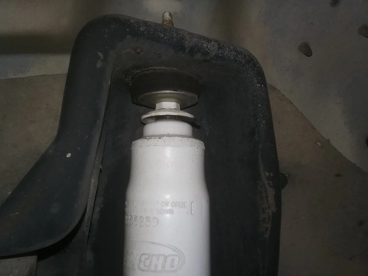

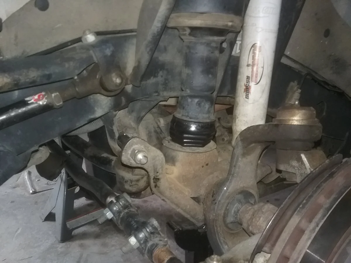

Those likely are 2" lift springs (OME 933 fronts/942 rears). It's what I'm running on my TJ.
The issue with using the 55239 front shocks is the compressed length. With the front axle at full bump, with 1.75" of added bump stop extension, you get really close to the shock's full compression.
Full bump:
Shock at full bump with 1.75" bumps:
As you can see there is maybe 0.5" of travel left till the shock hits full compression. So, if you are going to run these shocks, and your tires aren't the interference, then you better add at minimum, 1.75" of bump stop extension.

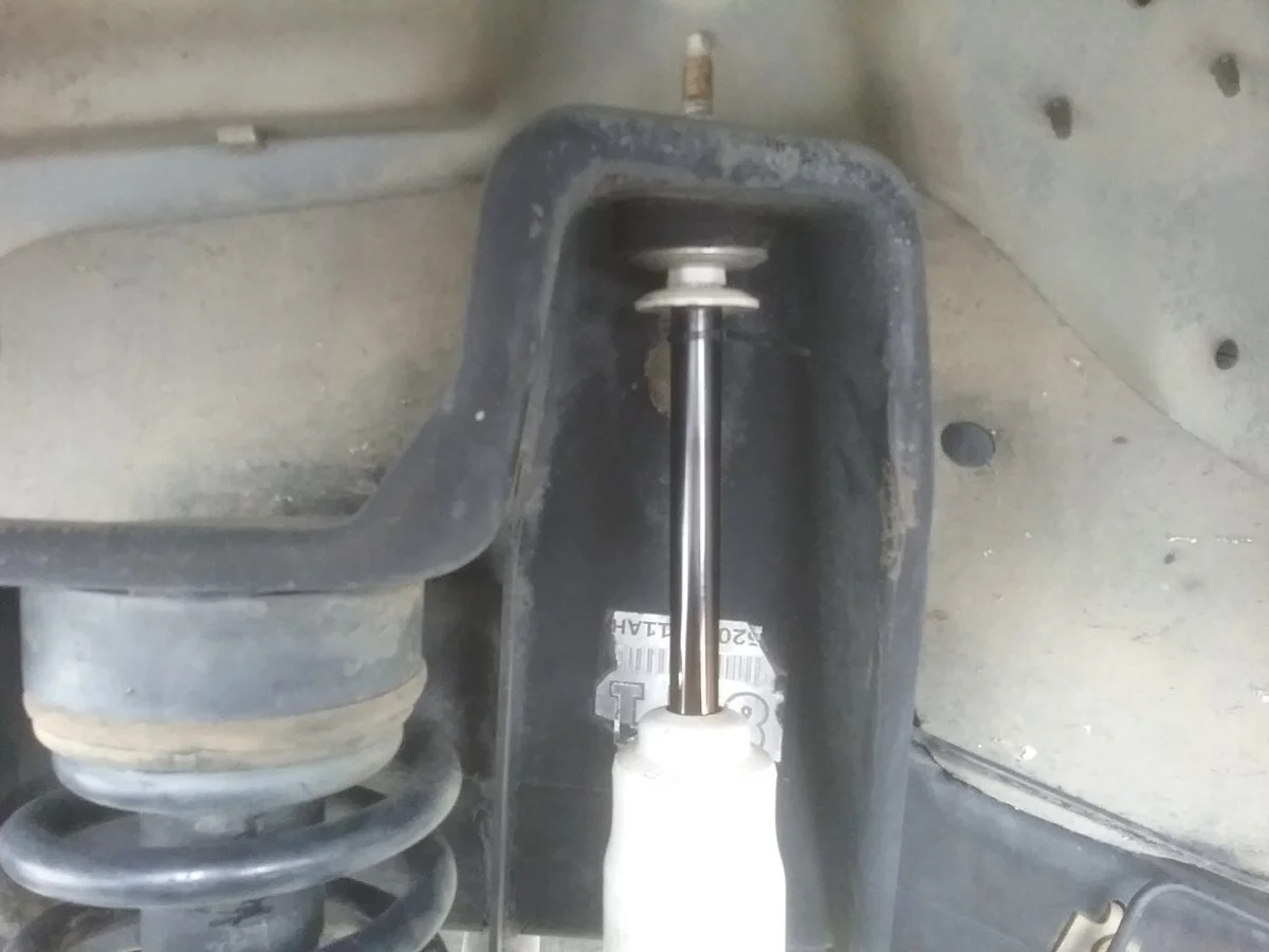

What you are trying to shoot for is a shock that will provide a 50/50 bias, meaning as much up travel as it has in down travel, ie... a 10" travel shock giving you 5" up and 5" down at ride height.
With my 2" springs and 1" spring spacers, at ride height my shocks sit here,
Full bump:

Pictures sometimes help send it home.
Thanks a lot for posting those! I think I am starting to understand bump stops now, at least the basics. You don't want the shock to bottom out (hit full compression and then some, probably blowing your shock) so you put this spacer in there which hits the frame as the axle rises just in time to prevent this.
