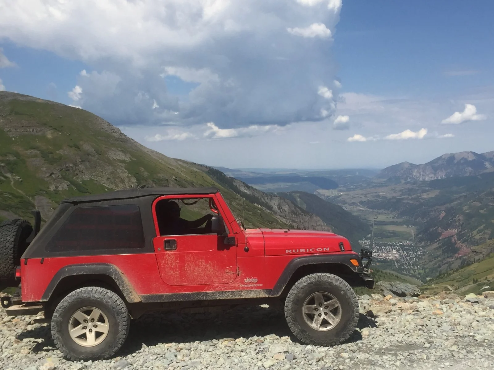

Here is my LJ with the stock 16" Moabs on Black Bear Pass in Colorado, like Chris I prefer the 33" due to having more room for them to articulate, the 35" look great but they will rub if you do any descent trails......I have a very heavy rear bumper (fabricated by me and a Warn 8000 lb. winch up front, I do not have any "spacers"......... my DPG kit is 13 years old, I have swapped out the shocks (they blew 2 years after installation) with Bilsteins 5100, and the front JKS johnny joint froze so I replaced it with a Metalcloak.
