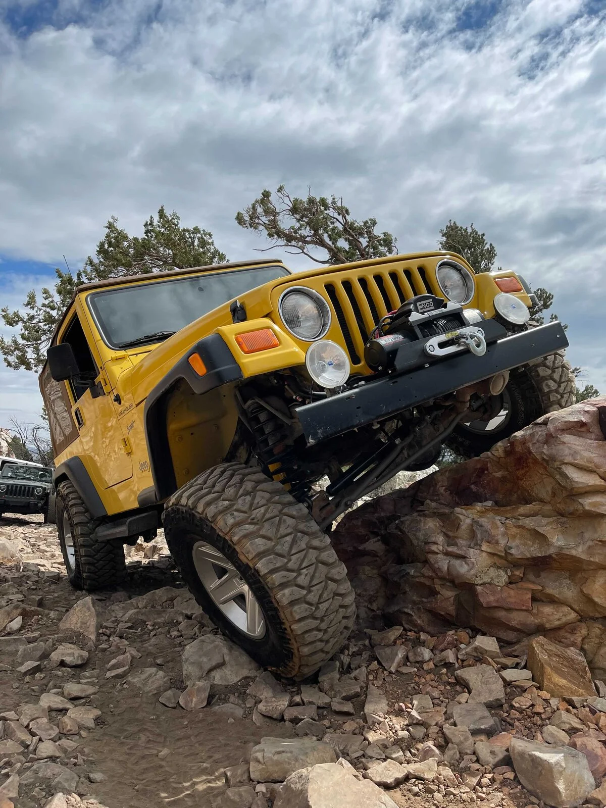

Hello, im planning to buy some 35"s pretty soon and wanted some feedback on what springs to buy. Here is my current build:
  • Dana 30/44
  • 15" aluminum Quadratec wheels
  • DPG- Ultimate Lift Kit with long tube shocks
    • 2.5" OME Springs
    • JKS Front/Rear track bar
    • JKS Adj Rear Swaybar End Links
    • JKS Disco
    • Extended SS Brakelines
    • OME Nitro Shocks
    • OME Springs
    • Brown Dog Motor Mount
    • JKS 1.25″ Body Lift
    • DPG 2″ Extended Bump stops
  • SYE Kit w/Adams Driveshaft
  • Core 4x4 Tier 3 control arms
  • 5.13 Gears
  • Revolution Chromoly Axles upfront
  • Black Magic Big Brake Kit. Ty blaine!
  • ZJ steering upgrade
  • Mountain Offroad Heavy Duty Motor Brackets
  • Savvy Transfercase Cable Shifter
  • 1.5" Spring Spacer up front
  • Monroe Steering Damper
  • E Locker Rear
  • Auto Locker Front
I like rock crawling. Right now the ride is stiff and sharp, which i like but it does bounce in the rear ALOT. Maybe its my OME shocks? Doubt its the springs idk.
I want to keep my fenders. I dont like how aftermarket fenders look. I'm okay with maybe sacrificing a little bit of flex to keep my fenders. What brand of springs should i buy? and is 4" springs + my 1.25" body lift enough for 35"s?
