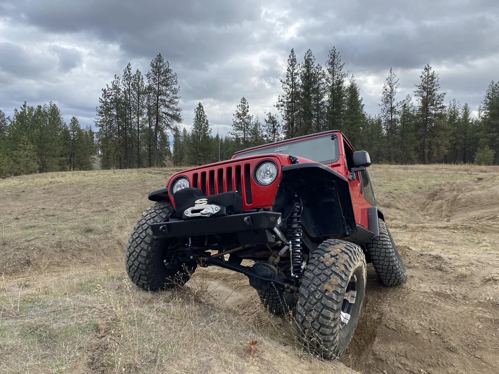

Im using the rancho 5000x series up front with 5.25" of up/down travel. There are reports of them being mushy but I like them. A properly tuned fox though (what I have in the rear) is better. All of my shock mounts have been moved, so the currie/rockjock spring travel and shock travel are all usable. 11" up front and 12" can be set up to work really well on the TJ platform

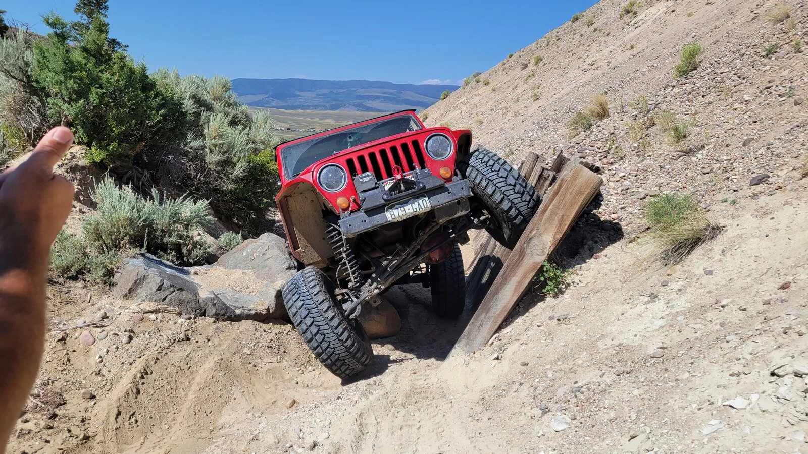

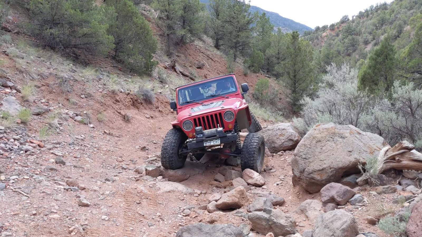

Im using the rancho 5000x series up front with 5.25" of up/down travel. There are reports of them being mushy but I like them. A properly tuned fox though (what I have in the rear) is better. All of my shock mounts have been moved, so the currie/rockjock spring travel and shock travel are all usable. 11" up front and 12" can be set up to work really well on the TJ platformView attachment 287053View attachment 287054
Love that first photo.
Reactions: tworley
Flex city my boy.
