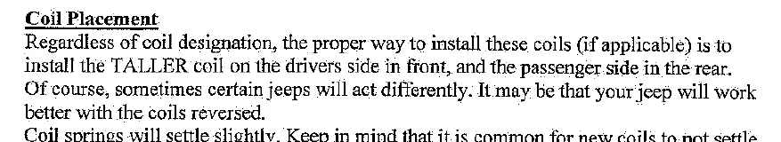

I put the A spring on the front driver's side and rear passenger side. B on the other sides. Is that what DPG recommends? I found that posted on the internet, went with it, and it came out level.
