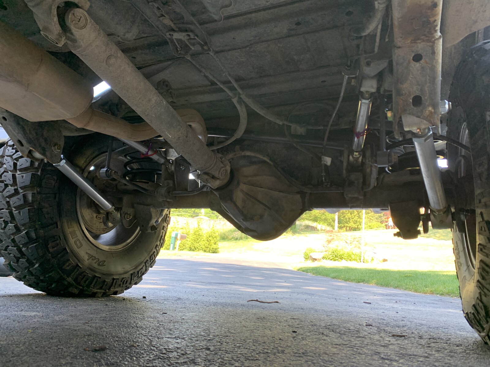

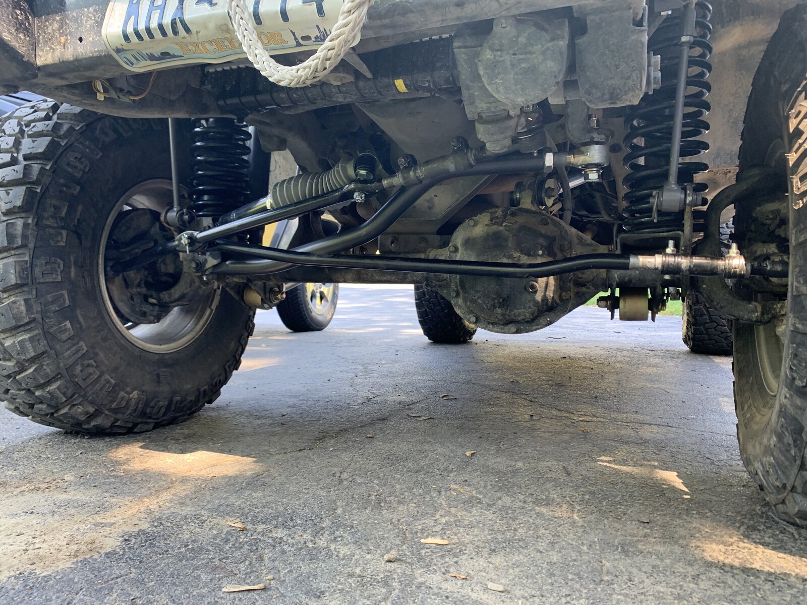

Just finished install last couple days;
4” Currie springs
8 Savvy control arms
Front and rear Core 4x4 tier 3 track bars
Currie rear track bar relocation bracket
Extended front and rear sway bar links
Rancho 5000 shocks 2-4” lift
Currie bump stops
Extended brake lines
☺️ lucky me
question is....
When leaving from a complete stop, turning left from one street to another, just enough skinny pedal and the left front wheel comes off the ground and hangs for a moment.
Is this a result of something I did wrong? Or just a result in of what I did?
Thanks
I should note it’s otherwise riding great. 75mph on Taconic State Parkway, potholes, storm drains and corners. No bump steer, no death wobble. And quite straight down the road 🤙🏼

hard to tell but in the pic is your driver side higher from standing still? kinda looks like it?

Yes, fact, it's a geometry issue with 4" lift. It can be corrected, but I'm not going there. 🤣
I wouldn’t mind a push towards where I read about said correction. I did scout the threads before posting for discussions that i know must be out there.
JMT
The Jeep Guy
Feb 27, 2017
13,736
See Post #8 again.
