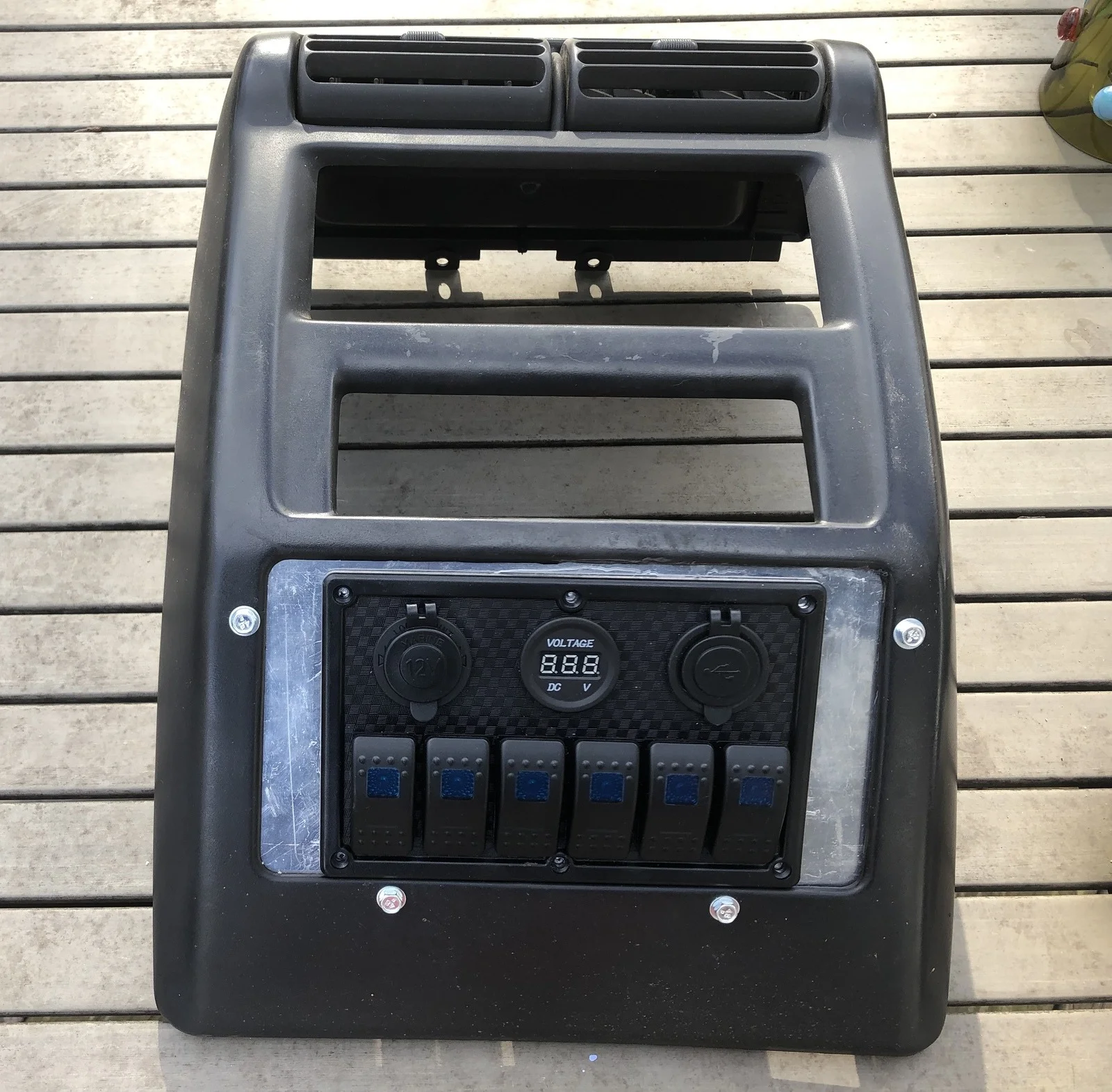

Circling back on something I started a while back. I cut my ashtray out with a dremel and then cut down a piece of aluminum sheet metal to fit the opening. Cut out a spot for the switch and it fits pretty good. Mounted the aluminum using the four bolts you see. I'm hoping to wire it up this weekend and then probably black out all the metal showing.
OOOFF, that's purdy. I ended up going with the cheap-but-easy rocker switches that pop into a replacement air vent right above the stereo head. I really like it, but it's not nearly as professional or unique as what @brianb2 has done.
