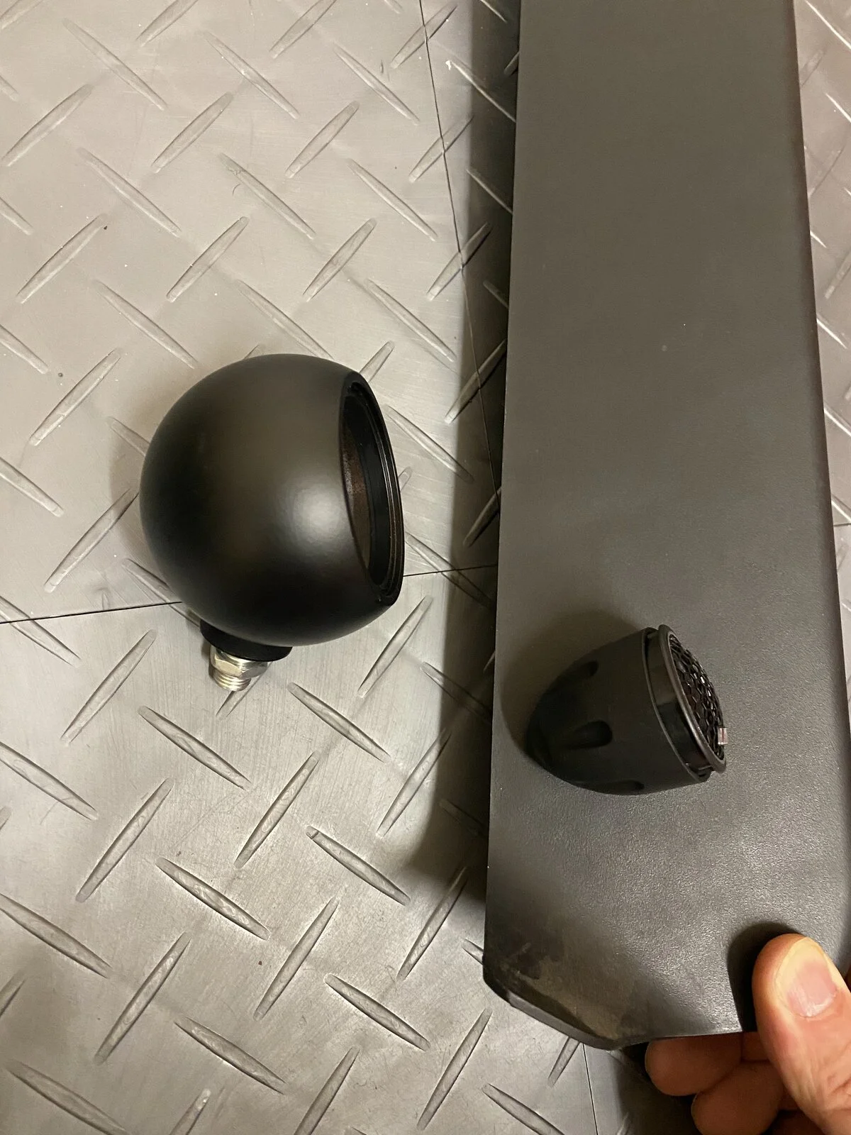

See attached pics of pods and tweets.

@LJGreg built his own tweeter pods, with using the pods supplied from him BLAM speakers, the same BLAM's I mentioned above. It looked like this - His old tweeter pod and the newer smaller one.
