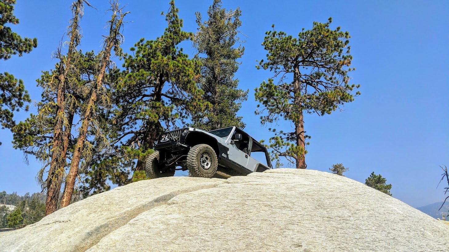

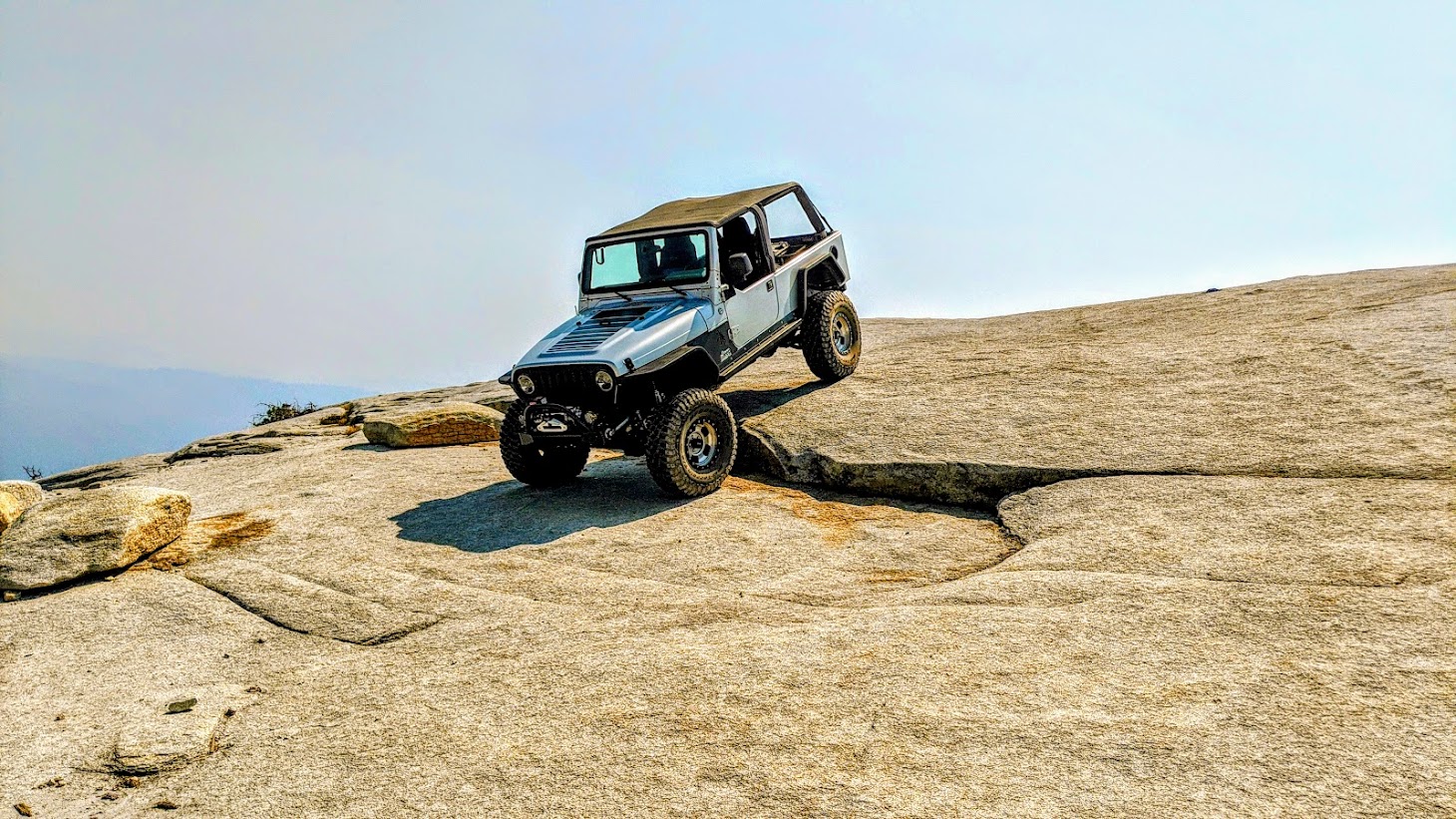

This is more like it!!!!
Sierra National Forest is open as well as my favorite local trails.
Did Bald Mountain Trail today. First time with 5.13 gears , lockers, and 5.25" lift.
Wow! Great improvements, it handled everything I could throw at it without blinking an eye. The only thing holding my rig back now is my own testicular fortitude.
I didn't go to crazy today because I was alone. If I was wheeling with a group or partner, it would have been balls out.
I had a great time on this granite playground though. Lots of poser shots. Lol.
Also, stopped at 2 of my favorite places, the old Dinkey Creek Bridge and McKinley Grove giant sequoia forest.
Great day to just chill and appreciate nature!!!

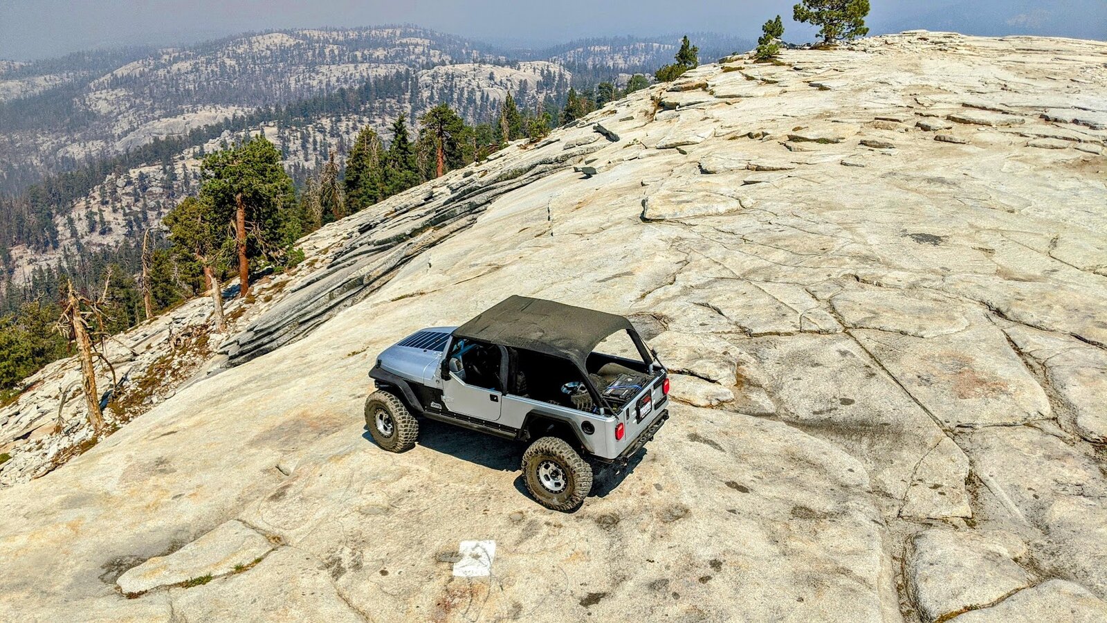

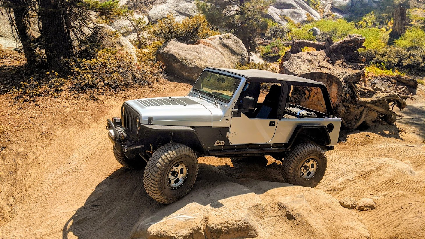

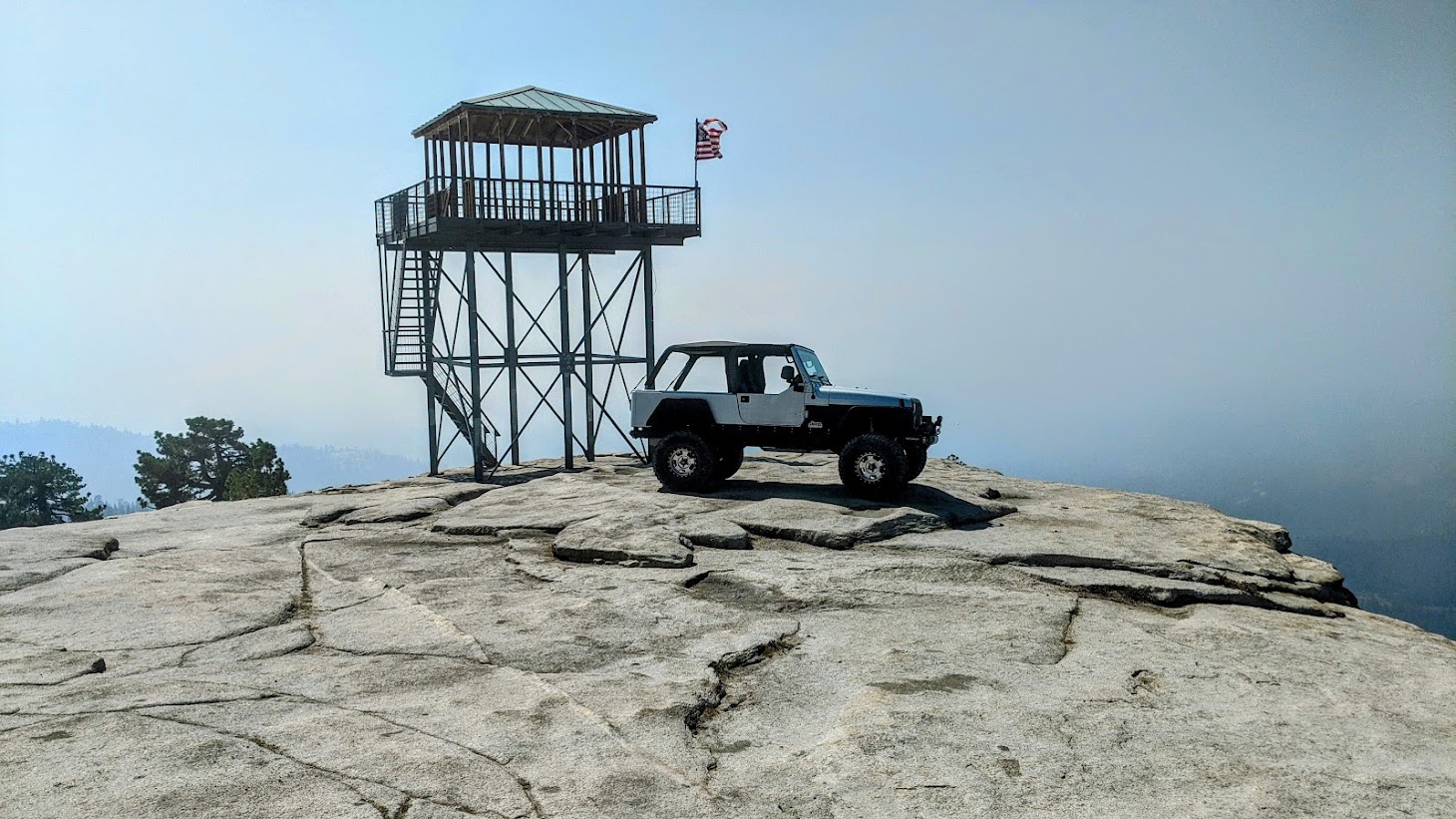

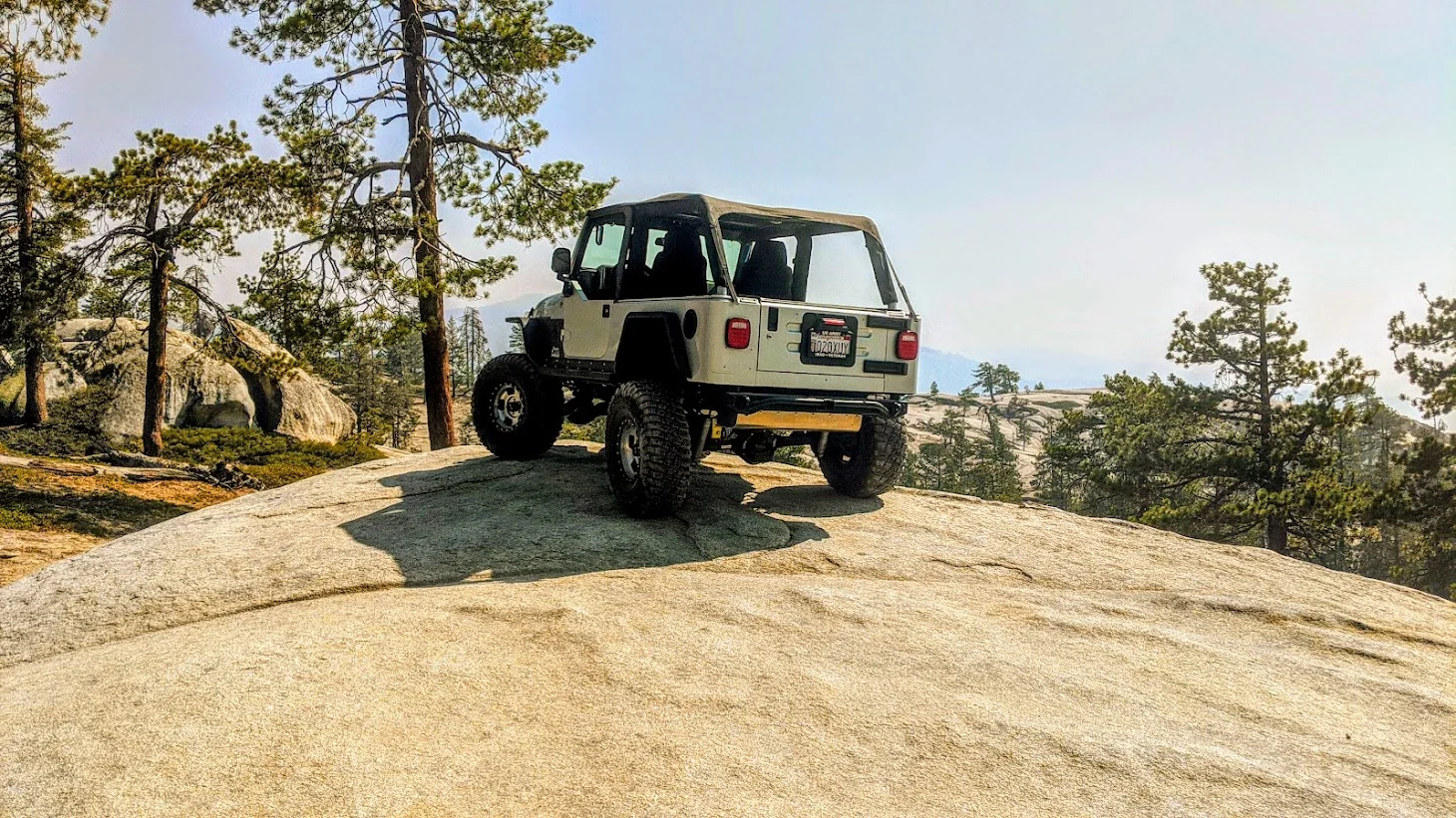

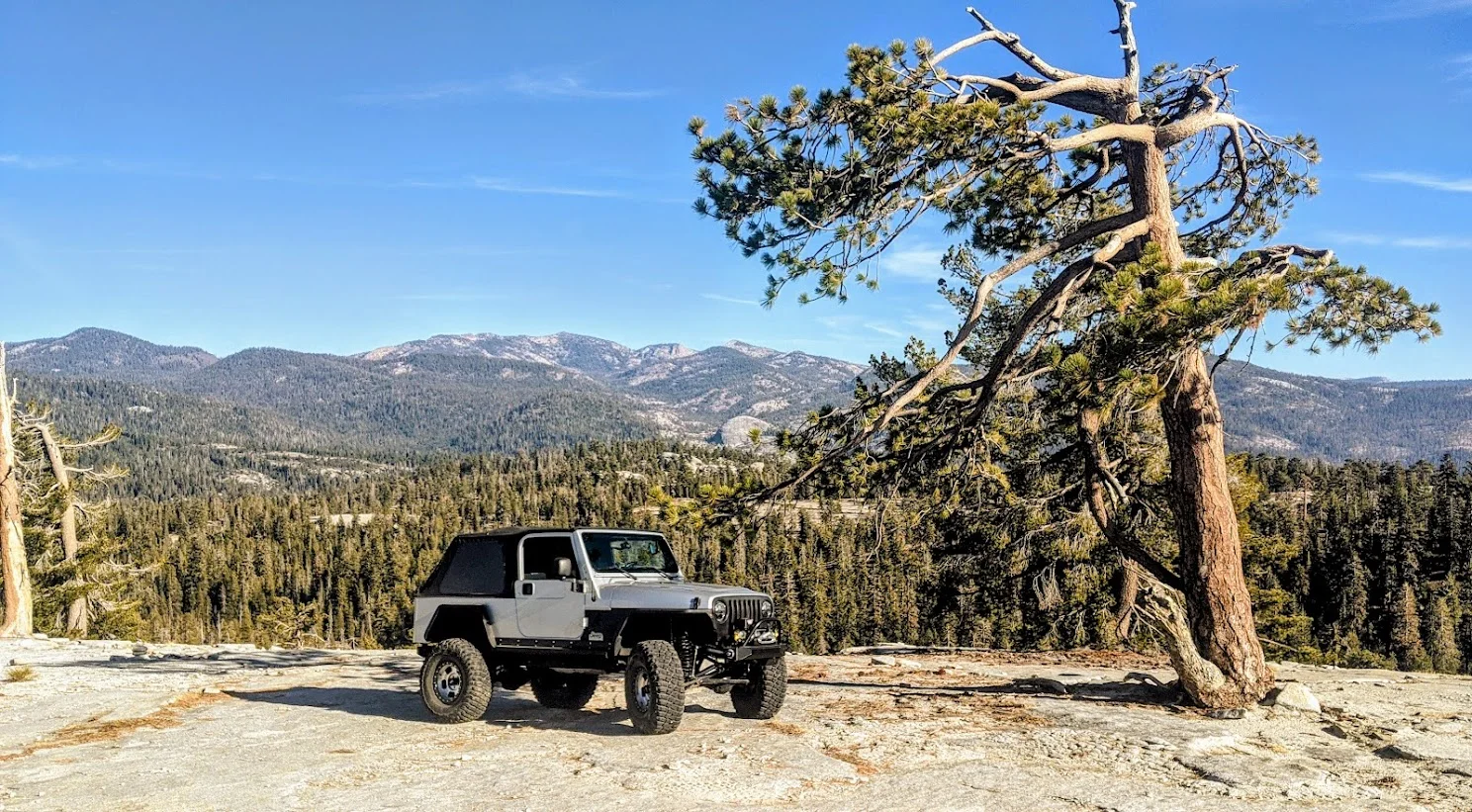

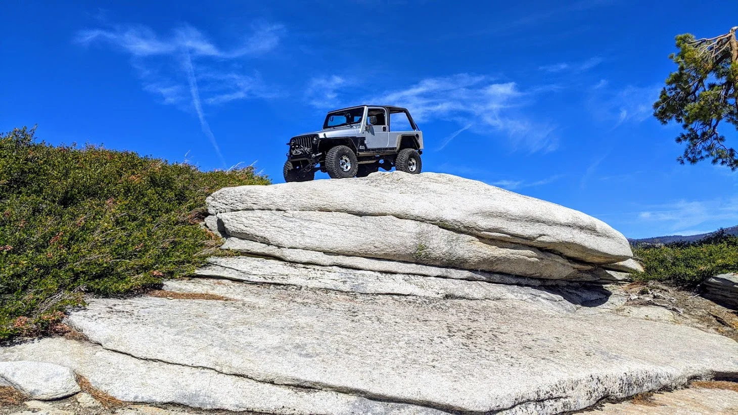

View attachment 278410View attachment 278411
View attachment 278414View attachment 278415

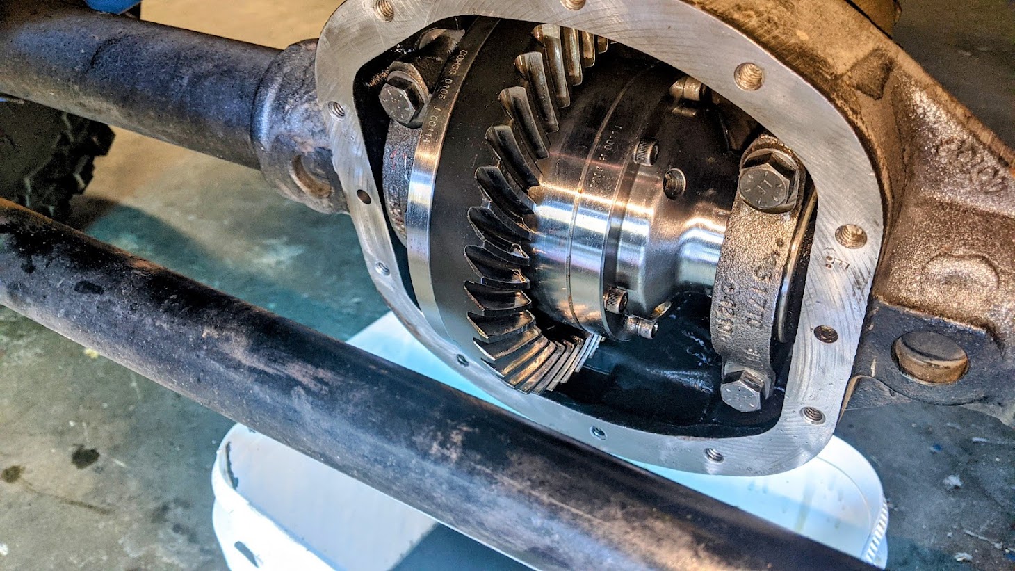

Yesterday I did my 1000 mile gear lube change after regearing in August. I did the 500 mile break-in procedure as directed, and since then have done a couple of wheeling trips.
Broke open the diffs and everthing looked good. A slight sparkle of micro metallic bits in the old fluid, but no chunks or bits of anything. I did a torque check in the bearing caps and the ring gear bolts. Everything looks good.
I cleaned up the mating surfaces, swapped in some Lubelocker gaskets, bolted everything back up, and refilled them.
No leaks on the diffs this morning.
I couldn't be happier with how the new gears and lockers have performed. It wasn't cheap, but it was so worth it!

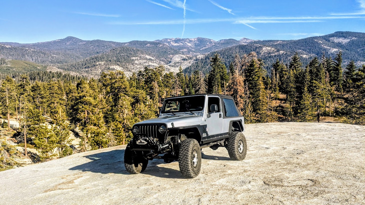

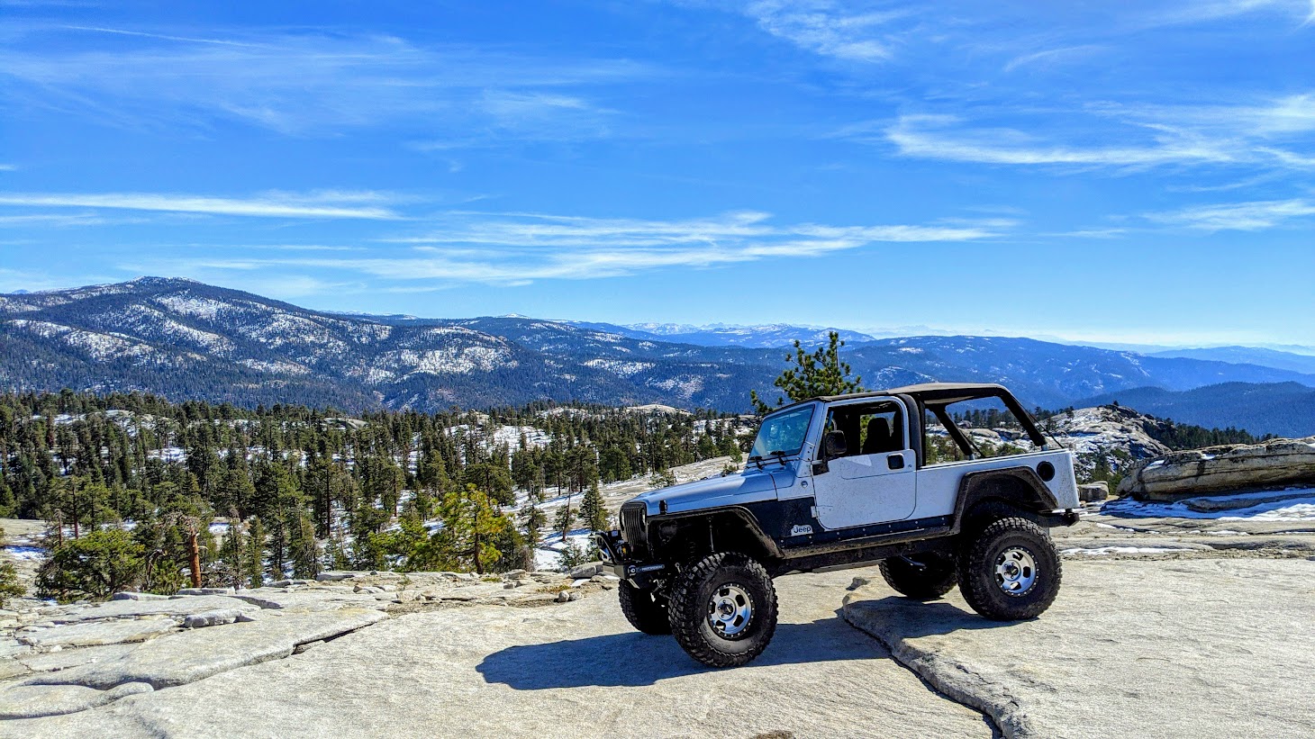

So with my diffs freshly serviced, I thought I'd hit the trails today. We got snow last weekend up there and a new storm is expected next weekend to dump alot of snow and rain in the Sierra's.
I figured i'd try to shoehorn a mountain trail ride before winter closures start happening.
There was some old crusty snow in the shady draws on the way up the trail, but traction was still pretty good.
Once I broke out of the trees and up on the granite, the snow was melted on the warm rocks.
Cool but not to cold, clean clear air, and lots of sunshine.
Great day! Glad I called in sick to work today.

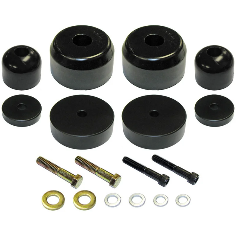

I could just install it all back in with a new bolt and call it good, but I'll take it as a sign from above that I need to install a Rockjock bump kit and get rid of my stock bumps and hockey puck setup.
Ordered the Rockjock bump kit today. It should be in by next week.

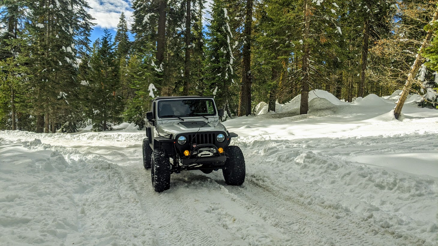

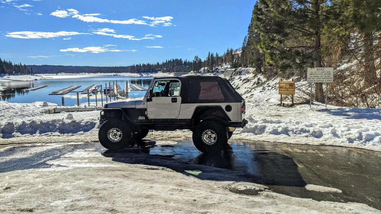

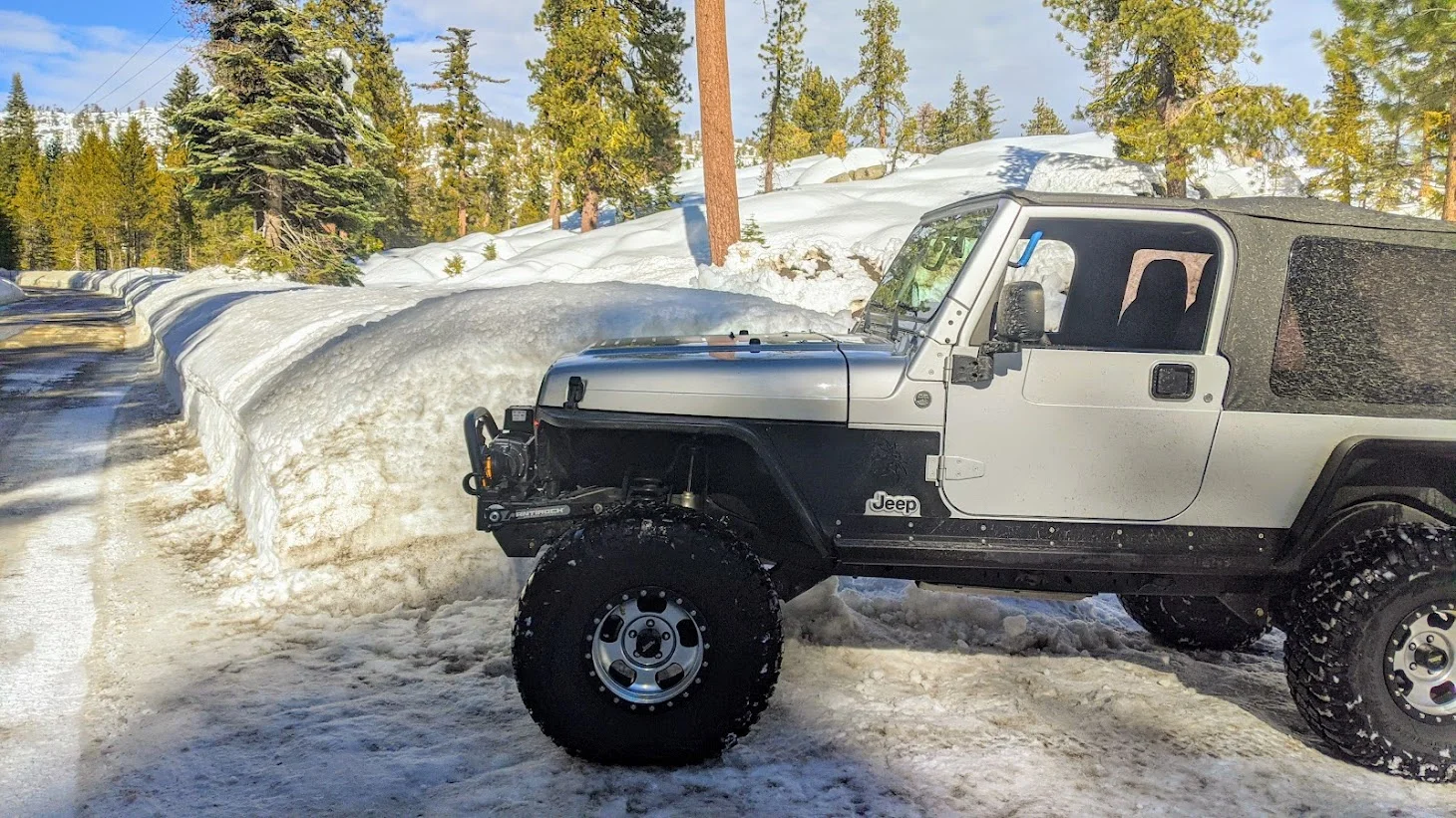

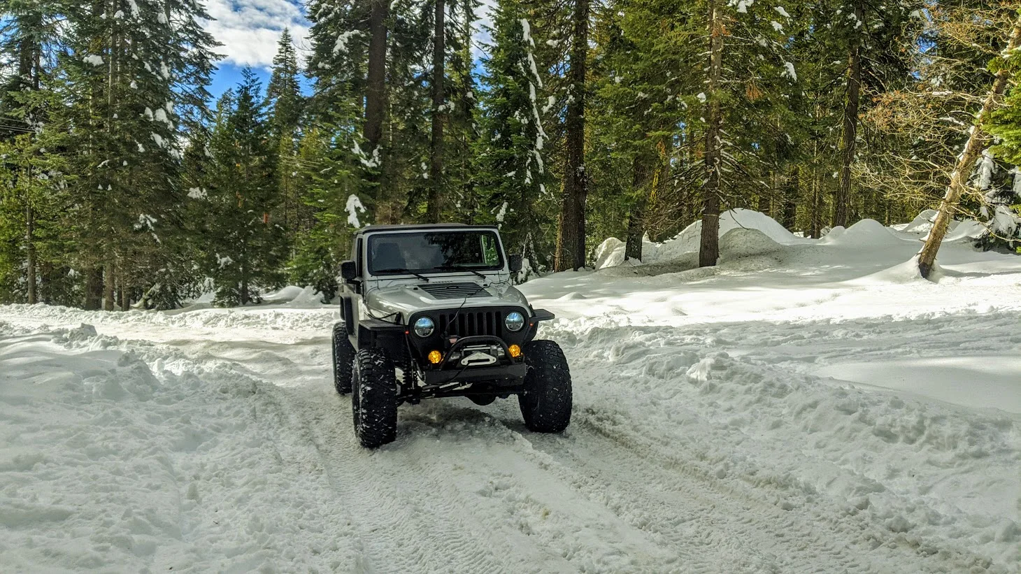

This time last month, I was lamenting about the lack of snow in the Sierra's. Well, December was a banner month, and we are now at least 160% of average for snowfall.
I headed up to the forest today to check out the snow and play around in it a bit.

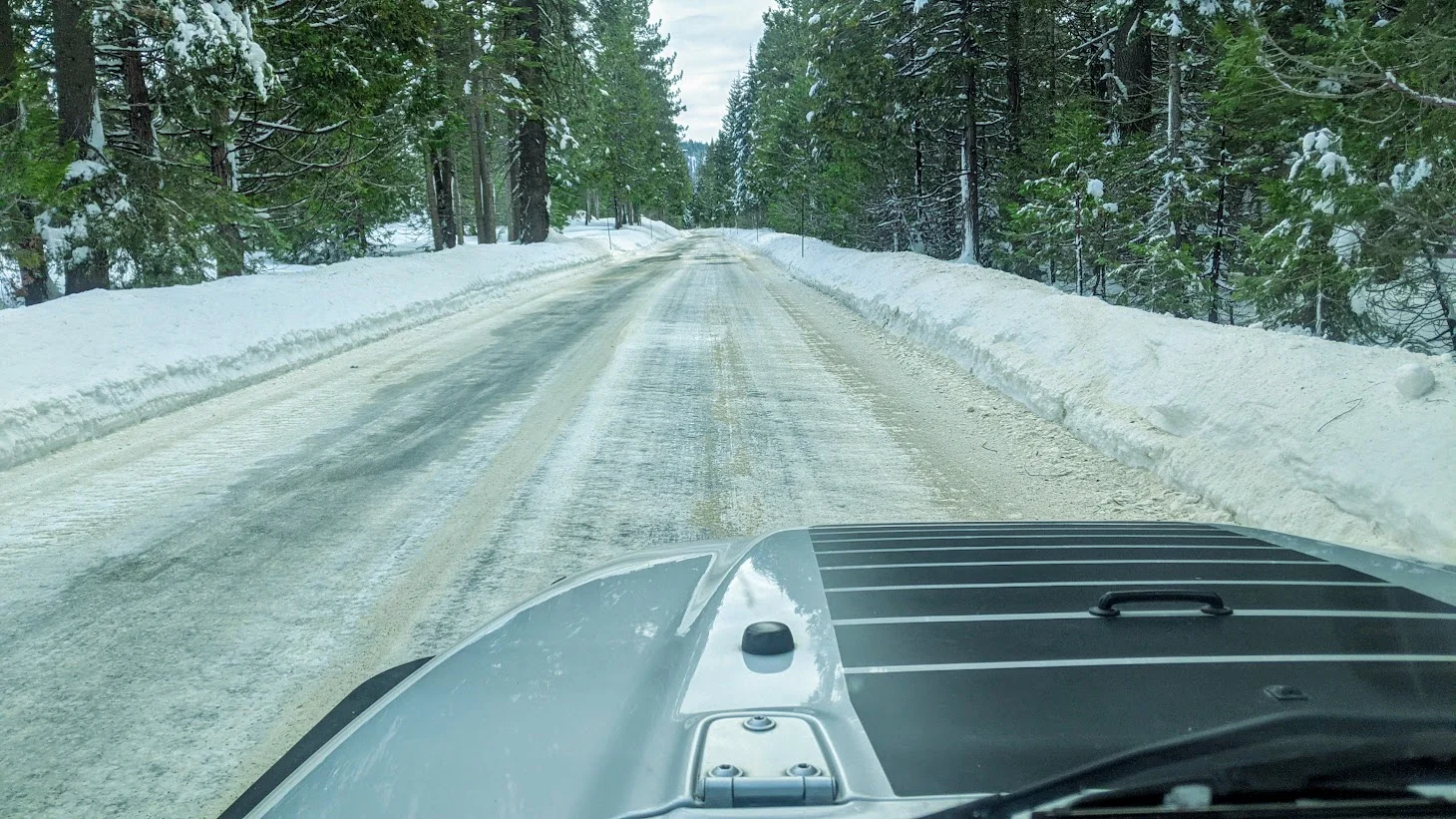

I wanted to test out my Yukon Grizzly lockers on the icy roads as well. Auto lockers like the Grizzly and Detroit don't have a great reputation in ice or snow.
I tested it out on a moderately icy highway headed up to about 7000'. I took it slow and as long as I didn't give any sharp inputs on the accelerator or steering wheel, it handled quite nicely. The only time I would be in situations like this is when I go snowboarding or get caught in a storm. The Grizzlies performed well enough that I would have confidence in them to get me down or up the mountain without feeling like I was jeopardizing my life and would spin into a ditch simply by attempting to drive on ice.
I got off on a forest road for a bit, but didn't get far. I underestimated how deep and soft the snow was and didn't make it a 1/4 mile and got stuck. I winched myself back onto the center of the trail and managed to get back to the road.
Spent the rest of the day farting around and taking in the scenery. Glad the snow is here, hope there is a lot more to come.
