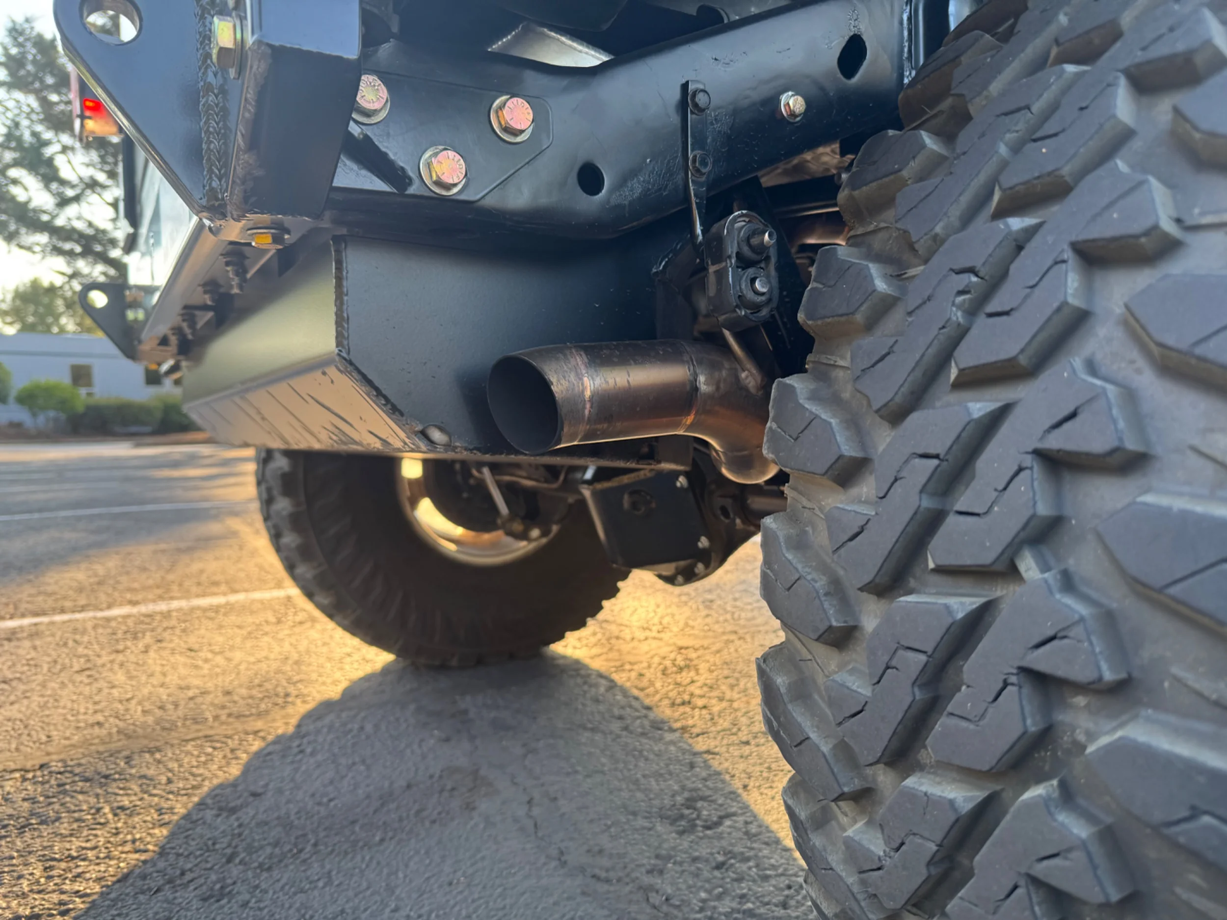

I think changing the tip will be the answer. My current tip blows pretty much straight back.
I don’t really want to lengthen it for clearance reasons, but I’m guessing a turn down, like the stock tailpipes, will will help direct flow away from the low pressure zone behind the tailgate and prevent exhaust from being sucked back into the cabin.

Either down turn or dumping out the side , hard to say which will be most likely to keep exhaust out of the low pressure area. Maybe a quick and dirty long 45 that is quickchange for highway and easy removable for off road. Curious to see what ends up working for you guys.
