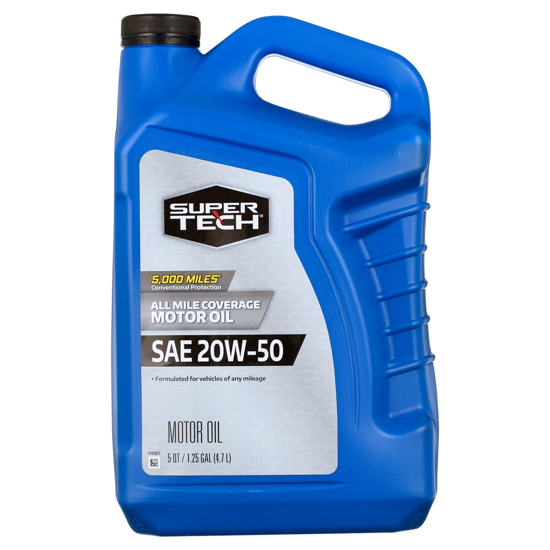

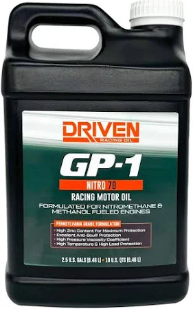

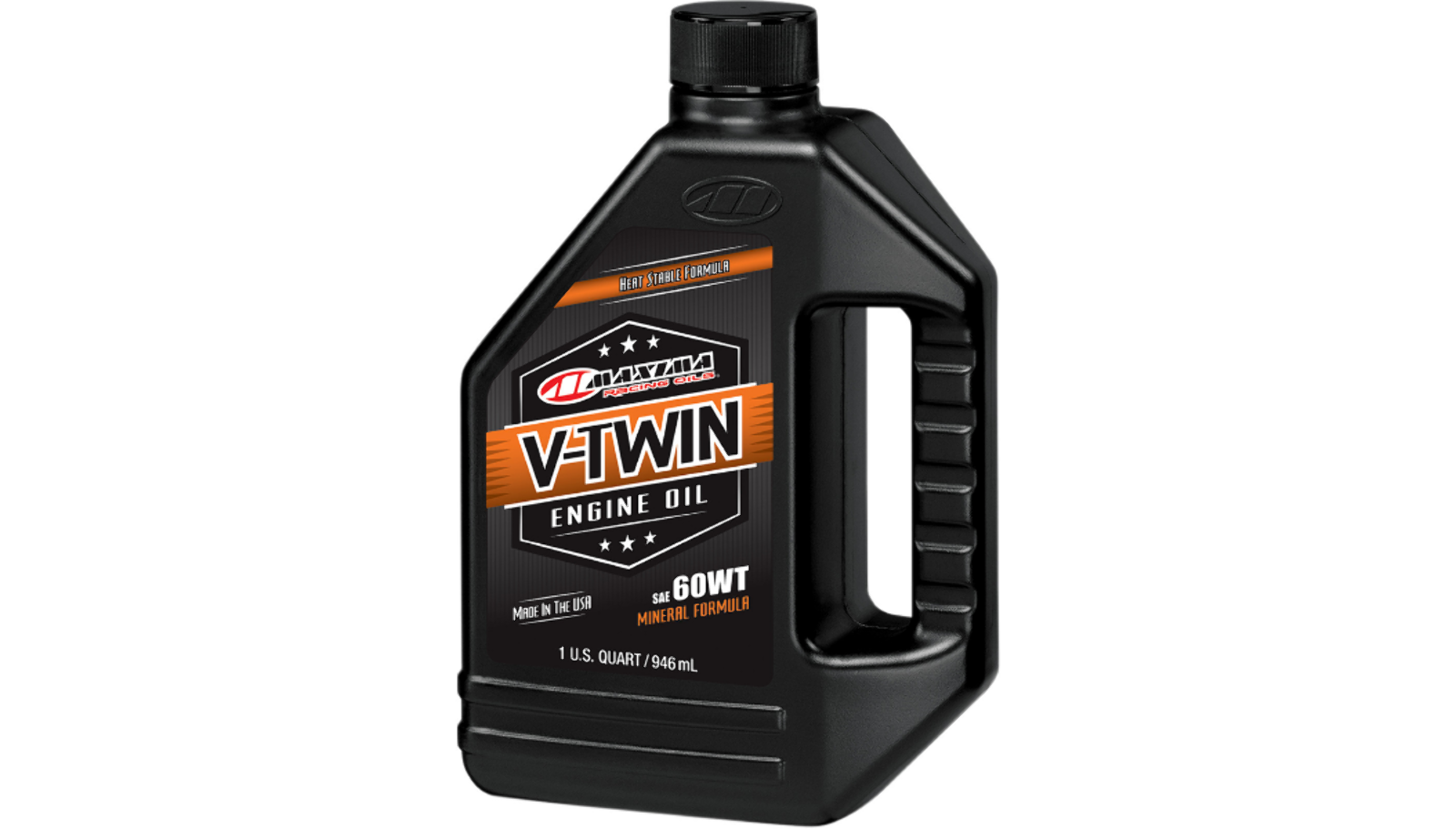

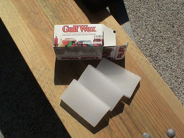

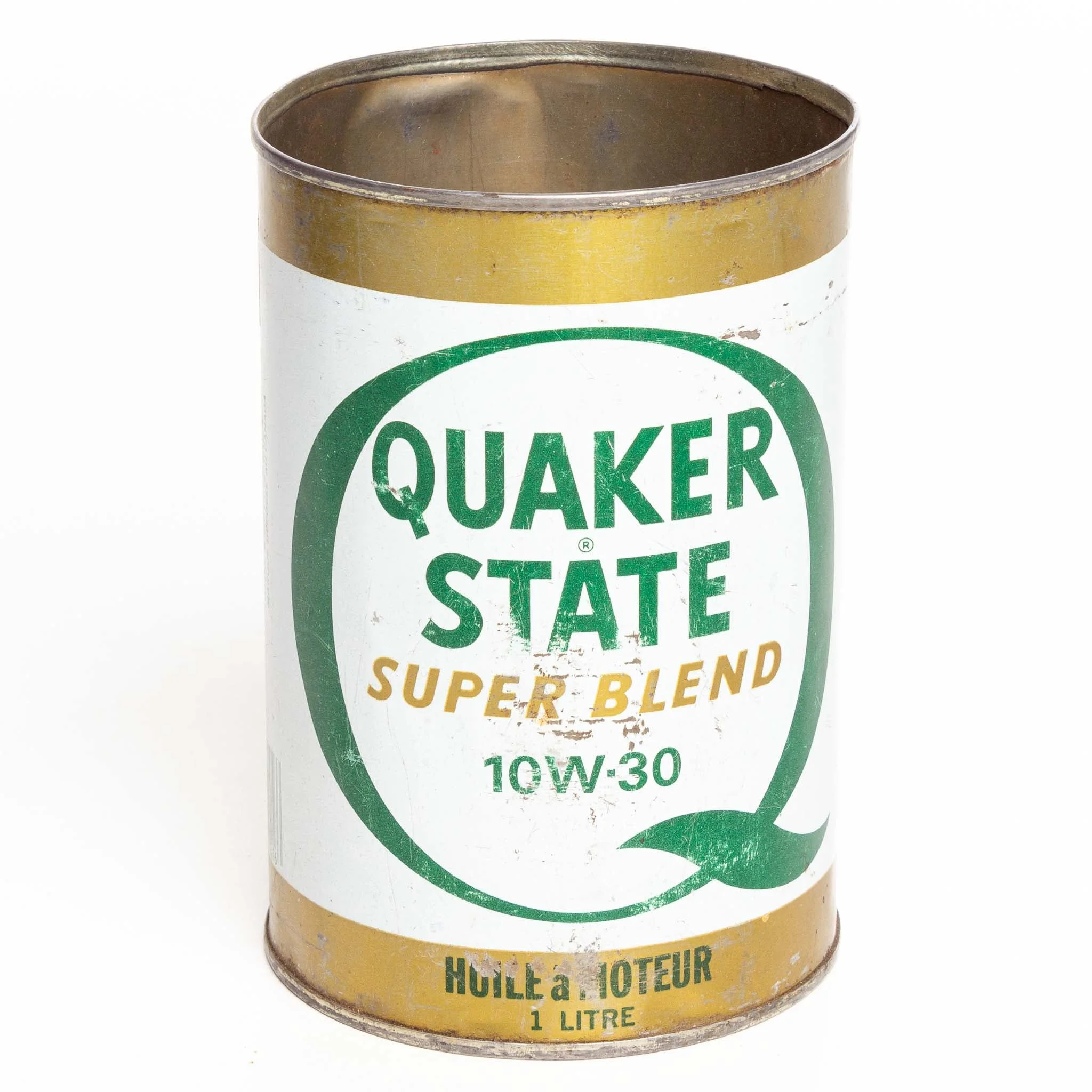

In the mean time, if its still running, a little thicker soup might nurse it along.
