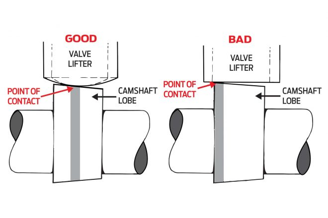

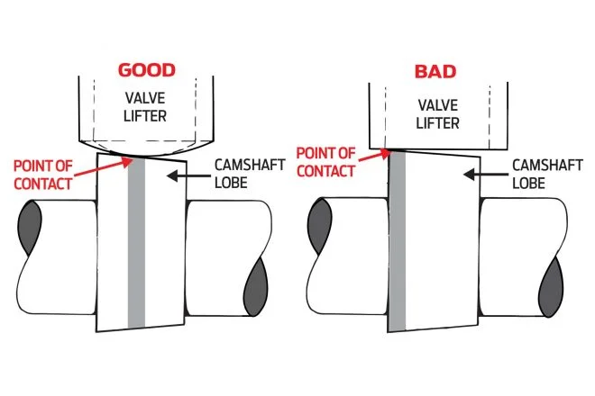

They aren't actually supposed to be totally flat
Not everyone understands/knows that. Obviously it's exaggerated in this image, but a slight conical/cam shape to the "flat tappet" lifter face, combined with an angle to the cam face, is what causes the lifter to rotate and slip on the cam surface, thus not wearing, at least not excessively. When these features are missing, or smashed out via excessive spring pressure, that's when trouble pops up and things quickly start wearing excessively and go sideways. (assuming proper materials used and hardening isn't an issue)

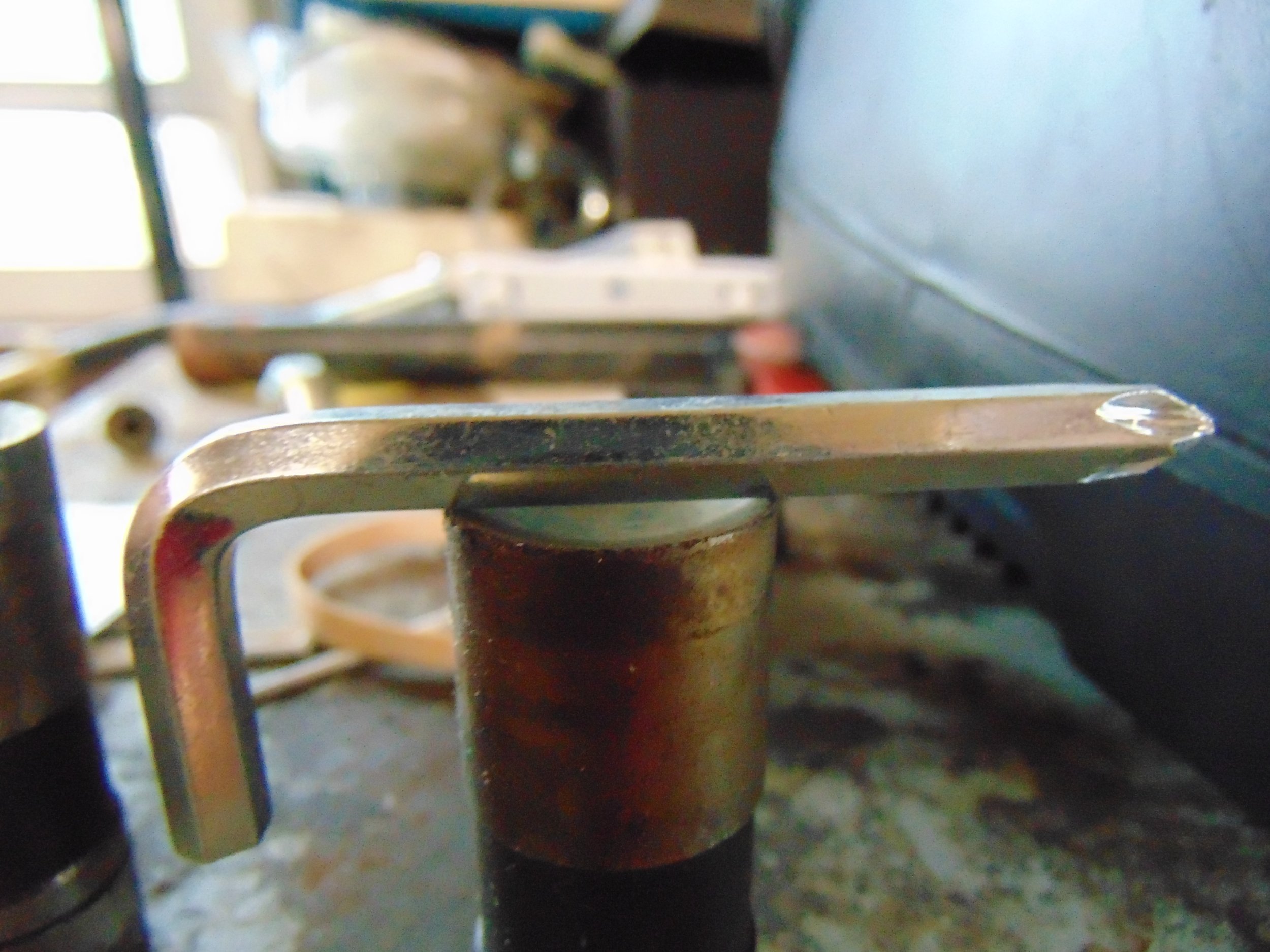

Speaking of that, I've had this ashtray floating around my bench for a while. That's probably getting close to 1/4" deep. I think she's good to return to service, but I'm no engine builder, so I'll defer to yalls wisdom. :sneaky:
