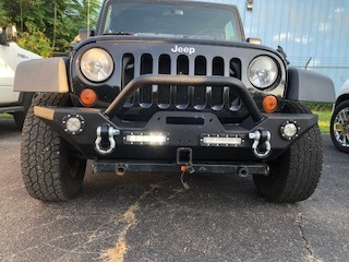

I love my EAG stuff. Totally underrated and very economical. I bought their front and rear bumpers, safari doors, tail light guards and grill inserts all for maybe 500? View attachment 45458View attachment 45459
Dude, aren't the plastic pieces on the loops supposed to be against the bumper, really helps with noise! I have the same bumper and love it! Also, 1/2 the cost. FYI someone ran into me, didn't hurt or scratch my bumper one bit, their car was a mess!

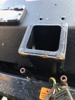

I bought both front and rear bumpers. Installation was easy, engineering is excellent. The look is exactly what I had hoped for. Product however is poor quality. Steel and Welds are good however finish on both is already suspect and starting to rust through. I forwarded pictures to EAG and asked for touch up paint and the response was return it and we will replace it. Not very practical since I cannot drive the jeep on the streets without bumpers. I have had both installed for 1 month and rust will be an issue, they have not even been through a winter with salt etc. The spare tire latch rattles on the rear bumper, I will try to fill the gaps with Silicone to eliminate the annoying noise. The front bumper has LED lights another plus since my version of jeep does not have fog lamps. 2 weeks after install the lights quit working. The power is there, there are issues with the LED, I suspect shipping damage as the bumper packaging was severely damaged showing lots of impact along the trip from CA to MI. Again same issue with lack of support from EAG. While the fit and look is good, I could not recommend this product to any of my Jeep friends as I will probably have to have the product removed and repainted a year from now. I am not sure what I am going to do about the lights as they are product specific.

Damn, thanks for the awesome feedback. I may give my EAG bumpers a good extra coat with some rust protective paint that I have laying around before winter hits as a precaution after seeing this (mine are different models, but better safe than sorry, right?).
I'm not terribly surprised that the lights went out since any LED lights at that price point aren't likely to be reliable, but if you can't get a replacement of the right size, that's definitely a problem. It's one thing to have some cheap lights that are practically free considering the low cost of the bumper in the first place, but it's another to be stuck with a spot in your bumper for lights that can't be replaced with something of better quality.

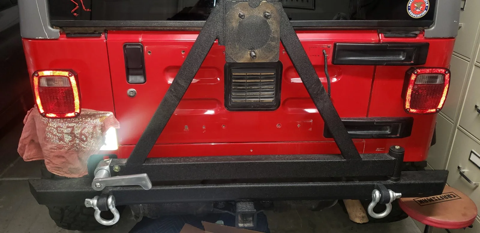

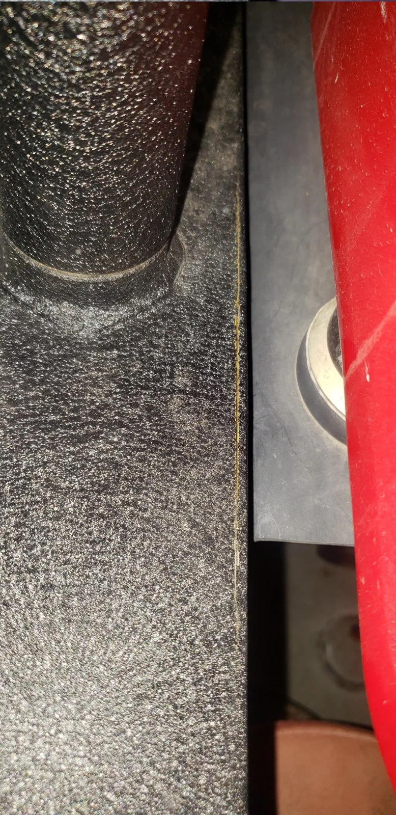

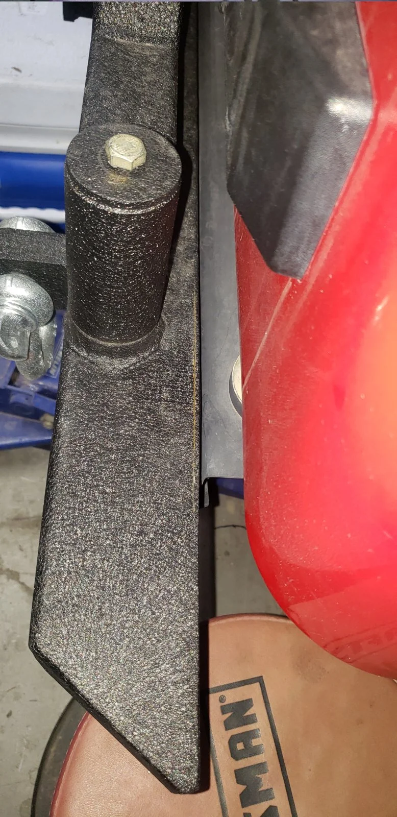

Like someone posted earlier, These Chinesium bumpers are most likely built by one mfg. and rebranded however you want. I bought one of the ebay special rear tire carrier bumpers in June, and it is already tearing itself apart.
Maybe 3000 miles and a little light fire road off-roading. The mounting face is seperating from the rest of the bumper near the tire rack pivot.
I've got a message in to the seller, but I'm guessing I'm S.O.L. and out $300.

The Chinese front bumpers are probably fine, but I wouldn't trust one of the shitty Chinese rear bumpers with the tire carrier on it, that's for sure.
I'd like to see pictures of yours and how it's failing.
I'll try to post some pics tomorrow.
