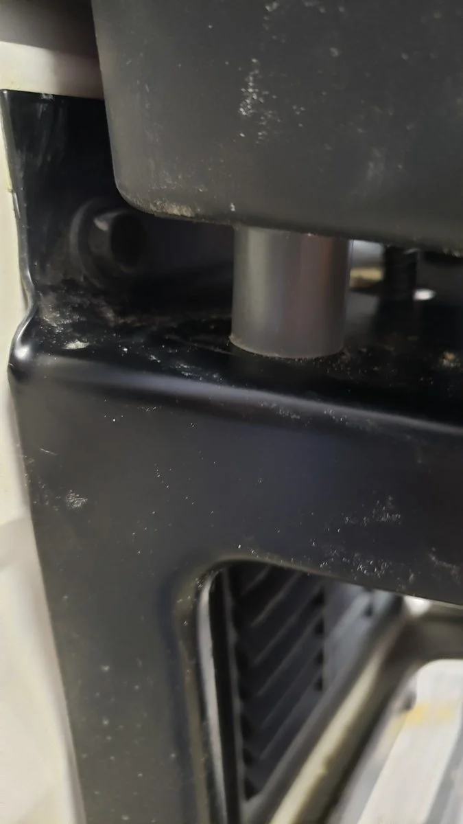

Just installed an EAG front bumper on my LJR. Once I realized the third top hole was NOT meant accommodate the swaybar bolt, the installation was very straight forward and took about an hour and half to hook up the winch also. I like the reinforcement mentioned in an earlier post. The welding appears to be second rate on my bumper. Given the price, appearance, D ring holders, D rings with rubber padding, and bolts for the install I am pleased with the purchase. 4 star rating that would have been a 5 with better welds.
The third hole certainly appeared to be for the sway bar bracket bolt on mine.
Reactions: Alex01
It looks like you had a plate to raise the bracket to that it would be the same height as the sway bar bracket tab. Did you also have a hole through the bracket to allow you to use the sway bar bracket bolt to act as a 3rd top bolt to hold the bumper at the top? It appears so in the photo.
You are correct on both accounts. We were a little confused until we found those plates in the bottom of the shipping container. Then it all made sense. Those plates were not in the instructions or parts list.
