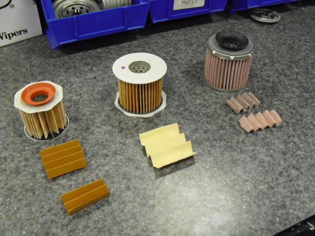

One early subject we brought up was Fram’s use of cardboard end caps. Gary (again, their Chief Engineer) was prepared and covered that subject thoroughly. He explained how the pleated filtration material, which is flexible, is glued to the caps and that the added flex of the end caps prevents the pleated filtration material from pulling loose. Here’s a good example that adds credence to Gary’s explanation… think flexible control arms vs. non-flexible control arms that are well known to tear control arm mounts away from what they are welded to. They use cardboard end caps for the Extra Guard and Tough Guard simply because it holds better than if it were to be glued to inflexible metal end caps.
The below photo I took shows Fram’s Extra Guard, Tough Guard, and Extended Guard filters.
Fram does use steel end caps on the Extended Guard oil filter but get away with that because the pleated filtration material used inside the Extended Guard is reinforced with a metal screen. That type of filter is designed for those who don’t change their filter as frequently as most of us here do. What you gain in filtration life, you lose in filtration efficiency though… the Extended Guard has a 97% filtration efficiency vs. a 99% filtration efficiency with their Tough Guard filter. Their lowest-cost Extra Guard has a 95% filtration efficiency rating.
How do they come up with that Efficiency rating? By adding very precise amounts of specific sizes (measured in microns) of laboratory-quality “dirt” (media) to the oil and then measuring what is left in the oil after the filtration process. The test equipment I saw gave direct readouts of the oil filter’s efficiency. You could actually see the various efficiencies of the filters being tested on lab equipment like below.
So for example, let's say they pour exactly 100 grams of 10 micron laboratory grade media into the oil to be filtered. After the test is complete, they measure how much of the 100 grams of the lab media is left. If 99 grams have been filtered out, the filter is said to have 99% efficiency.
You can also see the nitrile anti-drainback valve on top of the Extra Guard filter on the left and the silicone anti-drainback valve on the right in the Extended Guard. The center filter is the Tough Guard and it gets the silicone anti-drainback valve.
Nitrile is not as desirable to use in this job as silicone is but keep in mind Fram only use Nitrile in their entry-level lowest cost Extra Guard filter. Nitrile only starts to harden at around 258 degrees so for most conditions, it is ok. However, silicone is good to at least 400 degrees. For that reason, I personally would stick with an oil filter that uses a silicone anti-drainback valve. With Fram, that includes the Tough Guard, Extended Guard, and High Mileage filters.
But just so you know, I learned that even their nitrile anti-drain back valves are tested to over one million cycles.

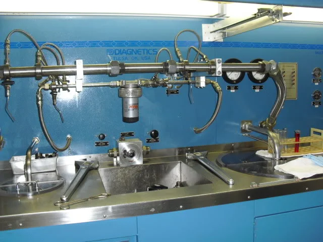

This is where, into the vat on the right, lab-grade “dirt” (various micron sizes like 4-20) is added and tested to see how much the filter can filter out. Out of sight to the right is the computer that runs the test and shows the filter’s efficiency directly on a digital readout.
It was very interesting to note that Fram’s Tough Guard filter, which has a 99% filtration efficiency, was actually outperforming and out-filtering some far more expensive filters from Fram’s competitors. The R&D facility had a large assortment of the competition’s filters there being tested. Fram continually compares their filters against the competition which is very smart.

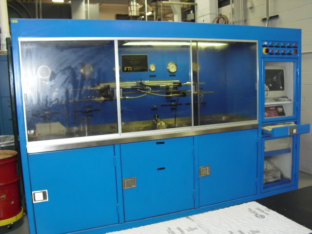

One of the more interesting series of tests were pressure tests that show how well the filter can contain the pressures oil filters can be subjected to. This particular piece of test equipment continually ups the oil pressure until the oil filter ruptures. We saw several cycles of tests and as I recall, the filters were withstanding 340+ psi of pressure before they blew out.
You could see the can swelling up as the pressure increased, it was pretty cool. The blowout was pretty impressive, it made you jump.

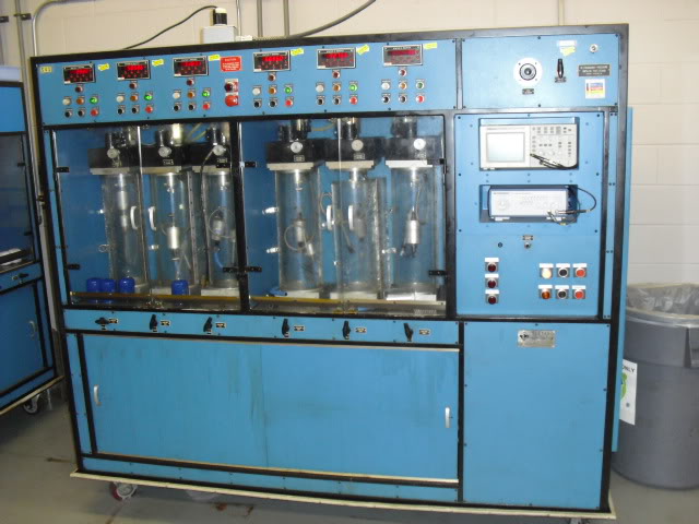

The below test apparatus was a pressure cycling machine that continually and repeatedly cycles the oil pressure 0-300+ psi over one million times. Each location has a digital readout over the top of each filter and I could see they were already over the million cycle mark. The pressure cycles made the filter cans swell in and out… spooky appearing, kind of like a row of beating hearts.

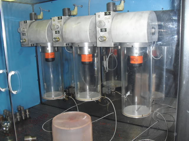

This is their Shake & Bake machine which violently shakes and vibrates oil filters as they are repeatedly cycled with low and high oil pressures.
Oil pressures vary widely on our vehicles. It isn’t unusual to see 0-125 psi spikes, especially on cold days when the oil’s viscosity is thick. Other testing systems cycle the oil filters from -60 to >300f degrees.
