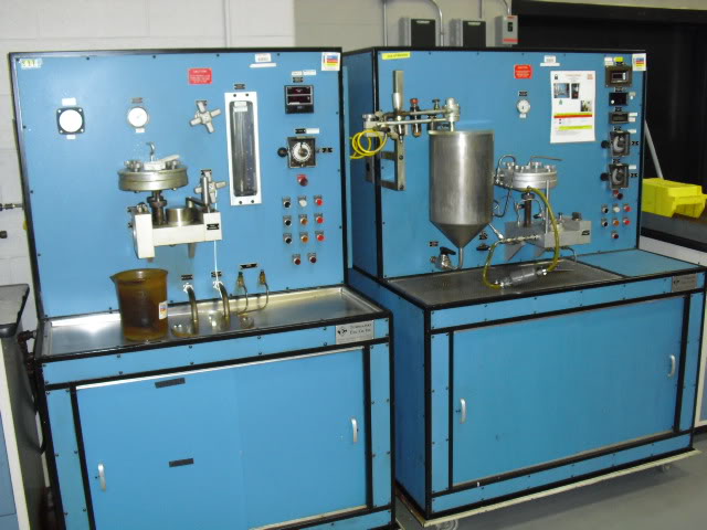

This is where, into the vat on the right, lab-grade “dirt” (various micron sizes like 4-20) is added and tested to see how much the filter can filter out. Out of sight to the right is the computer that runs the test and shows the filter’s efficiency directly on a digital readout.
It was very interesting to note that Fram’s Tough Guard filter, which has a 99% filtration efficiency, was actually outperforming and out-filtering some far more expensive filters from Fram’s competitors. The R&D facility had a large assortment of the competition’s filters there being tested. Fram continually compares their filters against the competition which is very smart.

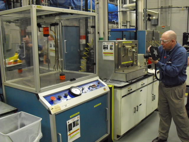

One of the more interesting series of tests were pressure tests that show how well the filter can contain the pressures oil filters can be subjected to. This particular piece of test equipment continually ups the oil pressure until the oil filter ruptures. We saw several cycles of tests and as I recall, the filterswere withstanding 340+ psi of pressure before they blew out.
You could see the can swelling up as the pressure increased, it was pretty cool. The blowout was pretty impressive, it made you jump.

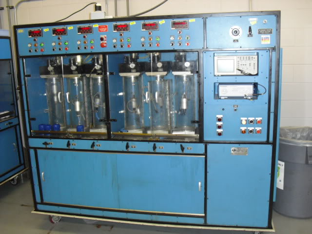

The below test apparatus was a pressure cycling machine that continually and repeatedly cycles the oilpressure 0-300+ psi over one million times. Each location has a digital readout over the top of each filter and I could see they were already over the million cycle mark. The pressure cycles made the filtercans swell in and out… spooky appearing, kind of like a row of beating hearts.

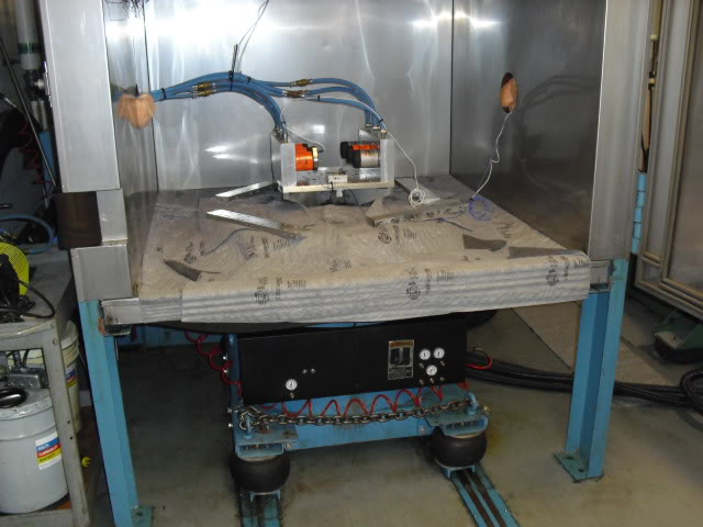

This is their Shake & Bake machine which violently shakes and vibrates oil filters as they are repeatedly cycled with low and high oil pressures.
Oil pressures vary widely on our vehicles. It isn’t unusual to see 0-125 psi spikes, especially on cold days when the oil’s viscosity is thick. Other testing systems cycle the oil filters from -60 to >300f degrees.

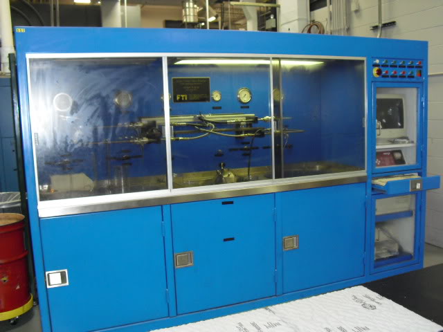

There are a whole lot of various lab testing systems scattered throughout the facility and I honestly don’t know what many of them do, we didn’t have time to stop to watch each one of them work or have their functions explained.
But for your viewing pleasure, here are some of Fram’s other testing systems we saw as we were shown around.

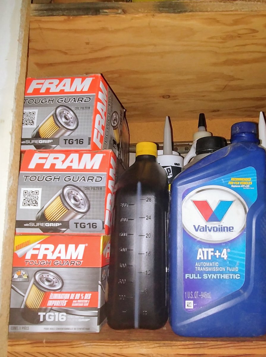

In closing, I did something 4 weeks ago that would have been unthinkable to me only a few months ago. My wife’s pride and joy, her Lexus LS-430, needed an oil change. It got its usual 5 quarts of 5W-30 Valvoline engine oil but this time, I installed a Fram Tough Guard oil filter. That crow I ate at the cash register that day while buying the Fram oil filter wasn’t the best I have tasted over the years. That isn’t to say I’ll only run Fram oil filters from now on but I will say I would happily run their Tough Guard oil filter in any of my vehicles.
To this day I run a Fram Tough Guard in my Jeep and my wife's Lexus.
