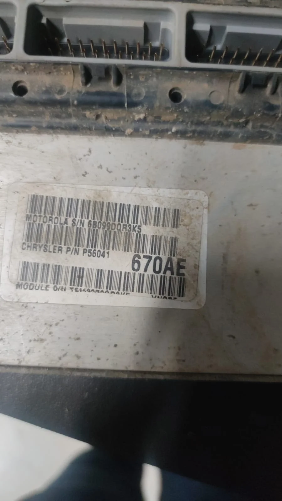

Where can I find a table to check the compatibility of the ECUs found for my tj 2001 manual?
Can anyone help me find one?
This is my ecu

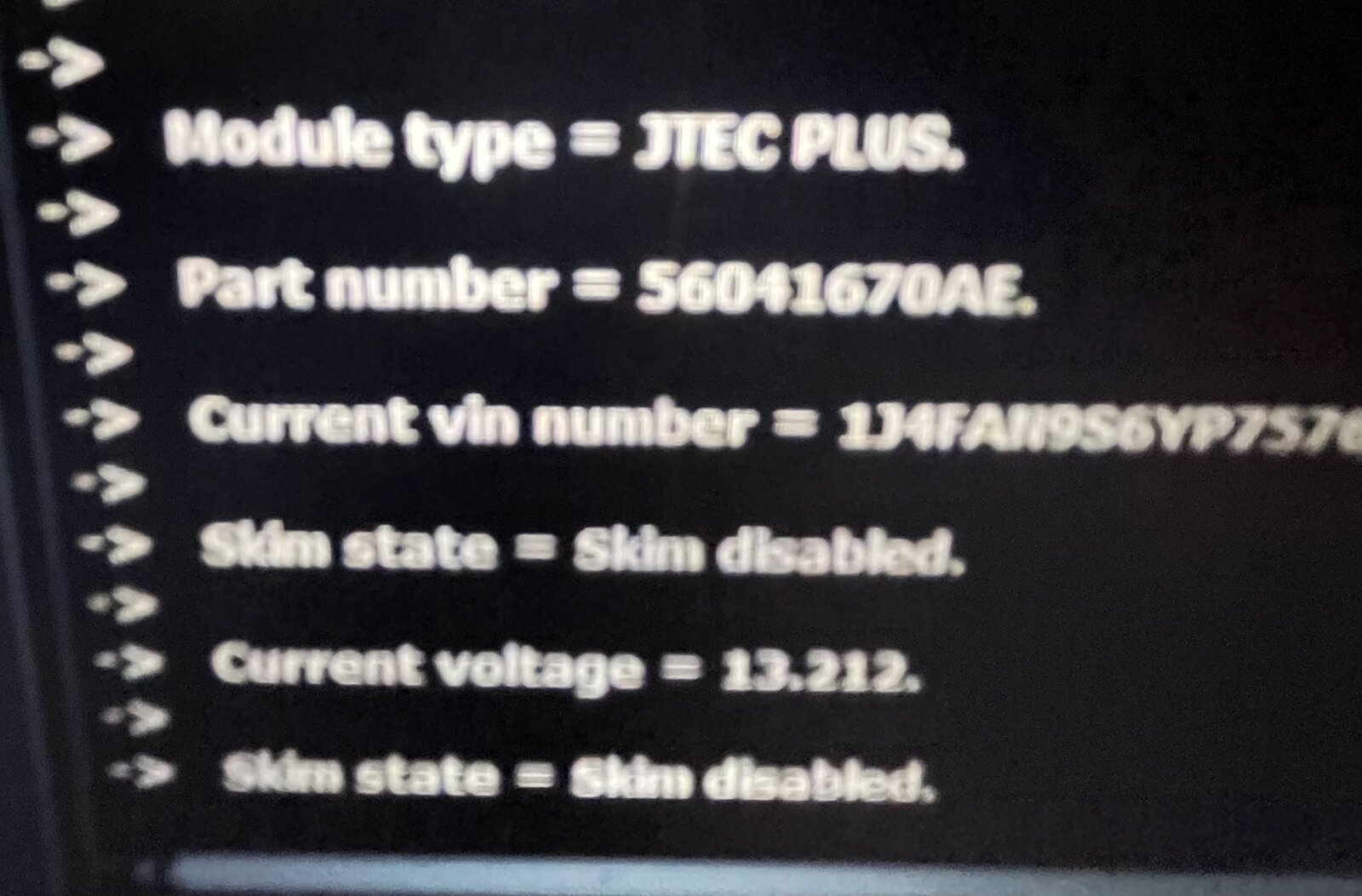

@silvio Does your ECM have communication? If I do not have it I can clone yours as long as it has comm.

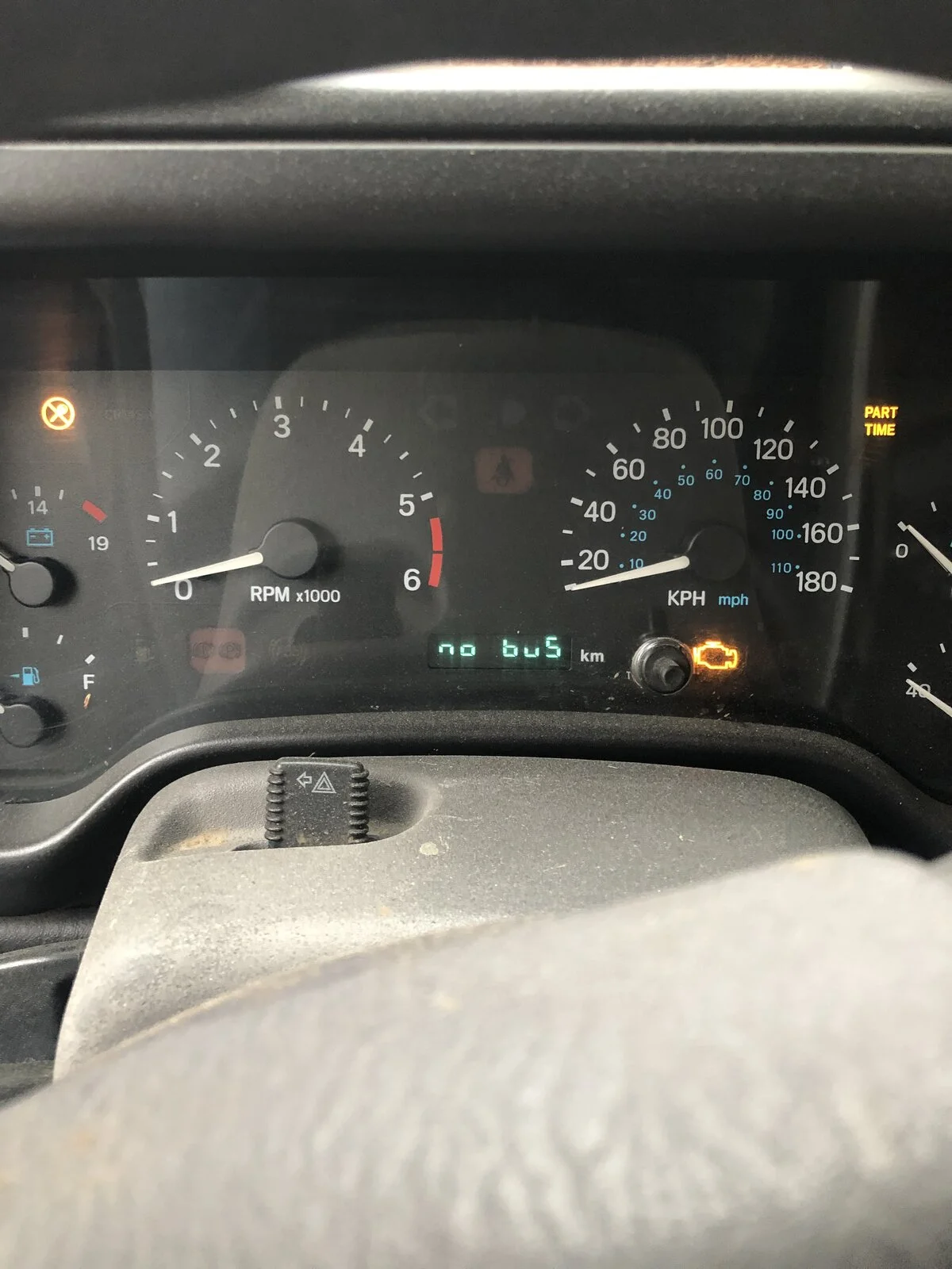

No!!!😭

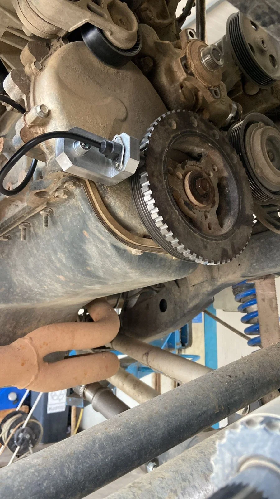

I changed the odometer probe and the wires making contact made me turn off the jeep then solved ... I went out in the mountains and suddenly it turned off

alla fine ho risolto montando una centralina racing e apportando modifiche per lasciare il cruscotto originale e per semplificare l'impianto elettrico al motore
Vorrei ringraziare wranglerfix per il supporto e la disponibilità 🙏
