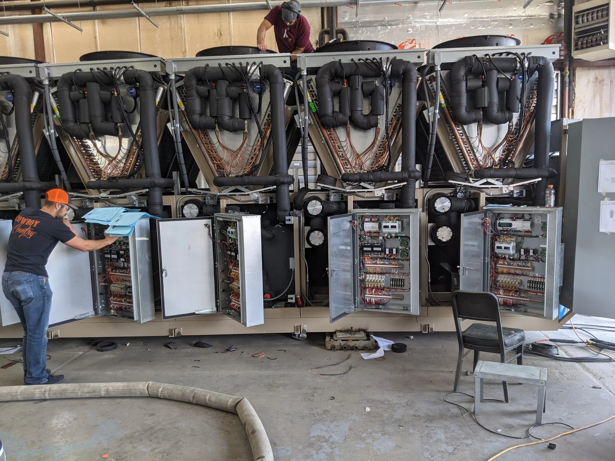

Air source heat pumps are undeniably more efficient than direct heat but they do have the issue that the lower ambient you want to run them in, the larger the outdoor coil has to be and there's a point it prices you out. The ones we build will run just fine down below 0 but they're industrial and at minimum about 10x the size you'd ever put on a typical house and probably 20x or more the price...
(Each module in this photo is 35 tons)

Is that a gas fueled heater hanging up in the corner of a shop building massive heat pumps? :unsure:
