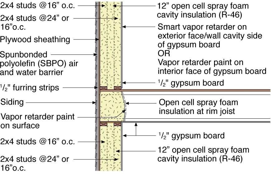

How are your walls built to get R45?
That's an insanely small heat load for that temperature difference.
I would guess some combination of insulated sheathing on top of structural sheathing with insulation in the wall cavities. Or maybe double stud exterior walls, essentially two parallel framed walls with space between them, the void being filled with insulation. Everything, including OSB, has an R value, though it may be negligible in and of itself. While I've never personally seen a wall system with R values that high (not common in the Mid-Atlantic), I assume it's possible with the right materials.
Edit, here's an example:
I would guess some combination of insulated sheathing on top of structural sheathing with insulation in the wall cavities. Or maybe double stud exterior walls, essentially two parallel framed walls with space between them, the void being filled with insulation. Everything, including OSB, has an R value, though it may be negligible in and of itself. While I've never seen a wall system with R values that high, I assume it's possible with the right materials.
Yeah, I'm mostly thinking about how thick they must be. Even closed cell foam is R7 per inch, open cell and fiberglass is about half that, so depending on what insulation tech was available in the 80s those walls would have to be a solid foot, which then makes me think about unconventional construction methods like structural foam, concrete, etc.
We built some what conventional , just way over kill , 2 X 12" Douglas Fir framing , R - 38 fiberglass , thin exterior insulating board under 15/32 nds 5 ply Doug fir plywood. and a continuous 6 mil. poly vapor barrier under 1/2 " sheetrock. I forget the exact value , but air film boundary layers are also figured in.

Nowadays, you can actually get R12 out of insulated structural sheathing alone...Huber makes an R12 version of their Zip-R sheathing. I've done a few buildings with this material.
ICF is another way.
https://newhousebuilder.com/insulated-concrete-forms/
We looked at these when we built our new camp. Since the camp would not be heated 27/7, only when in use, we only did ICF for the basement walls. We were under the assumption that the thermal mass was too great to heat quickly. If you went to camp on a Friday, it would take all weekend to get up to temperature. Once heated, it wouldn't take a lot to keep at temperature.
