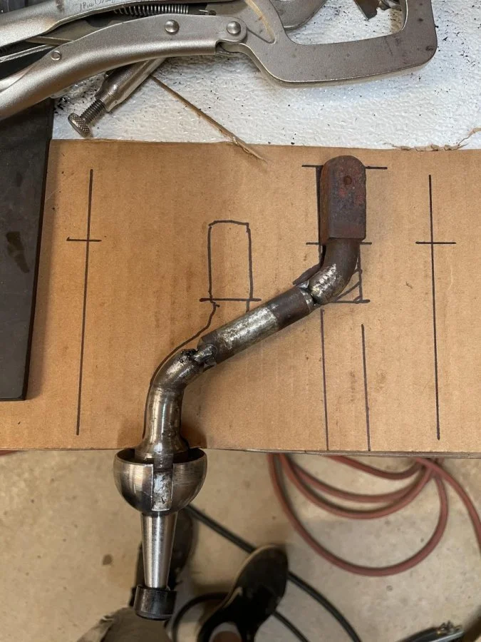

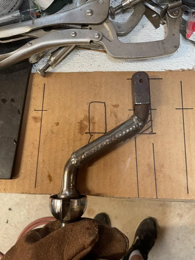

This is a little different but to give you an idea, here is a shifter modified for a V-8 swap where the transmission is moved forward about 2"

It looks like @Wildman 's post demonstrates what I mean by sleave, welding a tube cut in half over the extension once it's welded in.
