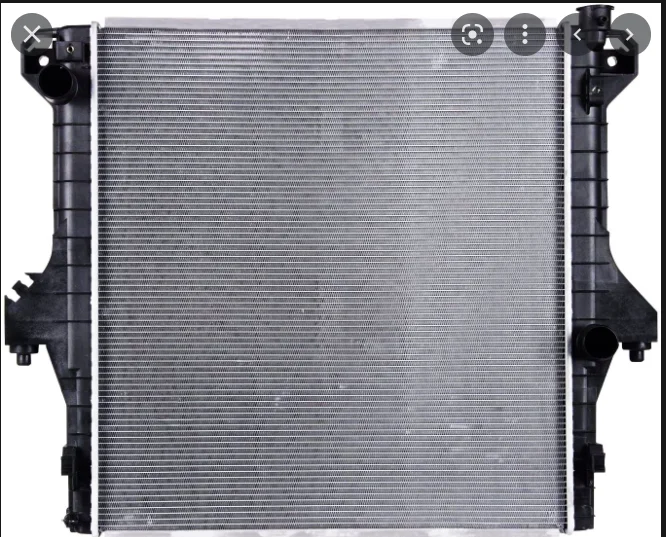

When you can, I suspect you'll know that answer and it likely isn't due to being worked hard. You need to get your head around the fact that we are working the TJ cooling system hard and it is awesome the parts last as long as they do and stop dragging low stressed stuff into it like that matters. The radiator in my Dodge Diesel is fine, it will be fine, it doesn't get worked very hard. I drove the damn thing for 2 years before I finally got it hot enough towing a heavy load up a steep enough grade long enough for the fan clutch to finally kick in and even then I was more than 1/2 way up the Cajon Pass.
2 years and 50,000 miles before the fan clutch let me know I even had one. You can't get a TJ to the end of the block practically before the fan clutch kicks in. One cooling system is stressed a bunch, one isn't. It doesn't take a genius to figure out which one is going to last longer. And yes, my Dodge radiator is made the same way. Plastic tanks and an aluminum core.

Ok, fine. Point taken. However, I sure would think that it would be possible to engineer a radiator that would last, even under these "severe" conditions.

They do last, it is common to go more than 100,000 miles. At that mileage and the cost at the time, that is about a tenth of a cent per mile. That is 1/10 what the average stockish size set of tires costs you.
One can be engineered. I don't know if I can guarantee it at this point and I suspect it will outlast the OEM radiator, but I'm not willing to spend a 1000 bucks to find out.
