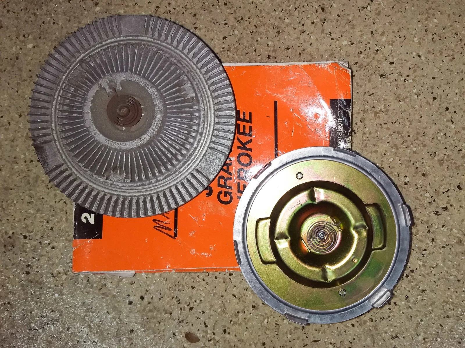

Here's the new Hayden 2625 for comparison next to the old fan clutch, front and back. FWIW, I read somewhere that you shouldn't put these things flat horizontally if you're planning on using them again (other than before initial use/shipment, of course):
76614
76615

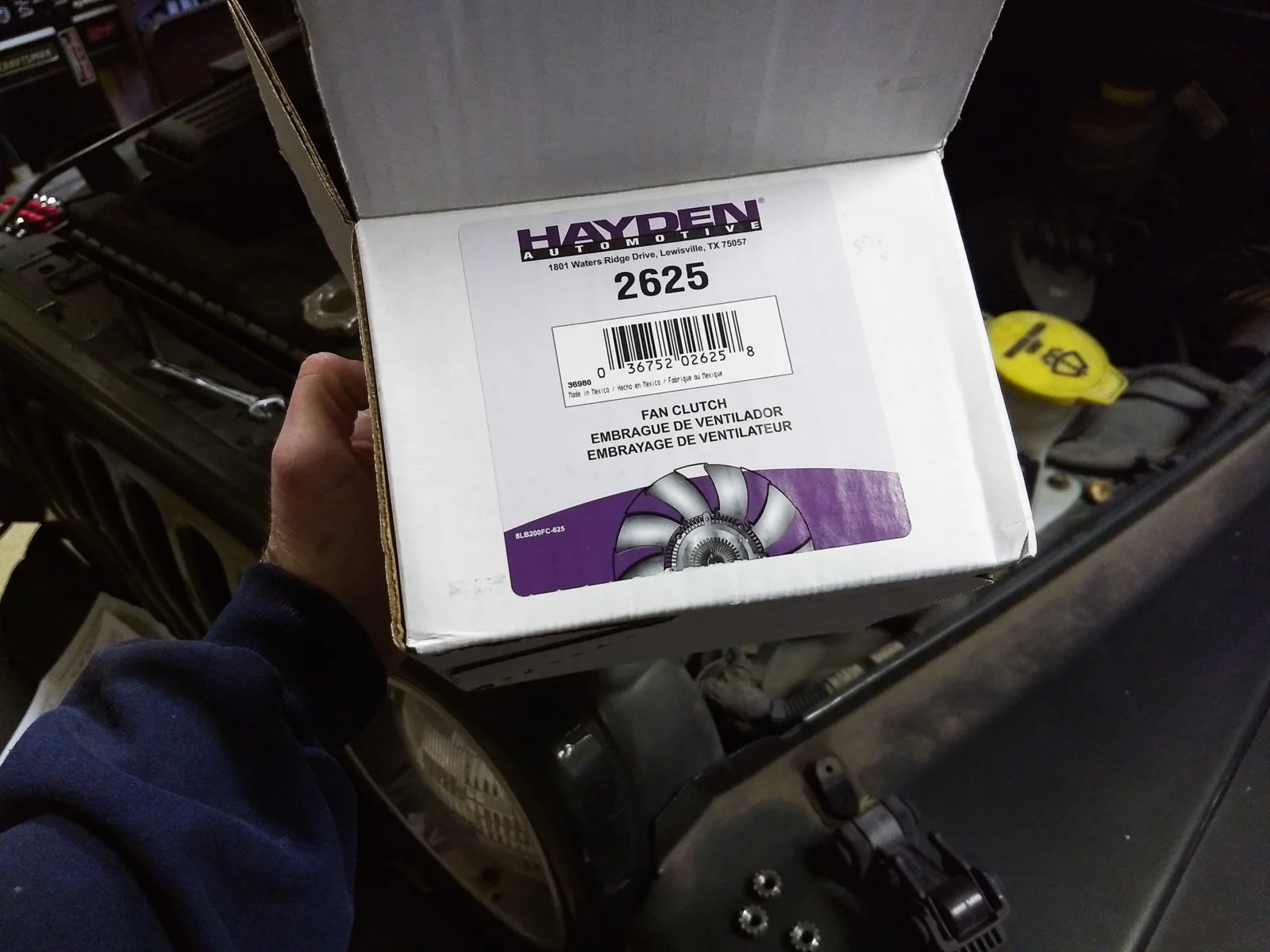

Amazon stocks these (alongside the heavy duty one that was recommended earlier in the thread):
76616

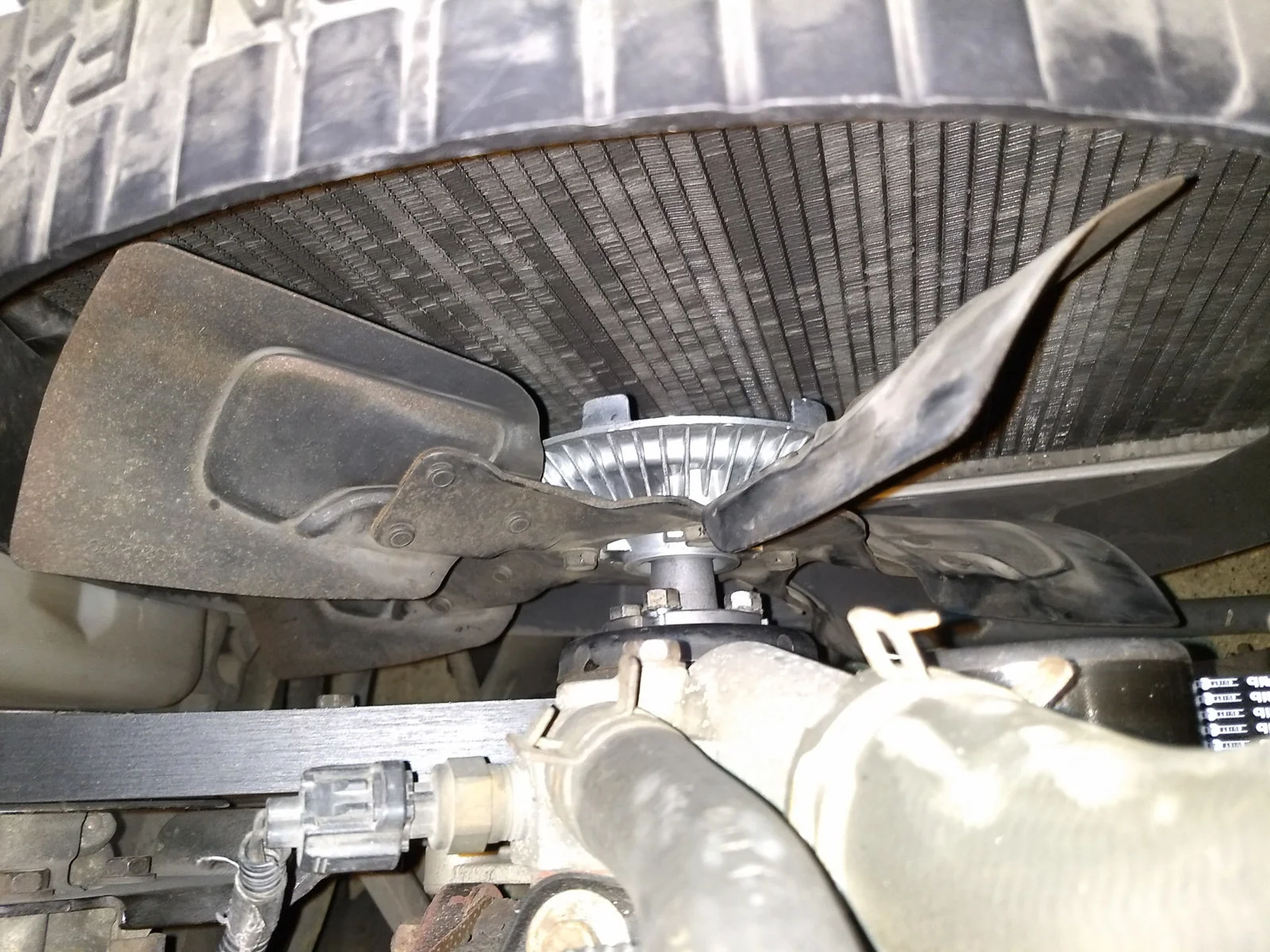

Installed:
76617
That's good stuff, and I'm glad to hear it seems to be operating normally so far. I like the idea of the quieter option as long as it keeps everything cool. Thanks.
