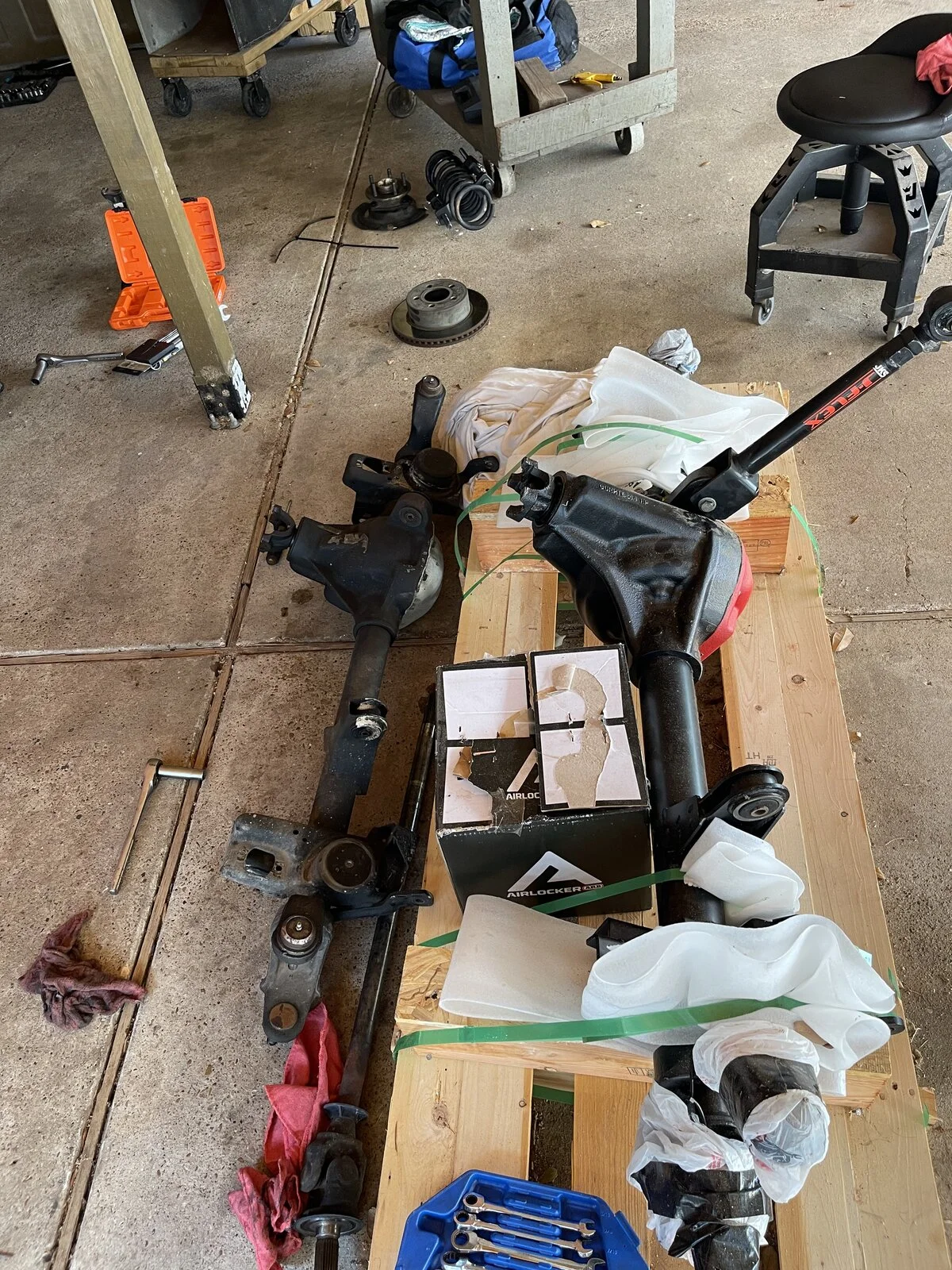

I had bought a 36mm socket from Amazon and when I opened the box in was 56mm or something like that, so off to O’Reilly, an hour there and back.. got the old knuckles off, sandblasted , painted with self etching primer, then silver…. I had Jack stands under the frame and the Dana 30 while removing the shocks and brakes, axles, etc… when it was time to lower the axle housing to pull the springs, it drooped to the ground and the spring were still in their seats!!! Funny, I don’t remember them being that long when we installed them 2 years ago!!! (ZJ with acos) ….. off to O’Reilly….. 2 spring compressors later the Dana 30! Was out. . At this point we ate some lunch and had a couple beers and Gatorade…. It was about 98* with 100% humidity, been raining on and off all day. All of the above turned out to be the EZ part.. did I mention beer!!!, the heat? Plus, I’m old!!!
As you can see from the above picture Currie’s 44 is much bigger than the tiny 30, as it turns out, that mean’s heavier too. A LOT heavier!!! Getting it under the Jeep and on Jack stands somewhat near a useful position took some effort, so another break was in order…… hurray beer!!!!
It turns out the threaded holes in the Currie housing for the bump stops are much larger than the bolts I used to install them on my Dana 30, ….. off to the hardware store….. hit the liquor store too…. The rest was mostly smooth sailing except where the track bar bolts to the axle. The opening behind the mount where you access to get the nut started, was too small . It took some work with a cutoff wheel and die grinder to be able to get the nut and a box wrench in there…

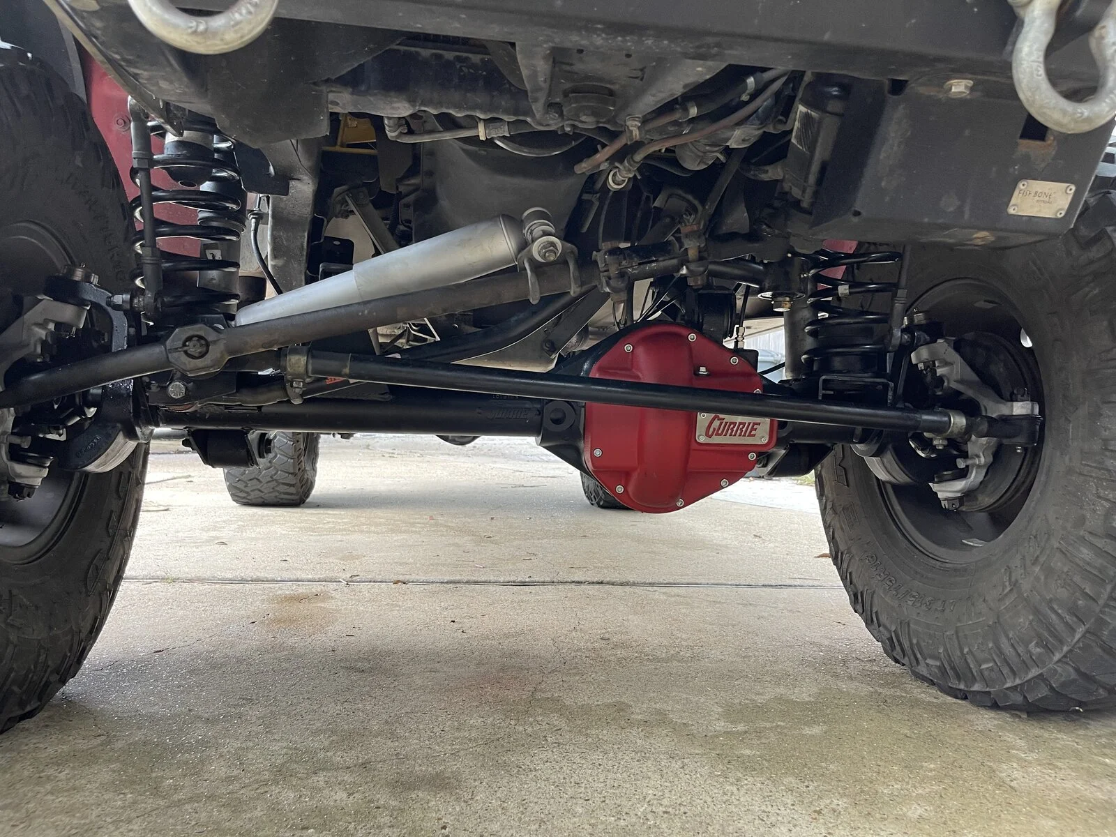

Nice axle, you can't beat a Currie. It's filled with a conventional gear lube, not a synthetic, right?
Yes Sir! When I bought the axle, I went ahead and got a couple qts from Currie. I’ll use that oil when I. Change it at 500 miles. I picked up a couple qts of castrol conventional on my trip to get the spring compressors, that’s what’s in it now.
