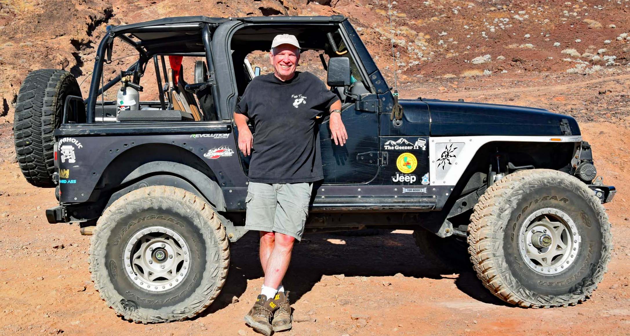

The tipping point varies depending on too many factors to say it will tip at x degrees. Speed, tire pressure, traction, tire traction, center-of-gravity point, track-width, wheel width, if you're also turning and which direction are you turning, etc. I'd also say 6" of suspension lift is more than is needed for 35" tires and unnecessarily raises your COG (center of gravity) making it more prone to tip than would be with a slightly lower suspension lift height.
This is mine with nothing more than a 4" suspension lift plus a 1" body lift with 35's. That suspension lift and body lift combination also gives a lower COG than you'd have with a 5" suspension lift and no body lift and way less than if it had a 6" suspension lift.

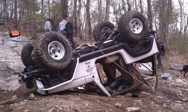

You could measure it as you have described, and that would be a fun thing to do. But at the end if the day the measurement will mean nothing. You could be on the trail, 10 degrees on the safe side of your roll measurement - and roll right over. As Jerry said above, it is more about the specific situation.
A better way to know your tipping point is to get out and wheel it. Push the rig and pay close attention. That is the best way to learn the rigs capabilities and limitations.
I’ve rolled my rig over backwards - so I’m talking from experience (Or, ahhh, lack thereof…😬)

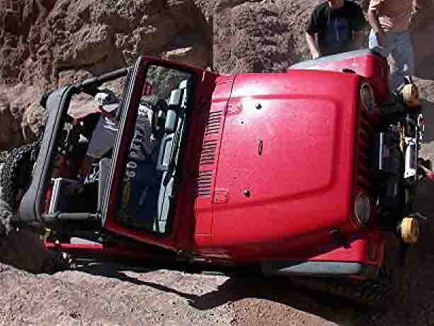

This is one time when I was really at an angle with 4" plus 1" body lift with 35's in my previous TJ but it still didn't flop onto its side, I was able to drive out of it.

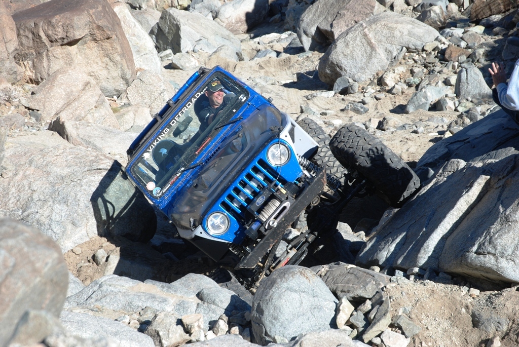

And the guy (Jon) in the blue TJ didn't tip either.

This is one time when I was really at an angle with 4" plus 1" body lift with 35's in my previous TJ but it still didn't flop onto its side, I was able to drive out of it. And the guy in the blue TJ didn't tip either.
It's pretty wild how big of an angle it feels when realistically you aren't very close to tipping. I replied to Nashvilles post and was saying about going up a hill diagonally and having the one wheel lift off. Definitely does take some getting used to the angles, but those pictures you put on are crazy. And to think a lot of people worry about their vehicle rolling just going around a corner😄
