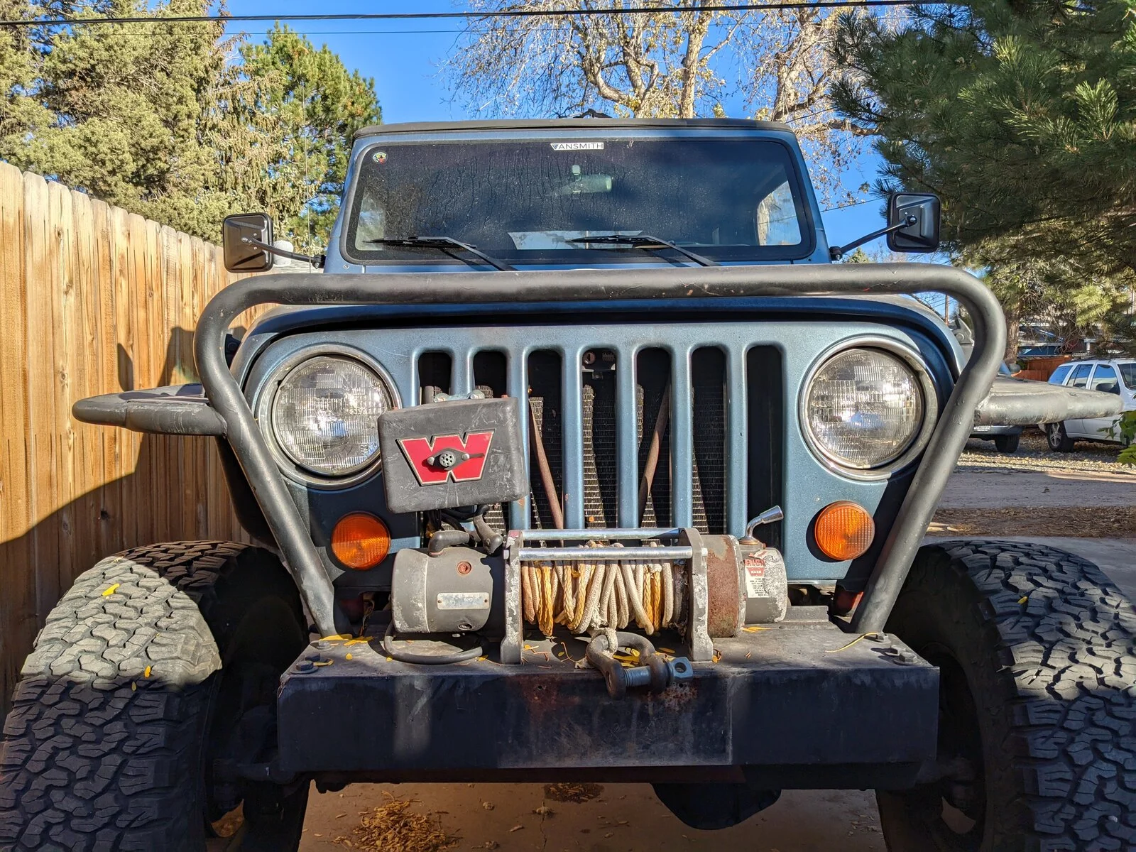

- Warn M8000 winch w/synthetic rope (which badly needs to be replaced)
- Stubby front bumper, hood hoop, and flat fenders

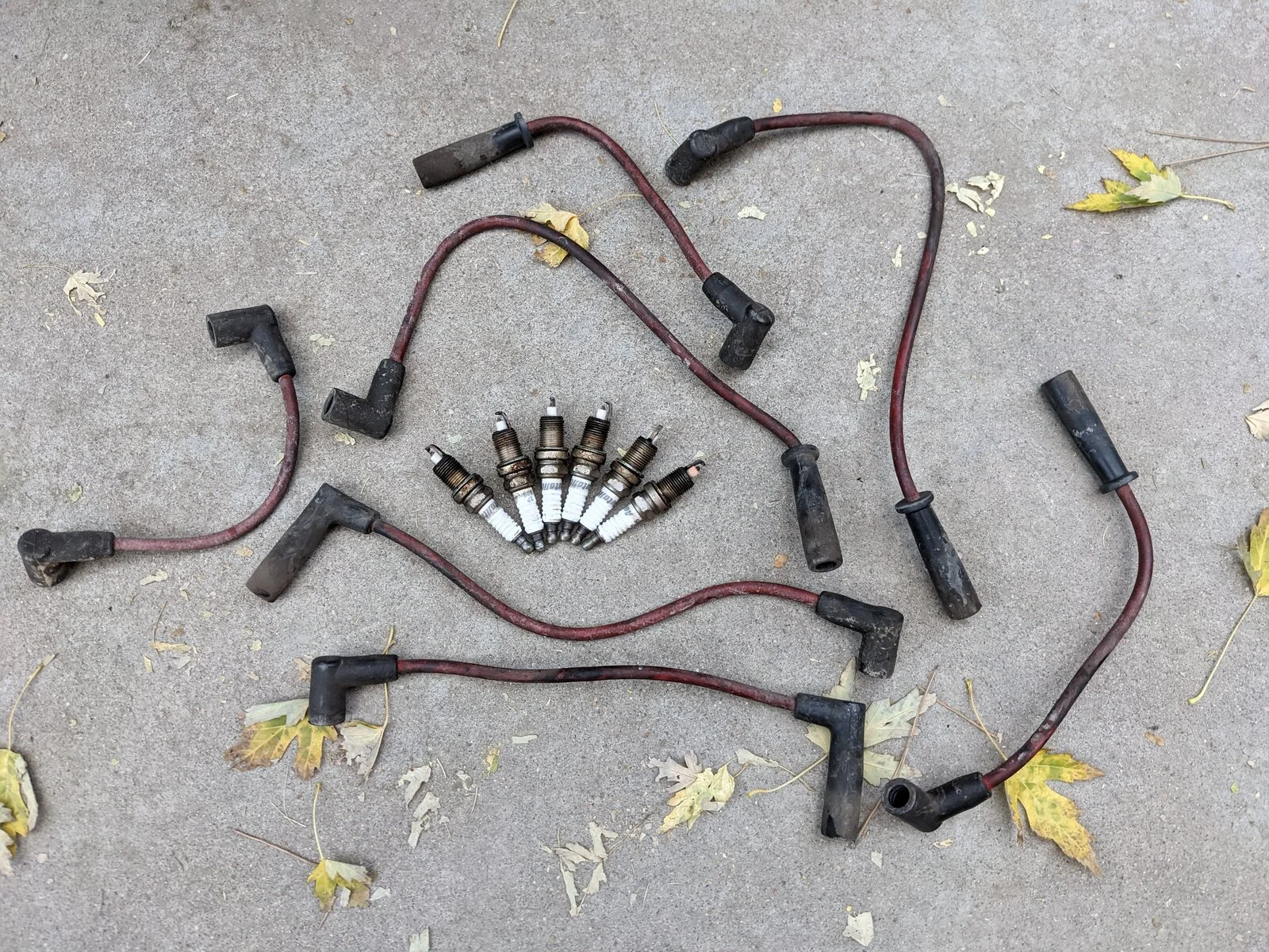

I'm starting to hunt down a lot of loose wires that are unattached in either the cabin or the engine bay or both sides. Not sure how well it was maintained by the PO and was definitely told some lies with the sale. Biggest lie perhaps was that it had brand new spark plugs and all fluids were changed. Haven't got around to the fluids yet but the spark plugs are definitely not new.

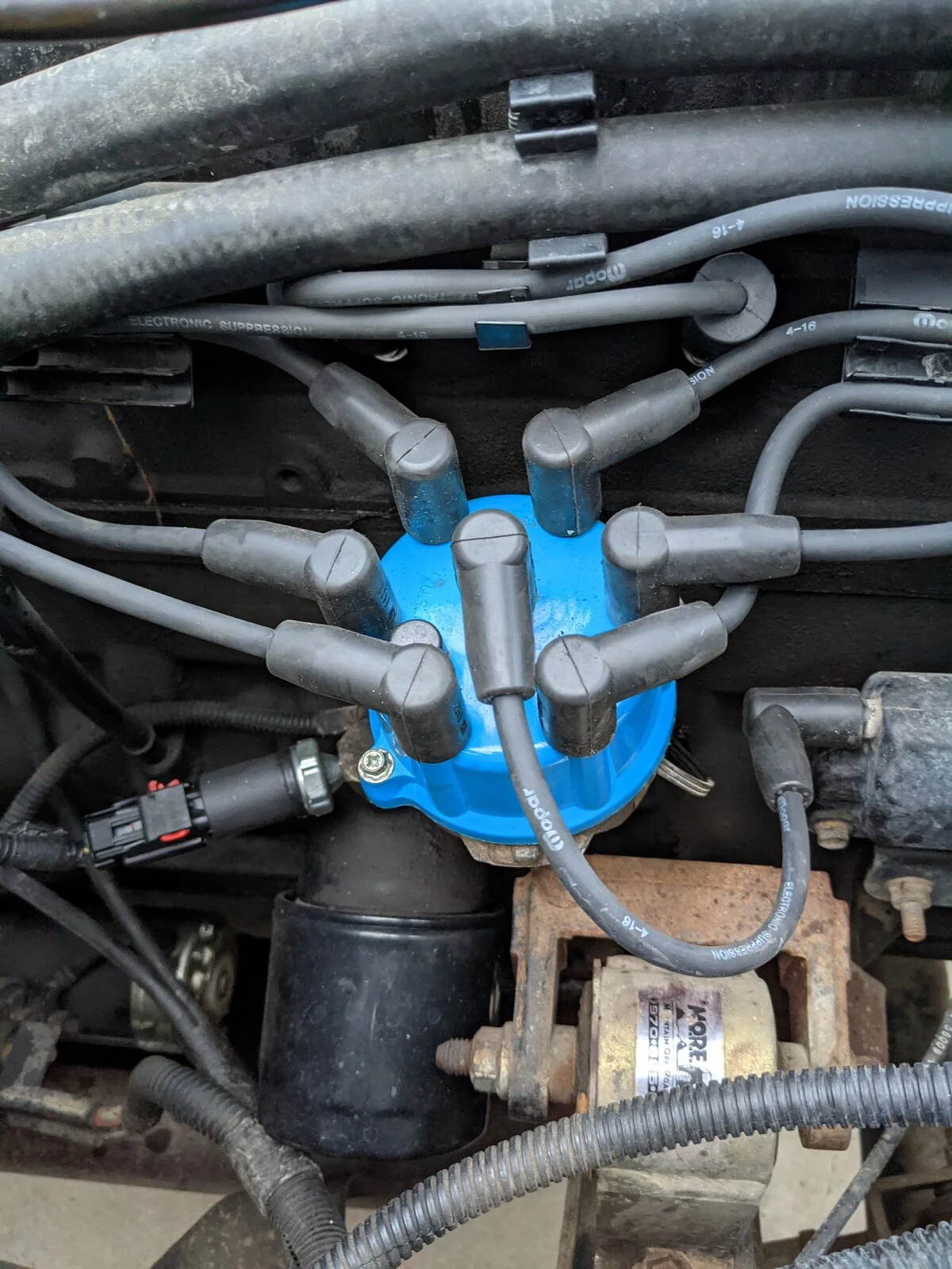

I changed the plugs out for some Autolite XP985s and put some Mopar spark plug wires on (I need to clean up the wiring, I followed the previous wire lines and it doesn't look very neat). Waiting on the distributor cap and distributor to ship and put them in but they look to be in reasonably good shape.

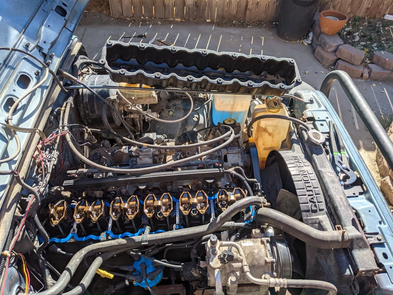

I started addressing the leaks from the top down with the oil sender and valve cover gasket. While doing the valve cover gasket I also replaced the PCV and.. that other elbow behind it + the grommets as they were pretty much shot and hard as rocks. I hosed everything down and I'll wait to see if I need to replace the oil pan gasket + RMS.

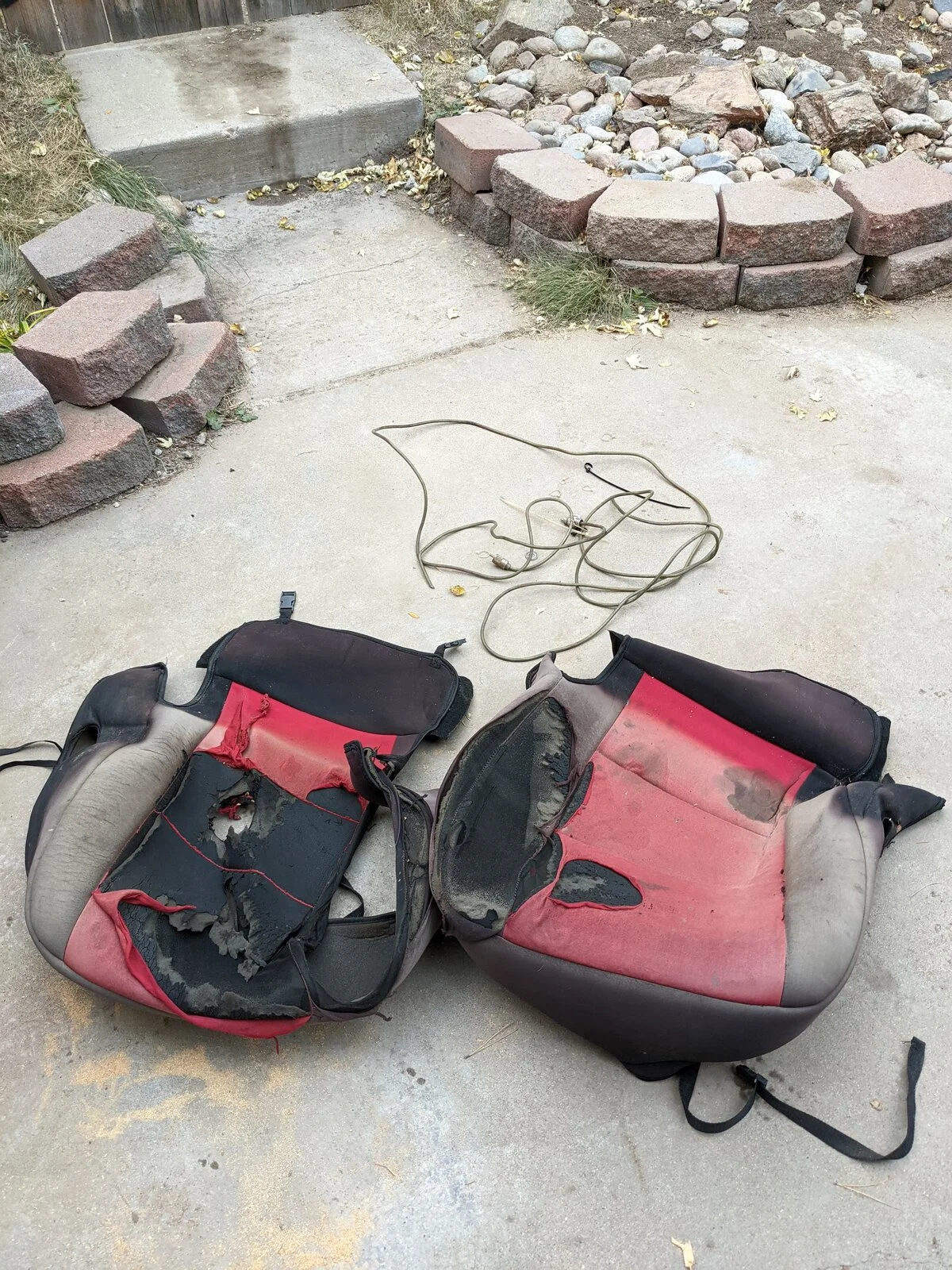

You can see the little rats nest of wiring in the left of that photo that I'll have to dissect. Attached below was one wire I was able to remove that was completely unattached in both the cabin and engine bay. I've counted at least 4 more wires that are unattached that I'll have to hunt down. I also started to clean up the interior a little bit. The seat covers were completely torn, faded, and.. smelly.

- Figure out what to do with the exhaust. The last exhaust hanger had broken when I purchased it but it was unknown how long it was broken for. Unfortunately upon further inspection the exhaust has been rubbing/banging all over the rear upper control arm and the rear track bar. Not sure if this was a byproduct of the tummy tuck and they didn't modify the exhaust after? I fixed the hanger but there are still rubbing issues.

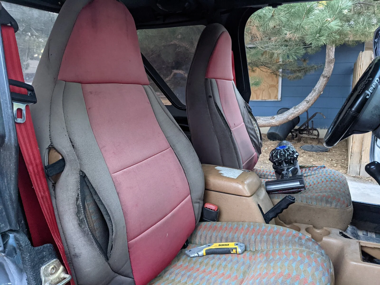

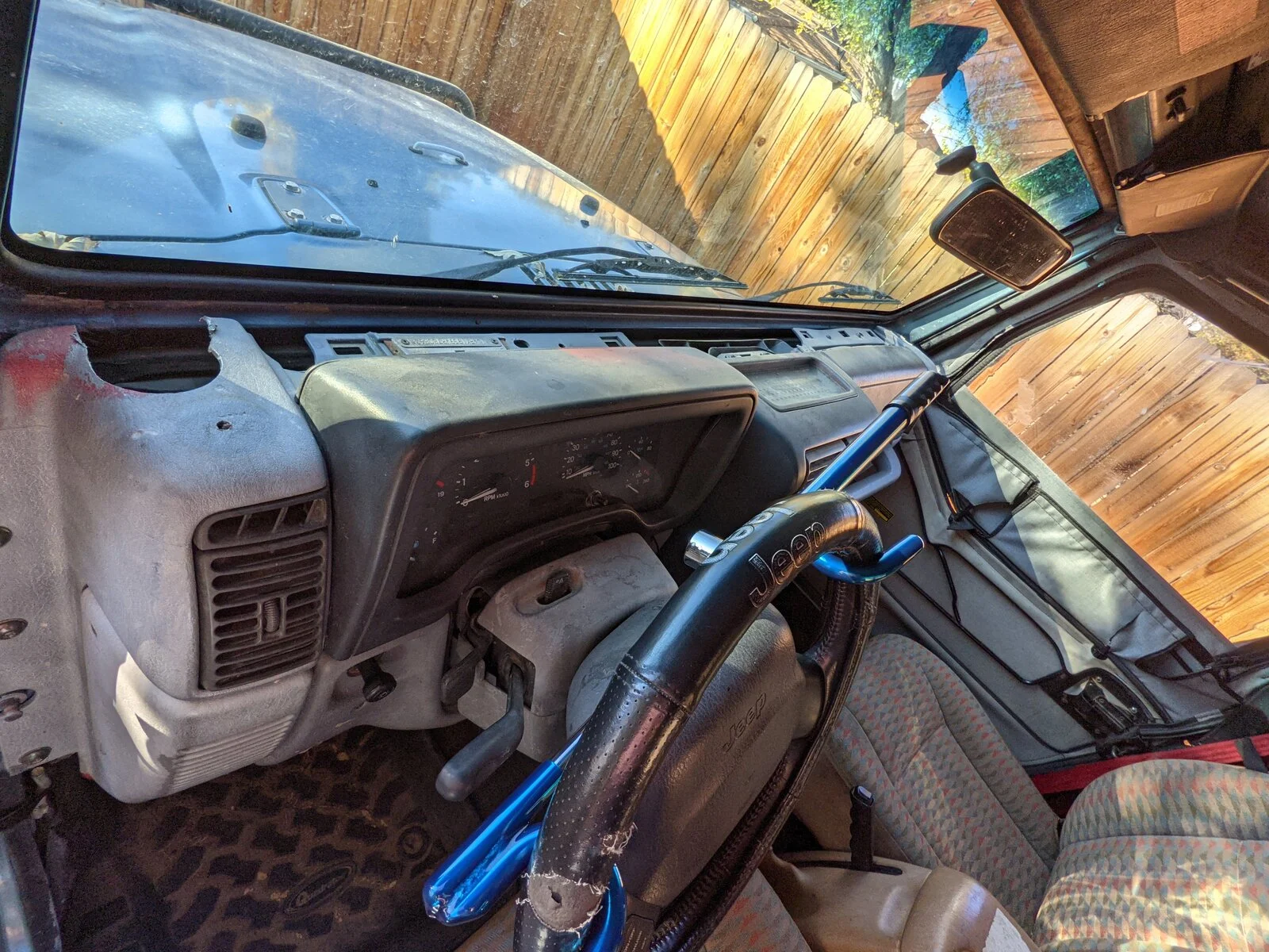

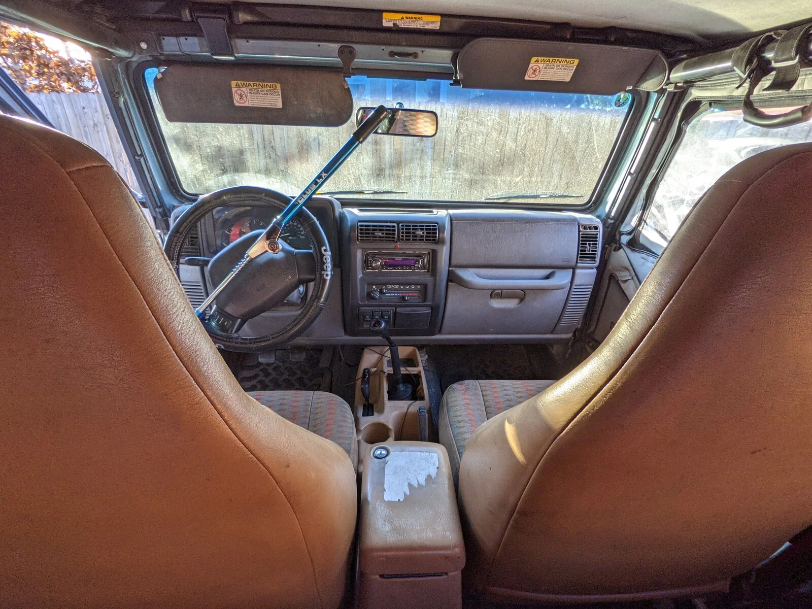

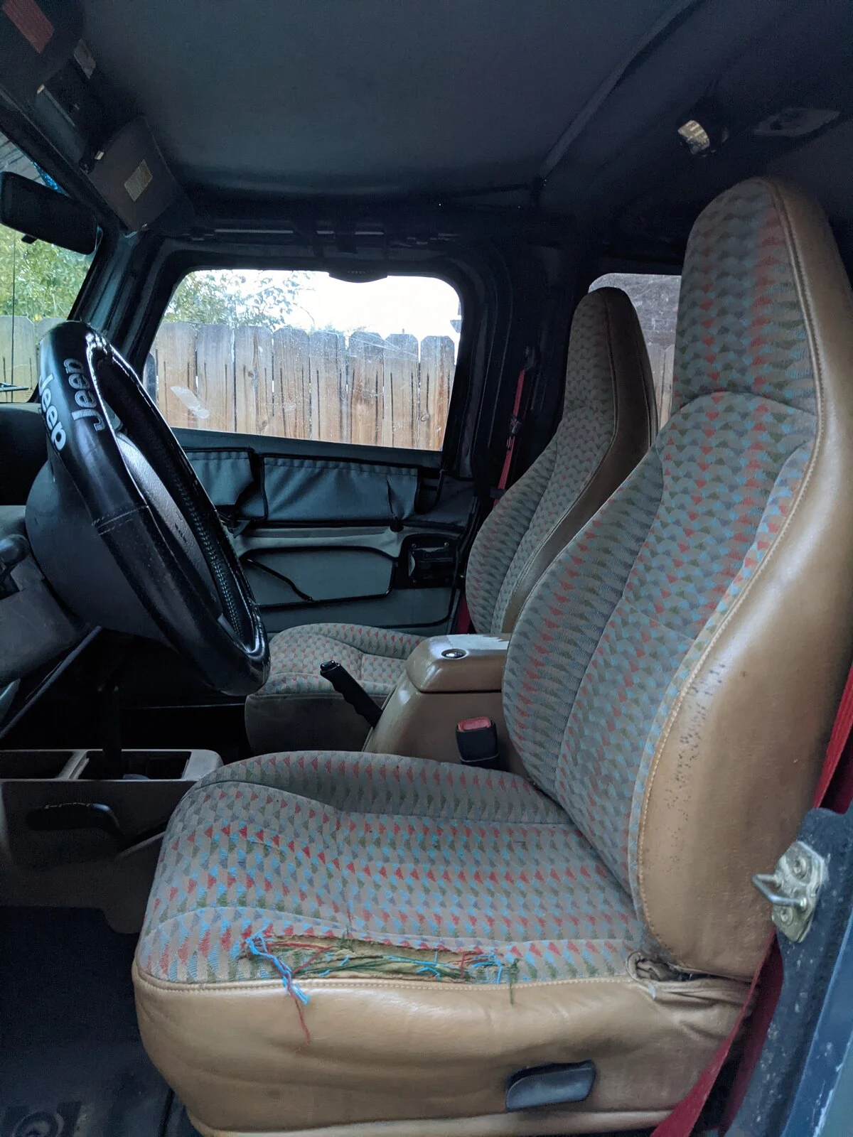

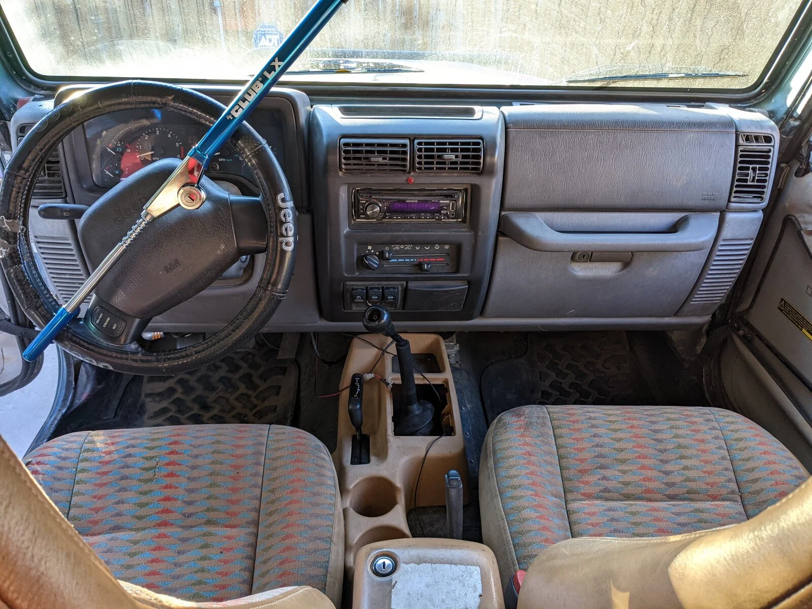

On to the pics, this is the interior before. It was really sun faded. The dash was mismatched to the center console. I thought about taking it out to paint but it was missing the top trim piece and the owner had cut holes out to put pine cones and rocks for display. There was no shift boot and the old knob had definitely seen better days. Also of note the right side of the steering wheel was missing the proper cruise controls. What the heck??

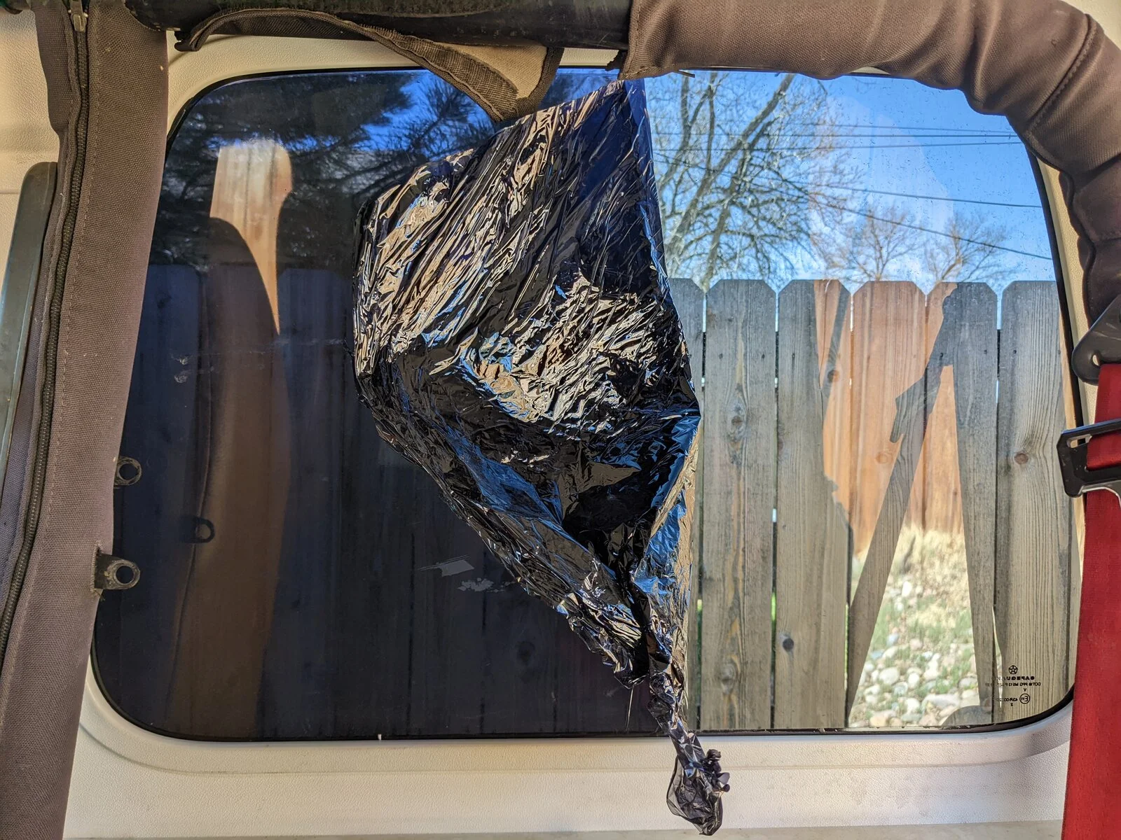

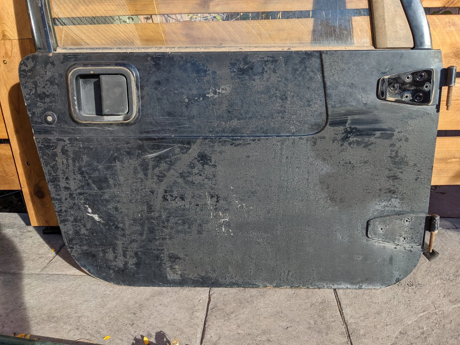

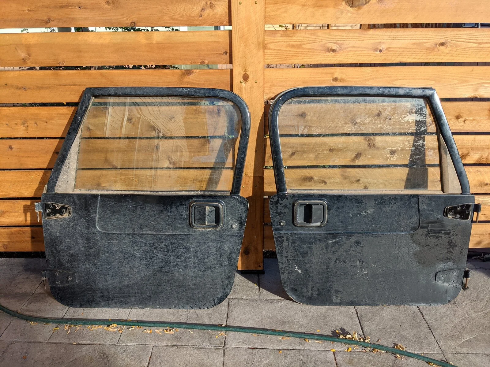

I bought some full doors in pretty rough shape for quite a deal. They had these nasty old purple tints on them I removed. One of the doors had this failed rugged spray paint texture kind of job on it that took forever to clean off (last pic on this series). I cleaned them up pretty well inside and out, put a layer of dynamat inside, re-keyed them, found some door cards, all handles and pulls, and then got a set of mirrors for them!

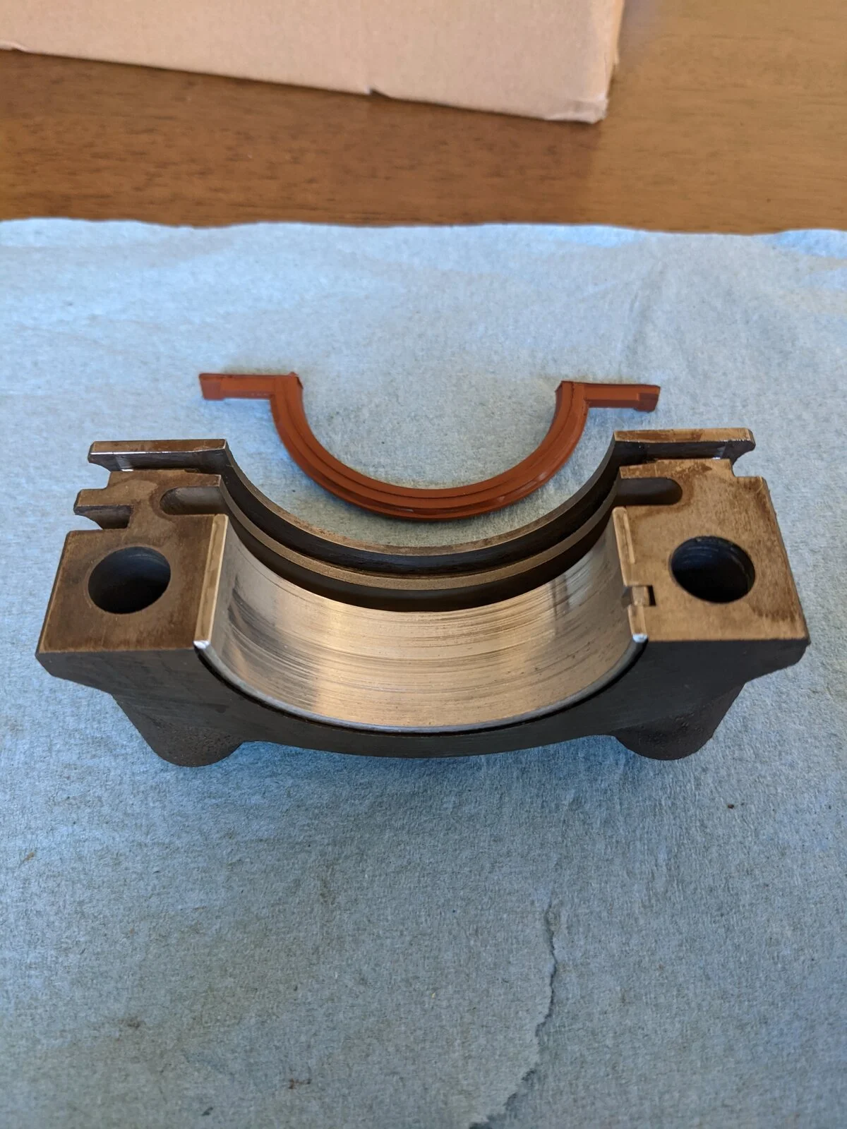

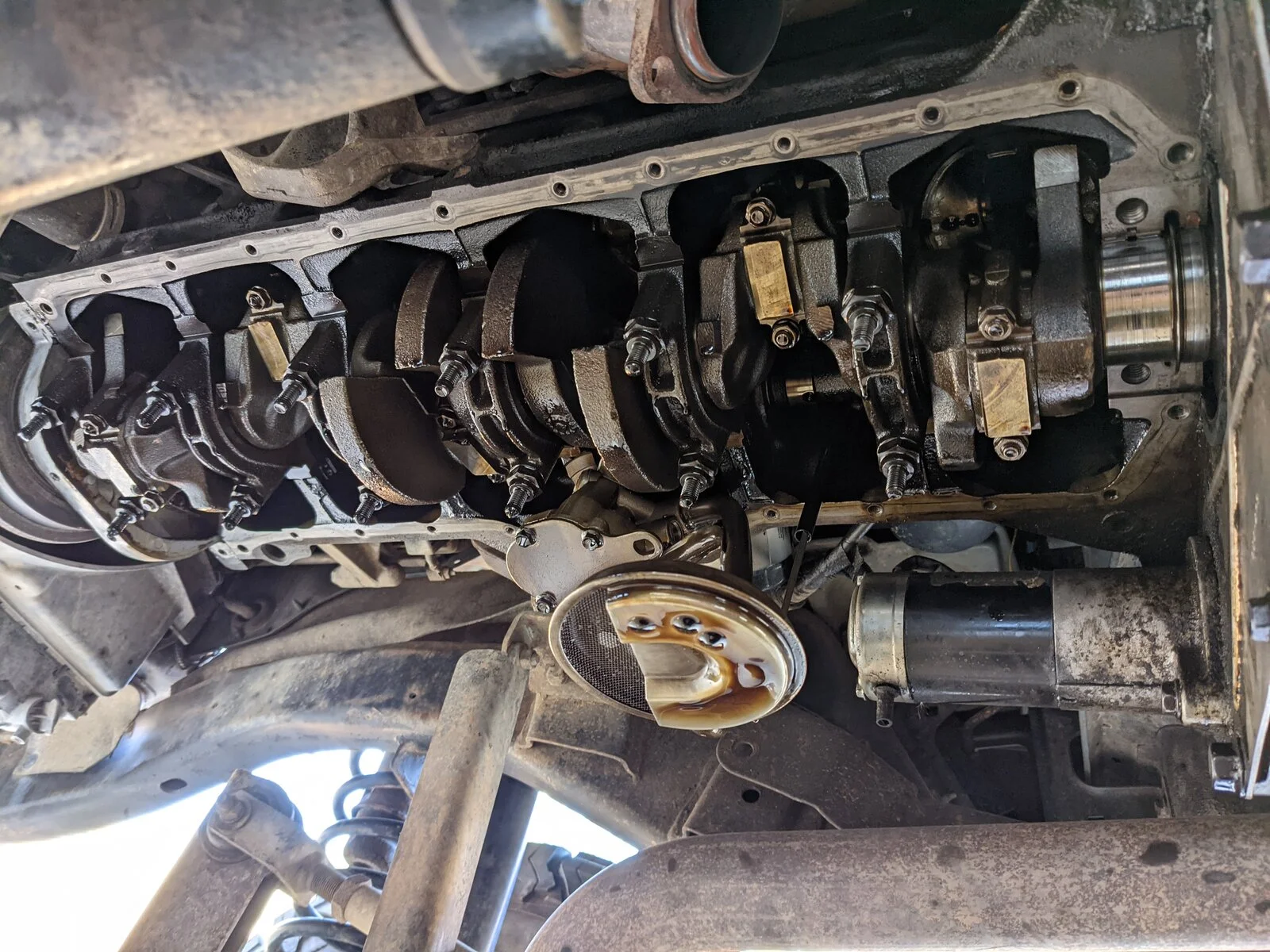

Random pics from replacing the RMS. Pretty proud of myself, this was the most difficult project I've done so far on the TJ. The top half of the RMS was impossible to get out and wouldn't even budge, I had to drop the crank a bit to get enough wiggle room to get it out. Shout out to this forum for that pro tip or I would have been screwed. Sidebar getting oil in your hair is not fun.

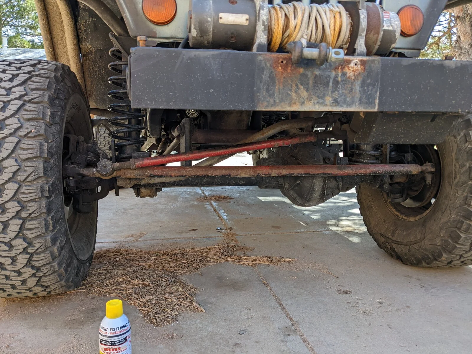

I wasn't sure what steering system was on there and neither was the PO. I was considering just replacing the joints (to try and fix loose steering) but I opted to get a Currie steering system instead. I also purchased a rancho steering stabilizer but the bracket is a damaged inward and I can't get the stabilizer end in yet. Will work on banging it out and getting the stabilizer in. I performed a quick alignment but will take it to a shop to see how I did.

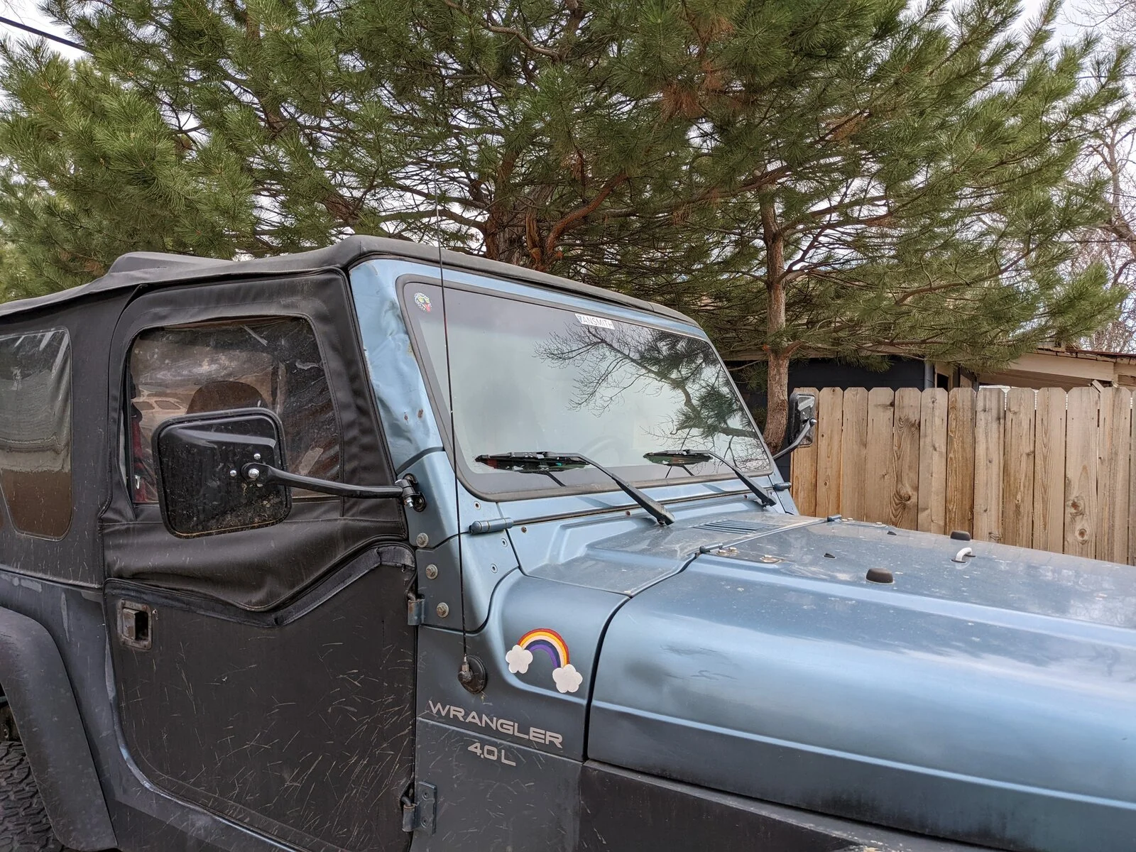

Here's the windshield frame damage from PO. It's kind of hard to see from this angle but in the middle it's bent inward quite a bit. On my test fit for the full doors they wouldn't close because of the damage.

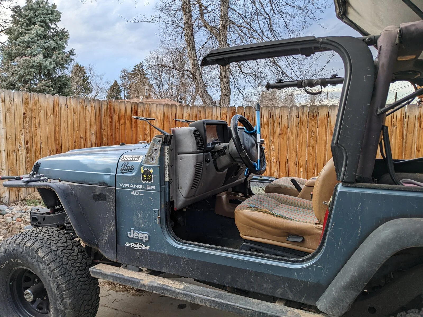

Some fun pictures of disassembly. I took the opportunity to drive around without windshield, doors, or top. Pretty wild experience haha. When replacing the steering wheel apparently there was no clock spring. Oh man.. I never thought I would get so much joy out of turn signals finally returning when you turn the wheel back hahaha. I took the opportunity to throw a little dynamat behind the dash as well.
The hardtop also came with some janky tints like the doors. Although this was 2 layers of janky tints and varying levels of scratches between them. I removed all the tints and left the stock privacy screen which I think looks really good.

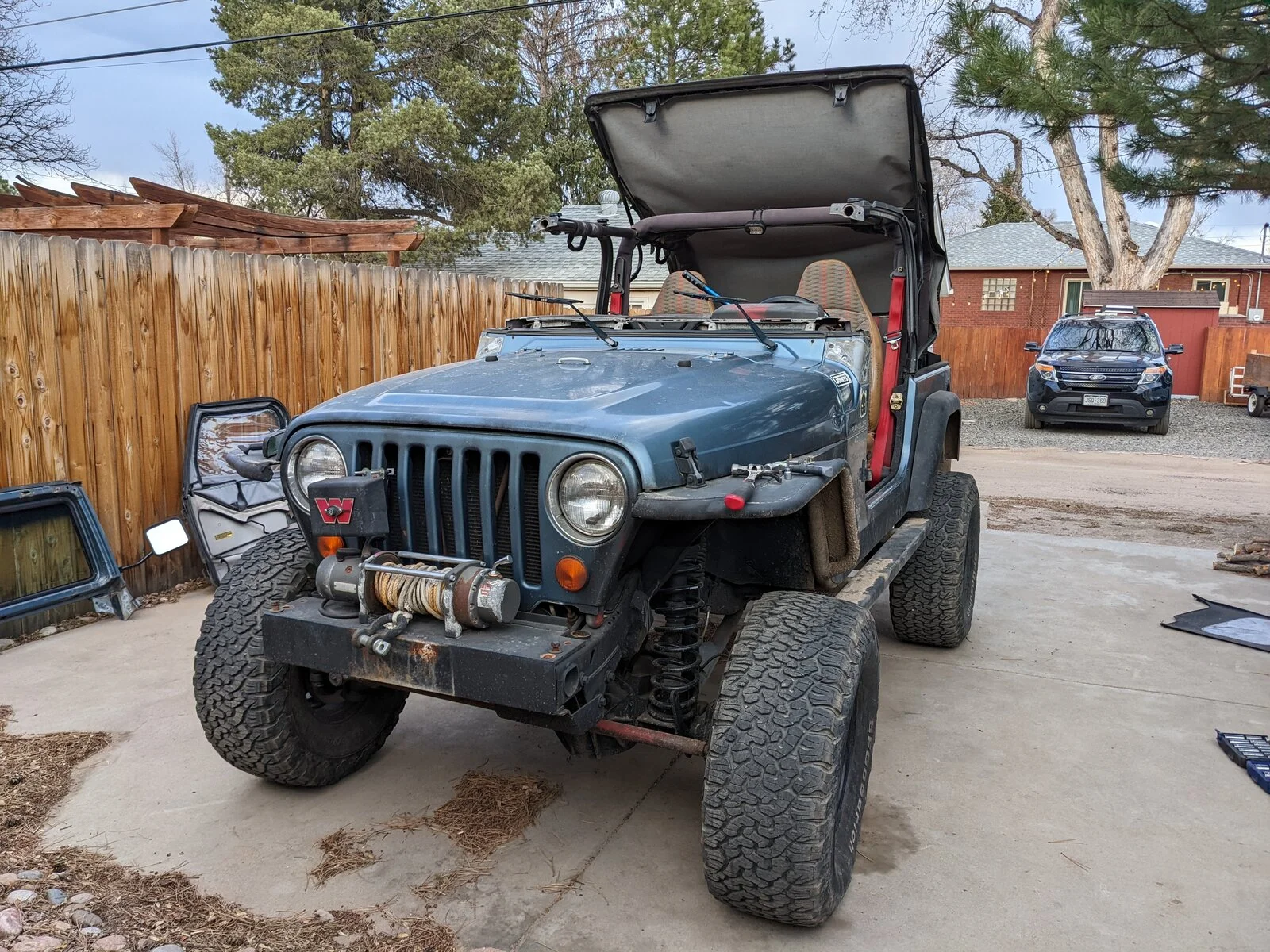

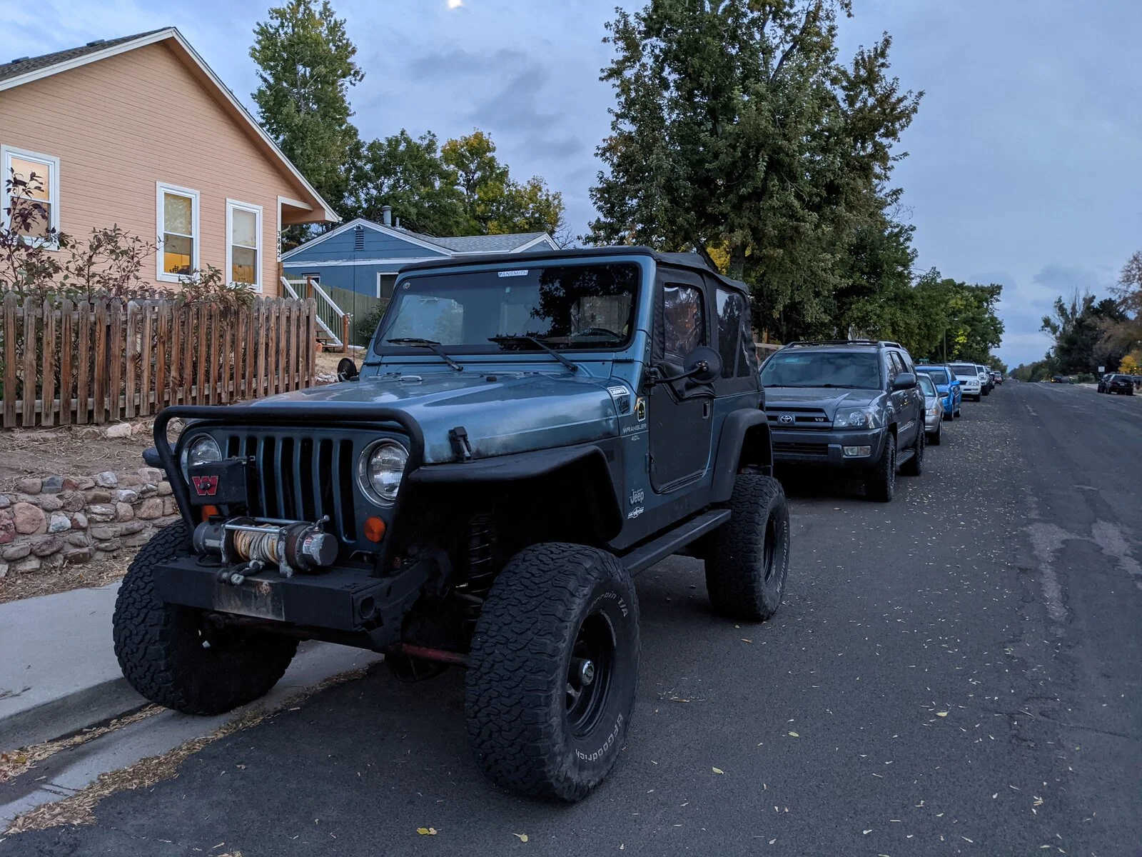

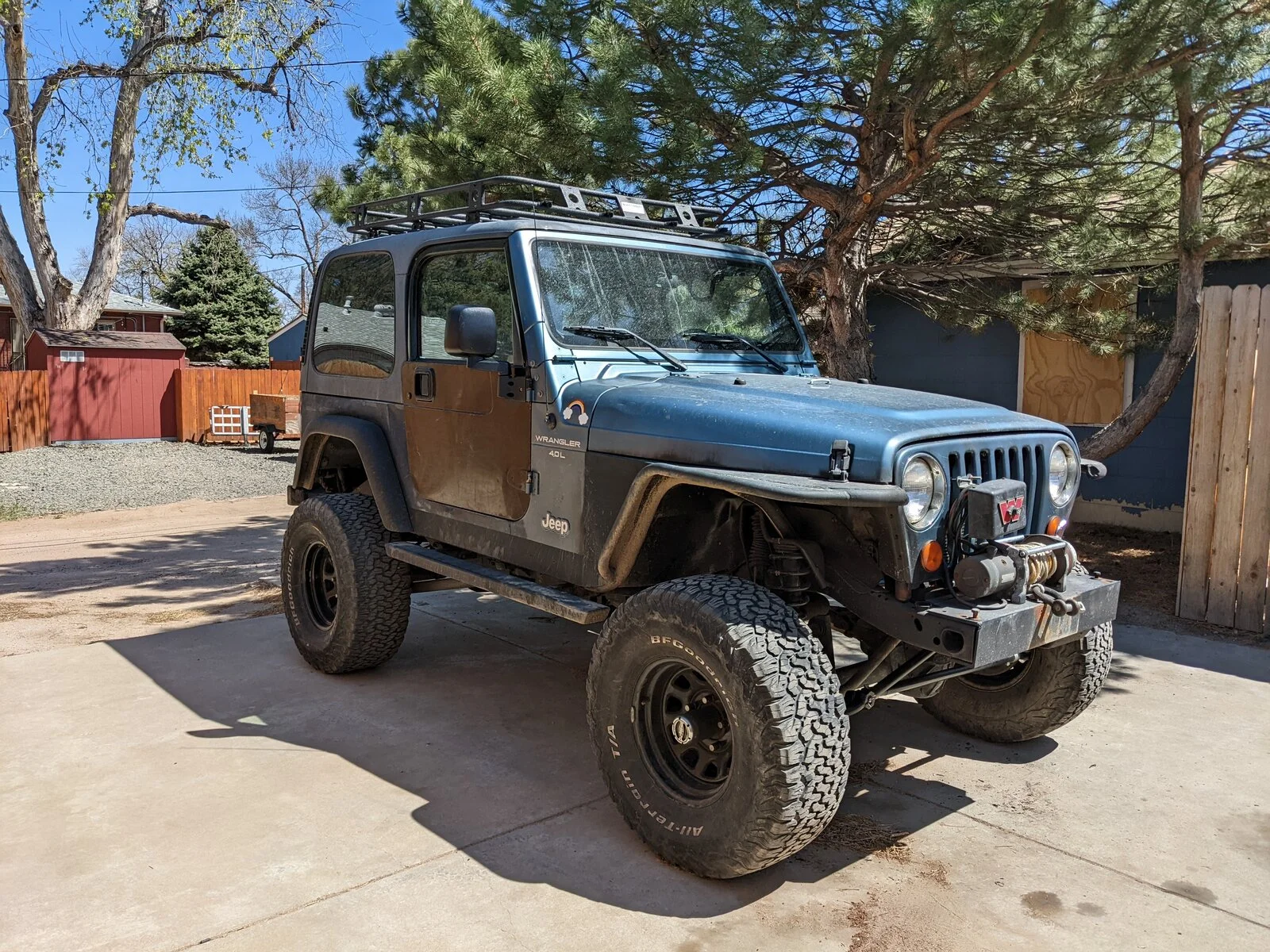

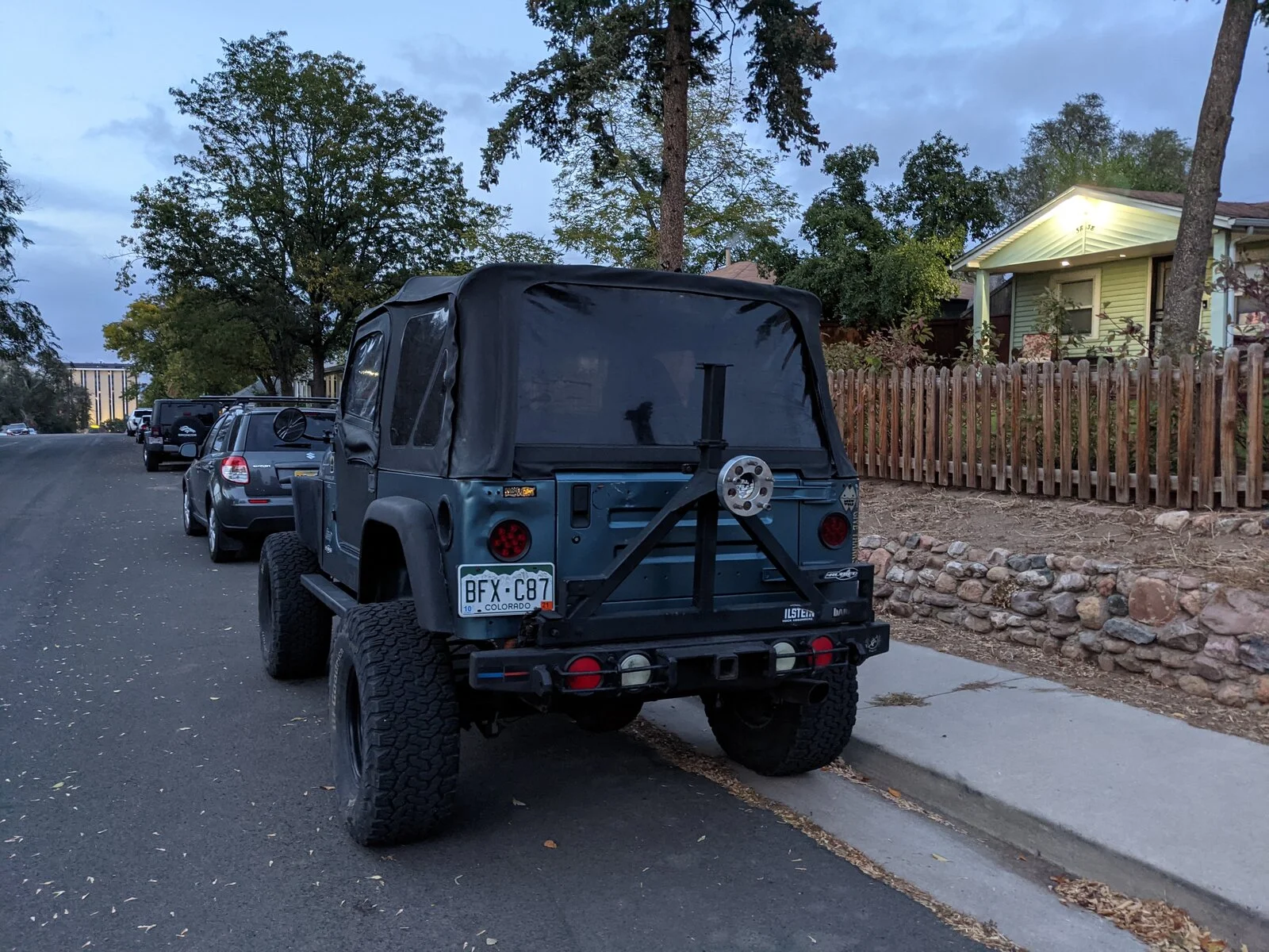

Alright! Finally! This is how the TJ sits now!
I'm beginning to realize this is going to be one super long project and it may never truly be done. The next few things I'm trying to address are the long arms (all the bushings are shot), replacing the shocks (ranchos most likely), and rebuilding the winch + getting a new rope for it.
