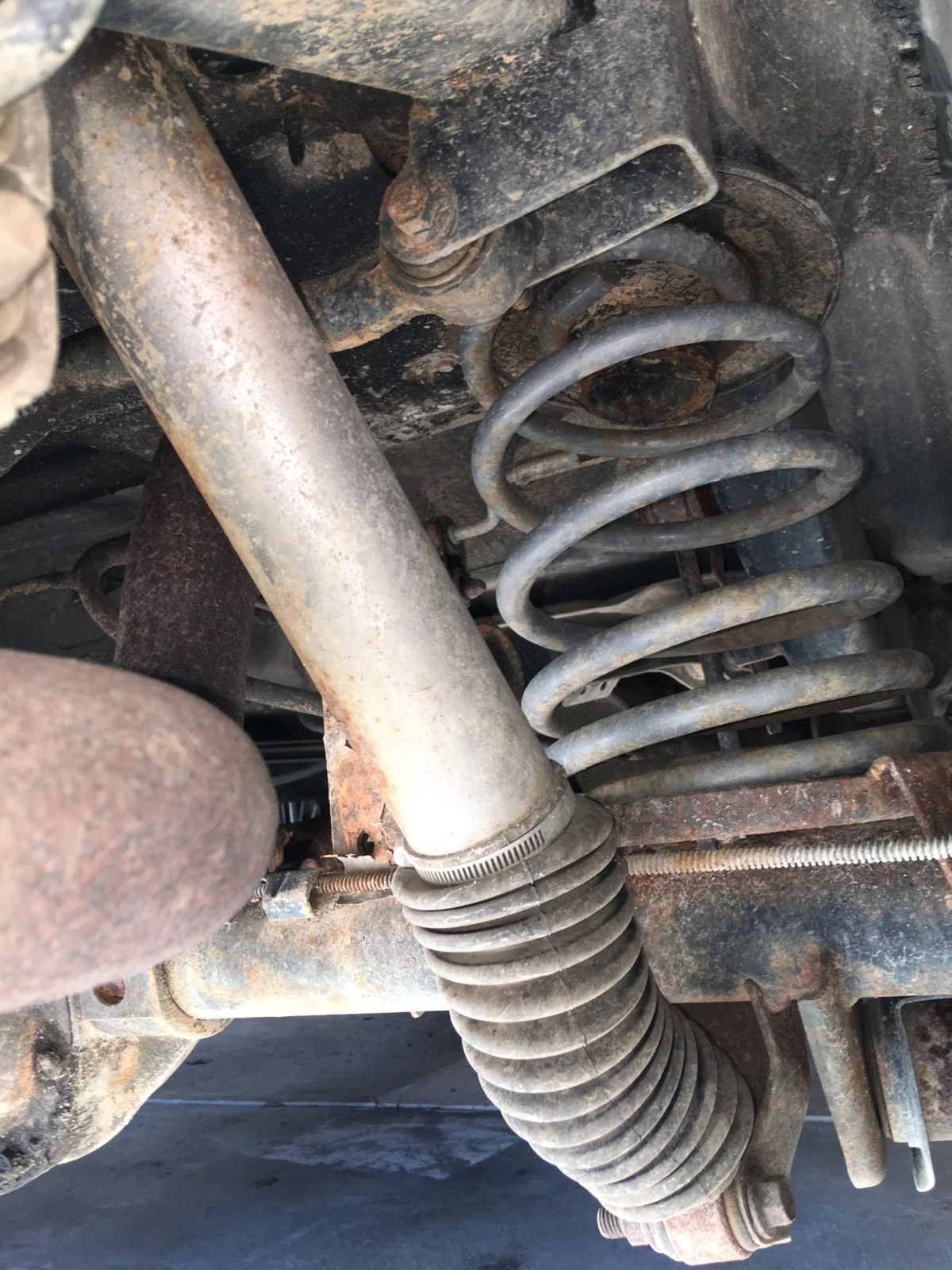

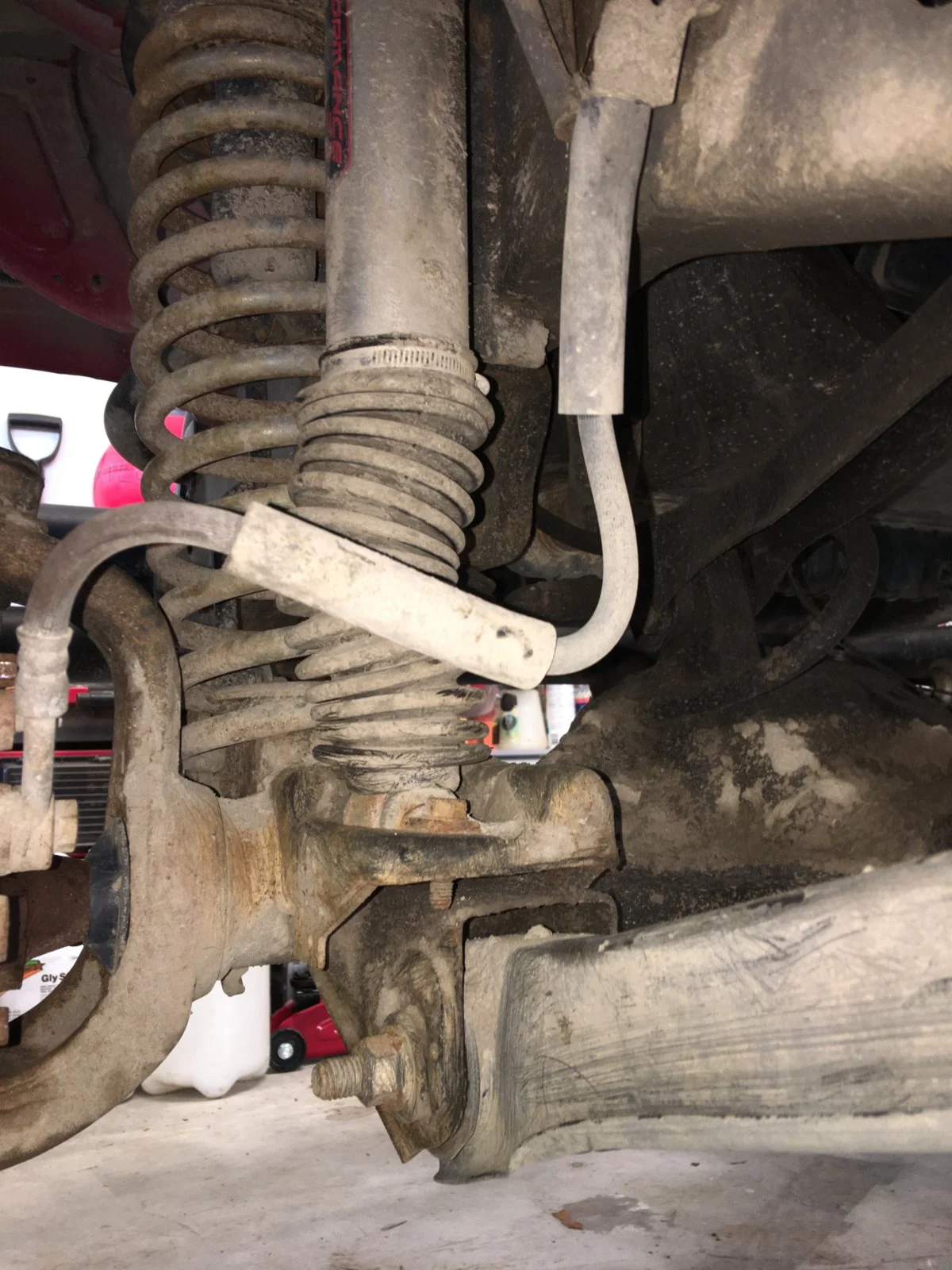

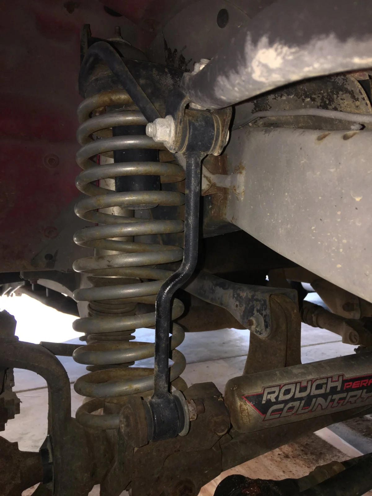

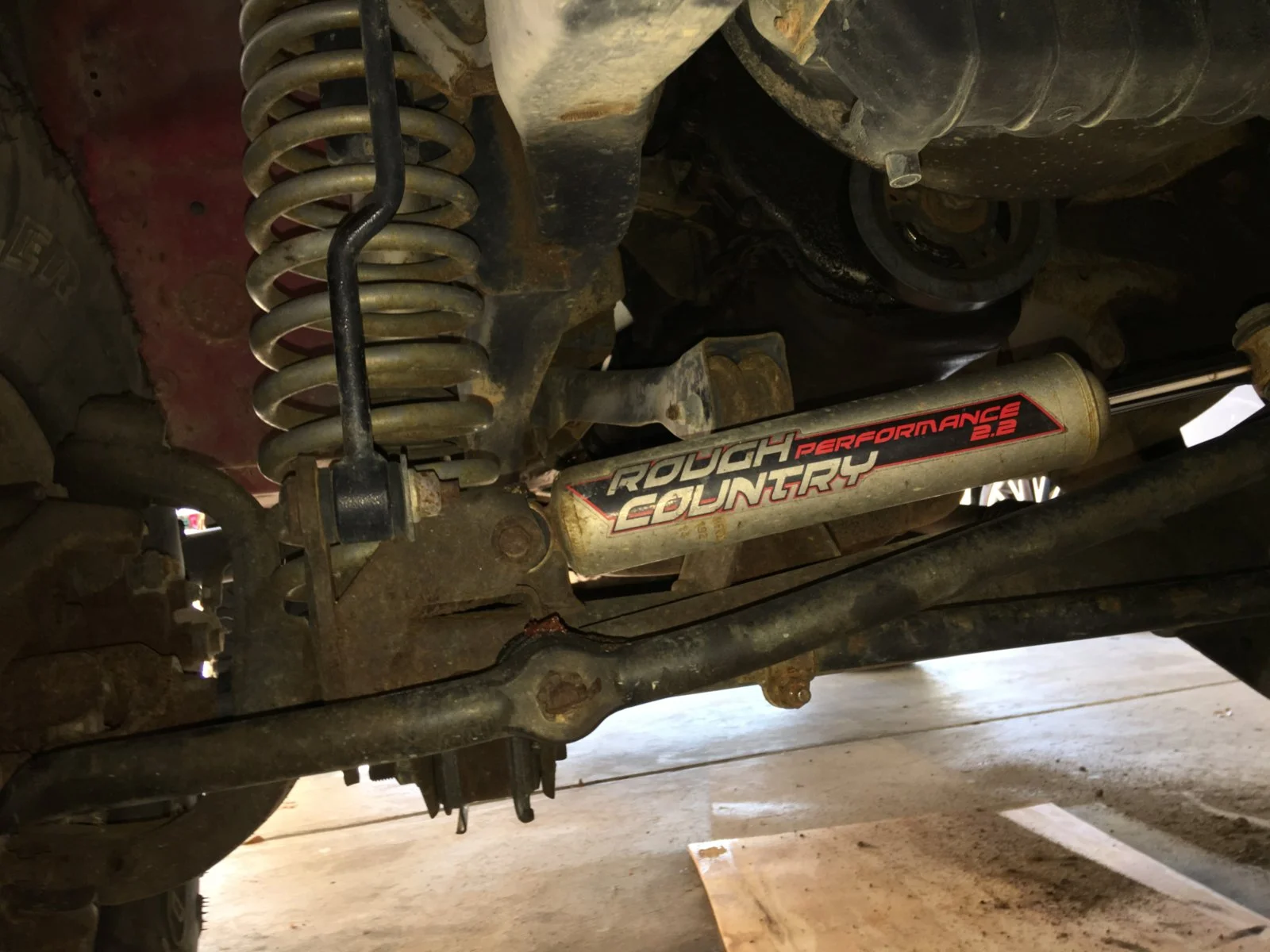

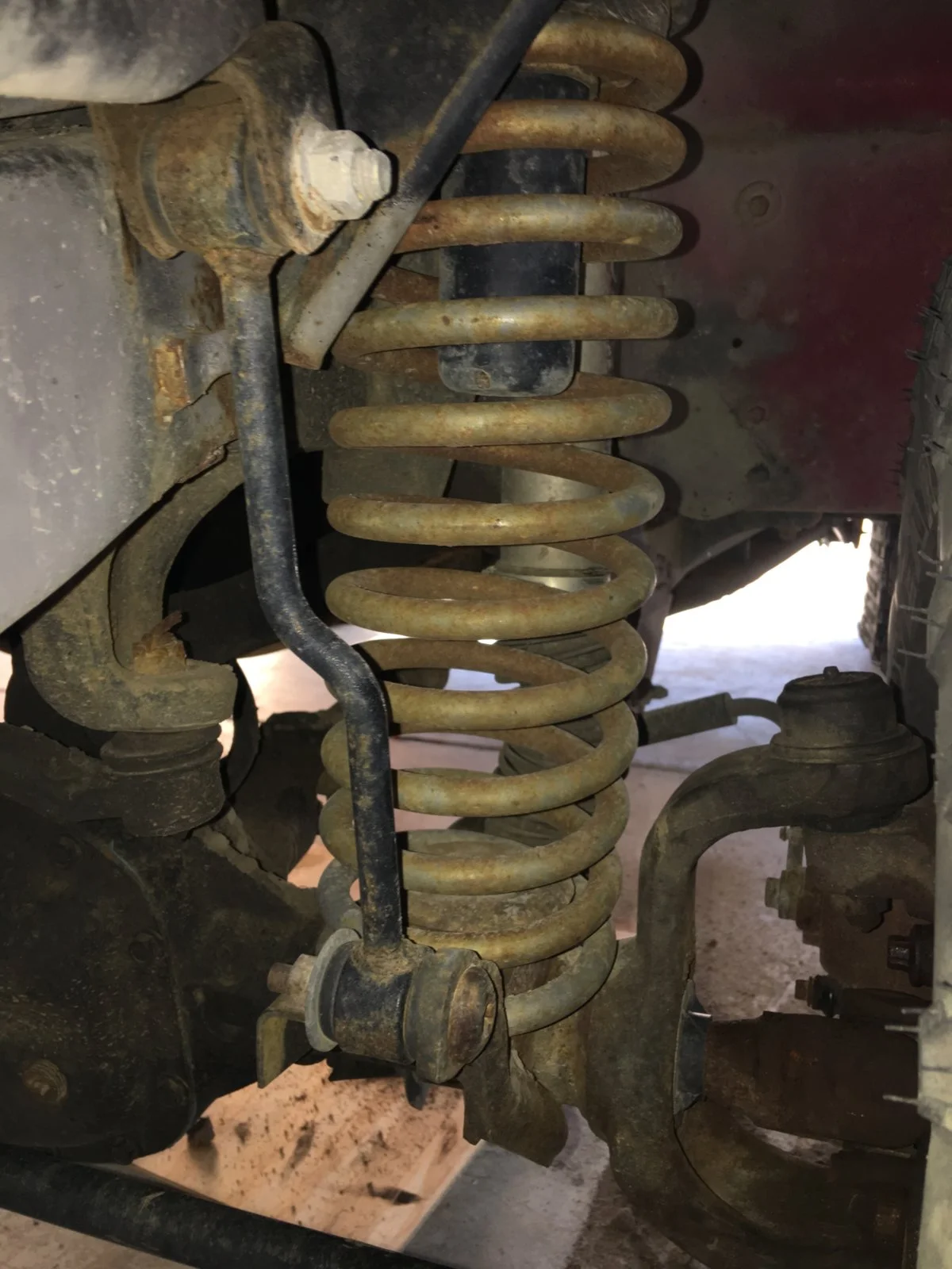

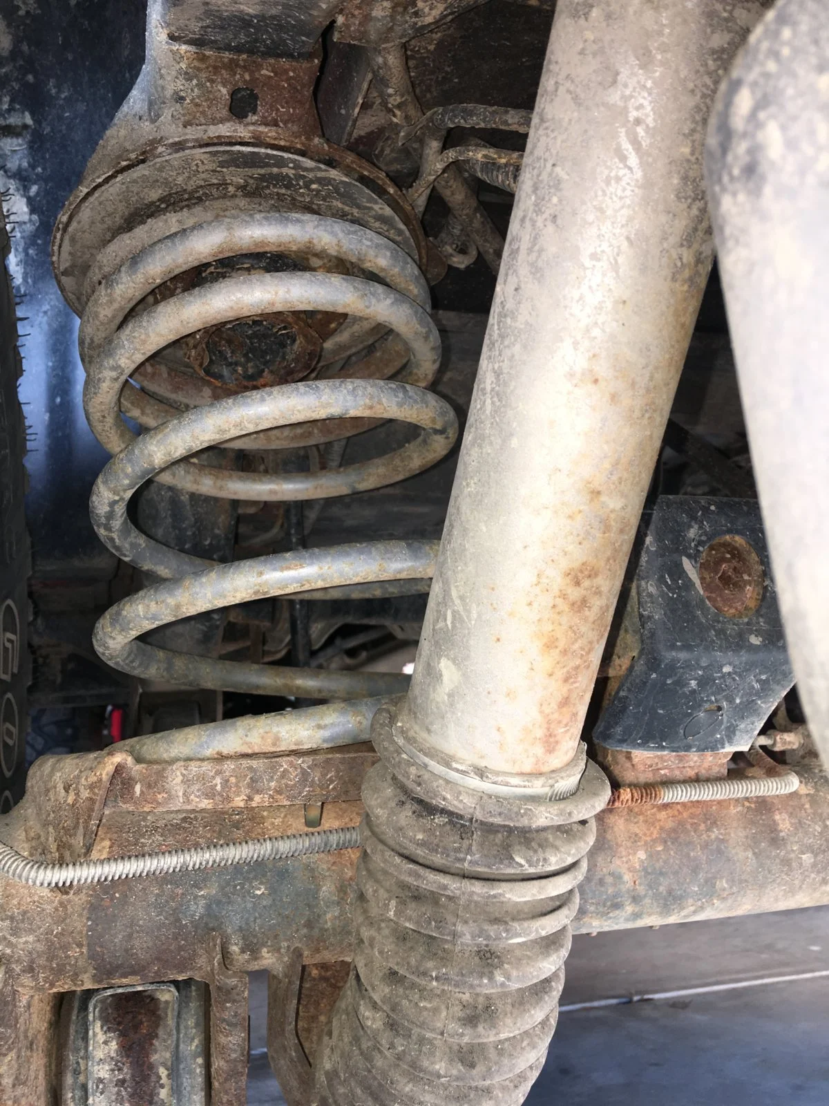

Rear suspension is next focus. Here are some pictures of what I have going on. Not even sure of everything I am looking at, but trying to learn. Thanks in advance for all the help. And, my apologies for all the aggravation I will probably create.
Welcome to the forum! First off, I might suggest you check out this thread, I'm sure your wife will love you for it: How can I fix a harsh ride on my Jeep Wrangler TJ?
Anyways, that looks like the Rough Country 2.5" lift kit.
The Rough Country shocks are shit... literally shit. You'd get a better ride from a pogo stick. If you check out that thread I linked to above, you'll see the recommendation for which shocks ride really, really good, as well as a number of other things you can do to make your Wrangler go from riding like a tank, to riding like a Cadillac (or as close to one as you'll get in a Wrangler at least).
If that was my Jeep with 103k miles and no maintenance history of when things were last replaced, I would start doing preventative maintenance just because everything is overdue to be changed anyways. Regardless of condition, I would replace the ball joints, tie rod ends, shocks (with a better shock like Rancho RS5000X shocks), bushings, etc.
All of that stuff is cheap to do and pretty easy to replace. You'll then know when the last time it was all done was, and you'll give that thing a new lease on life.
The Rough Country springs are fine, it's the shocks that are widely well known as being garbage (even right out of the box).
It looks like you are also missing the top bump stop cups and bumpers. As you read through you will learn bump stops are key. Also, welcome everyone on here is great and offer great advice.

Most cheapo shocks are not designed to run "upside down" as yours are presently mounted and they may not be working at all. I can't say for sure if the Rough Country can run inverted but most can't due to valve design. Toss em and spring for Rancho RS5000X's, best shock out there for TJ's, and mount them with the rod up, not down, like yours are.

I can tell from your picture the rear shocks were replaced with the front...the factory shocks were black, and had plastic covers over the shafts.
