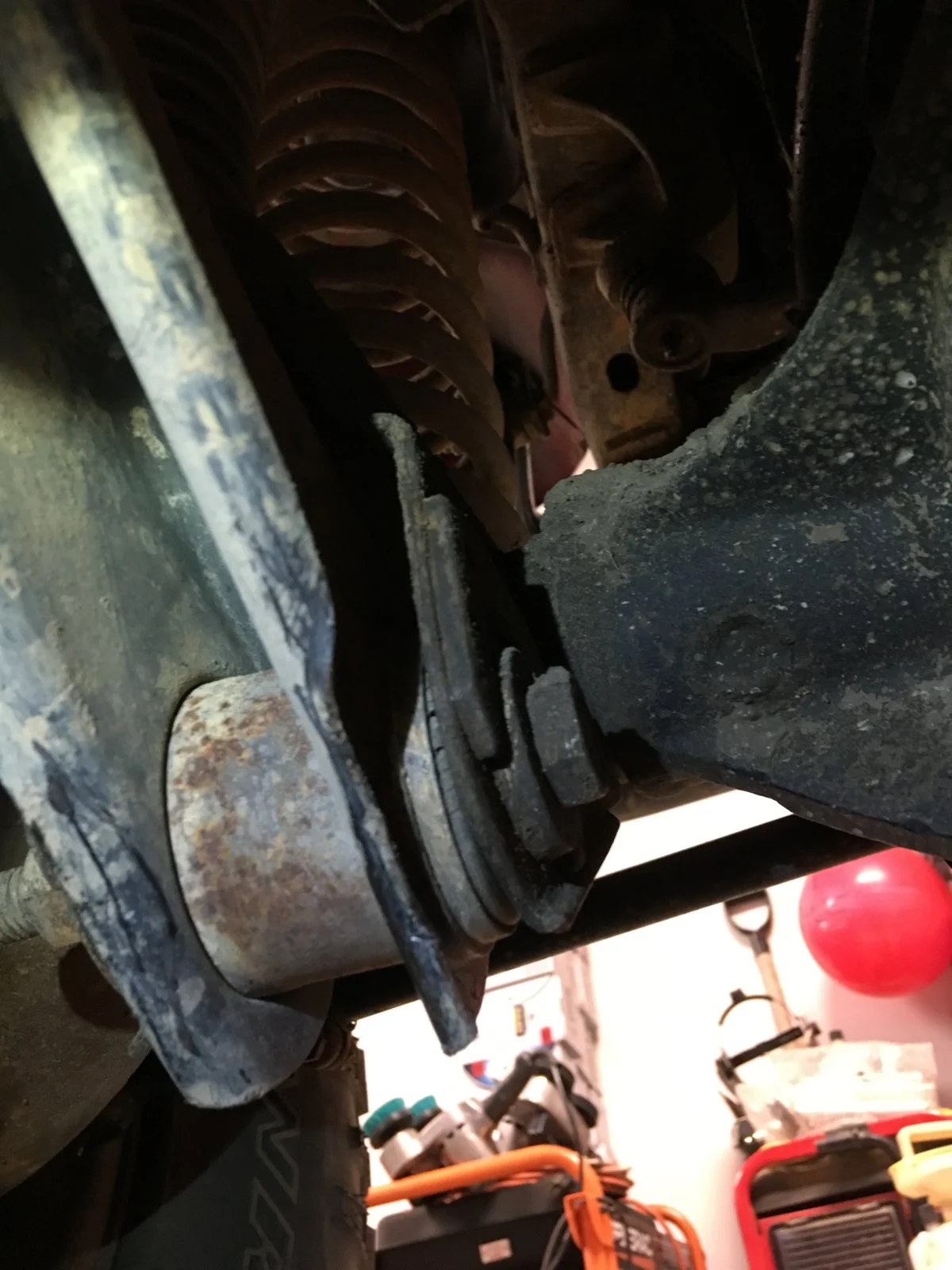

This is a picture I took of one of the control arm bushings. I can see the cracks in the bushings when I zoom in. This is about the same condition as all of the bushings I see when working my way around and checking out the control arms. Are these small cracks indicative of problems that require replacement of the control arms?
Yeah, those control arm bushing are no bueno.
